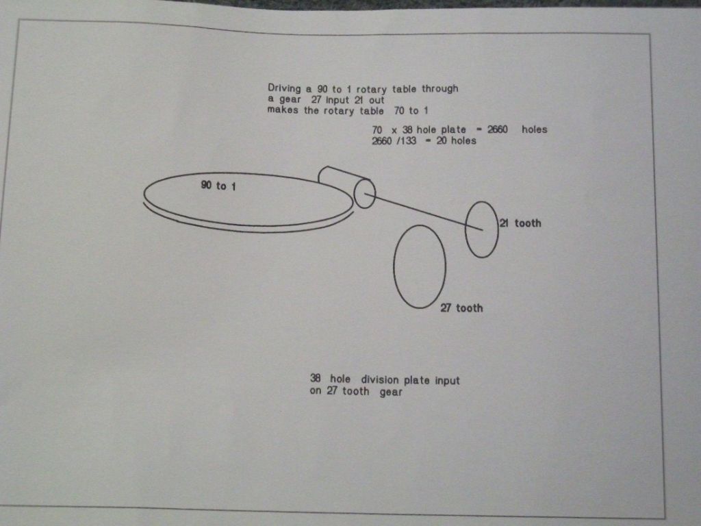

      Bazyle provided the solution to this in identifying this
      "The way you use this is to look for a plate that is a multiple of
      either 7 or 19. The obvious one is 38."
      Moving on with this if the rotary table was 70 to 1 ratio this would simplify
      the problem ,like all things it involves some effort in making the parts
      necessary to do this.
      Gearing the input to the 90 to 1 rotary table at the ratio of 27 to 21 will
      make the table as 70 to 1 using a 38 hole plate will give
      70 x 38 = 2660 holes for one complete revolution of the table,
      divide 2660 by 133 = 20 holes ,moving 20 holes on the 38 hole plate
      will give the required count.

          The table below shows some rational approximations with the error after 133 turns in the last column. The best one is 67/99 as given above, with only .04 degrees. 23/34 is easier to count but gives .117 degrees cumulative error. Depending on the application either of those may be perfectly accurate enough. Either would be a simple way to make a temporary 133 hole plate, which could then be used to make another more accurate one.
          John's compound method is great though it involves setting up a gear ratio which might not be quick and easy. It works in this case since 133 isn't prime and its factors work out with the available plates (though maybe not gears). It won't work for a true prime but the rational approximation will, either to give a good enough result or a more accurate one using a temporary plate to make a better one.

                      You don't even need a rotary table once you make an index wheel with 7 and 19 holes. Below is an example, you need two index pins, one being adjustable. Drill the first 19 holes based on the first of the 7 holes, now index to the next 7 hole and adjust the moveable index pin for the offset 19 hole. Drill this set of 19 holes and repeat for the next 7 pin till complete. The examples below are 150mm diameter plates, with 2mm holes for the 133 and 3mm holes for the 7 and 19 hole pattern.index wheels 133-7-19.jpg
