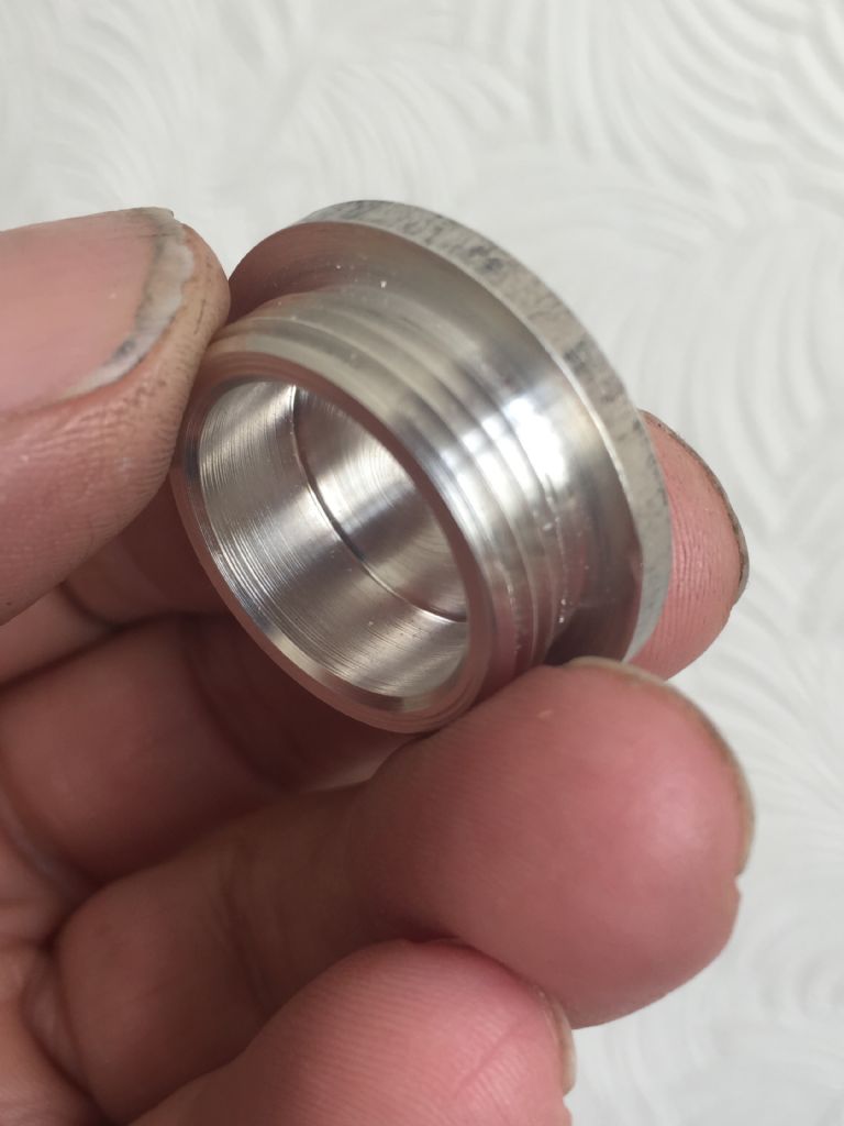

        I recently made the pictured screwed cap on my Super 7 and had some difficulty in getting the thread diameter right.
        I have a DRO fitted to my lathe so I can add on more cut by known increments and to avoid un-chucking the part I initially backed off the saddle enough (with the feed still engaged) to remove the chuck containing the cap in order to try it in it's destined hole but the thread was binding and having the part in the chuck made the handling unwieldy, and after two goes at doing this I thought there must be a better way.
        At the third attempt I just removed the part from the chuck, as the thread was still binding in it's destined hole, and then put the part back in the chuck, hand cranked the saddle towards the chuck until the cutting tool was positioned approximately half way along the thread, but away from and not engaged in the thread, and then adjusted the fit of the cutting tool into the thread using a combination of the slide (positioned in line with the spindle) and the cross slide, and when it fitted withdrew the cutting tool reversed the lathe and then restarted cutting the thread
        I encountered no problem using this technique other than having to ensure that the part runs true on re-chucking and finally achieved a working fit for the thread after two more cycles of removing and re-chucking the cap!

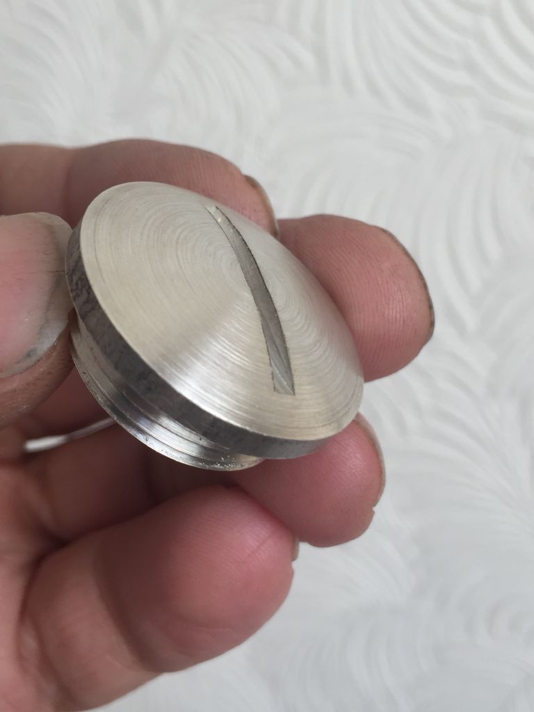

            Nice. M/C inspection cap?

              Well spotted, yes a motorcycle inspection cap, in the pursuit of lightness in magnesium!

                Fitting the cutting tool into the thread in approximately the middle of a length of cut thread is far easier than trying to find the position in which the thread starts and once fitted and then the cutting tool withdrawn the fit is of course saved for the length of the thread after you reverse the lathe, take the backlash up, and then start cutting again.

                        That's quite a short thread, but it looks as though you have 3 fully formed turns, so I would use thread wires to measure the pitch diameter, because that's the crucial dimension for fit. You do need a minimum of 3 threads to be able to position the wires. With care, that method should avoid the need for re-chucking. You should, in any case, be able to get a good indication of the required depth of cut by consulting tables. That might not get you exactly there, but you should get a good indication of depth, so that you can judge when to use the thread wires to work out the final cut(s). Thread wires are a bit fiddly to position, but worth the effort for a thread like this.
                        I guess the thread is too large for you to have a tap so that you can make a female thread to act as a gauge.
                        With that short a right-hand thread, I would turn it from the flange outwards, to minimise the need for a groove at the inner end of the thread. If you use the tool right way up, mounted at the rear of the thread; reverse the rotation, and feed the tool towards the tailstock, life becomes much less stressful. Grind the tool so that the point is close to the chuck end of the tool when it is in its mounted position, and you should be able to start it right up against the flange. Let it cut a vee groove for clearance, before engaging the half-nuts.
                        I like the nice crisp slot.
