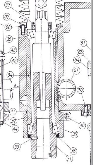

                  Thanks Ketan. It's a tapered roller bearing at top and bottom of the quill, with preload nuts at the top. Yes there's a belt drive but that is to a separate pulley with its own bearing on the top of the machine. The VMB has a long splined shaft driving the milling head running through this pulley, the head slides up and down the column on dovetails. So the belt tension is not taken on the spindle at all. Having fitted the VFD I'm using higher speeds than before, but also doing more cutting of aluminium and generally being more confident of what you can do with cutters, but still within the design spec of the machine. The bearing type is not specified in the instructions but there is a cross section detailed drawing of the quill assembly. There's a good description of the VMB on lathes.co.uk that describes the construction.
                  (Later note.  Lower bearing is a type 30205, upper a 30206.)

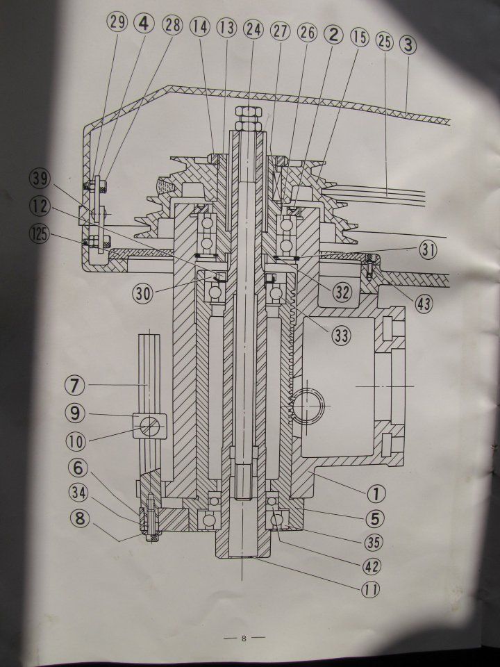

                      From a drawing I have seen on line there are three bearings in the spindle a 6206zz a 6207zz and a thrust bearing 2907 the first two are double metal shielded and greased for life better the thrust bearing is open and needs grease. The adjustment is with a locking ring and tab washer it is a fairly simple jubilee to drop out the spindle after removing the stop and the quill shaft, leaving the pully in place and check and or replace the bearings. Just be very clean and ask if you need any help.

                            If the questionable quill bearing design is as the above, ensure that the thrust bearing is fitted correctly. They have a shaft washer and a housing washer. The shaft washer has a sized bore which fits to the spindle, lower washer, and housing washer which has a sized outside diameter which fits the housing, upper washer. Only tighten the locknut to remove end play, don't over tighten. Grease volumes can be found in SKF literature. The failing with this design is the empty space between the bearings into which the grease from the top bearing can quickly migrate.

                              David, I'm afraid that isn't the VMB spindle. I have the VMB drawing and it just uses two taper roller bearings.

                                    … Could you please supply a diagram, if you have one, John ?
                                    … We currently have only a picture of 'what it is not'.

                                              Here is a C/S of the spindle from the manual. Items 35 and 36 are the bearings. They are unsealed. There is a separate rubber seal (presumably silicone) below the lower bearing to prevent suds etc getting in (not that I use suds). Nuts 37 apply preload. You can see the splined extension at the top that engages with the drive which is at the top of the column. The extension is enclosed in a rubber bellows arrangement as in the pic below.
                                              Many thanks for all the input. On the whole I'm inclined not to worry as (a) the bearings are OK to run much hotter; (b) the temperature seems to stabilise not continue rising; (c) the design of the spindle and head is such that the axial loading will decrease as the spindle gets hotter and expands more than the quill, which is cooled by contact with the head. And maybe the main source of friction could be the seal? So I'll carry on using and keep an eye on the temperature rise (which is easy now I have the IR gadget).

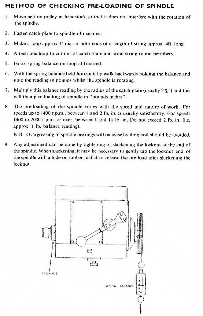

                                                Tell you something John. That arrangement is not that dissimilar to a boxford head stock bearing arrangement and lots of other machine's spindles. The bearings tighten as the bearings warm up and the expansion of the spindle doesn't make up for it. Good job too as the bearings would be more likely to loosen as they warm up if that sort of thing actually went on. The spindle cools pretty rapidly away from the bearings so what must actually be happening is that the inner is expanding with the spindle going with it to a certain extent.
                                                Anyway I mentioned Boxfords way of setting preload.. This is it.
                                                Big catch though. It generally doesn't work. Some of that will be down to wear but the most likely candidate is the one they mention – too much grease. They suggest a smear when new bearings are fitted. Something I have also come across else where. That leaves a problem. Grease needs to be added periodically and no way to get the old stuff out other than pumping way too much out. If a spindle has seals on the bearings even if on just one side this may burst them – happened on my Raglan. So what tends to happen is that eventually bearings finish up packed with a mix of fresh and well oxidised old grease full of contamination and the friction goes way up. Well past the figures Boxford mention.
