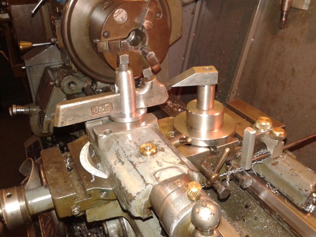

                          Hi Matt,
                          Welcome to the world of ancient lathes.
                          I have a T&LM which came with the lantern post, which I converted to flat mount with a bigger Armstrong type 1" holder.
                          Bazyle's point holds if you mount it like I did. It's simply a lump of angle iron cut slightly higher than the holder and it's best to use a flat plate in the tee slot that fills it completely to protect the cast slot from over tightening.
                          You need to pick a holder size that works for your lathe and pull the HSS out of the holder till it matches your centre height.
                          The chuck key is in a terrible place for a working lathe, this was part of a pic for selling it and put there only to prove there was one present
                          Edited By Dave Halford on 28/04/2020 11:17:29

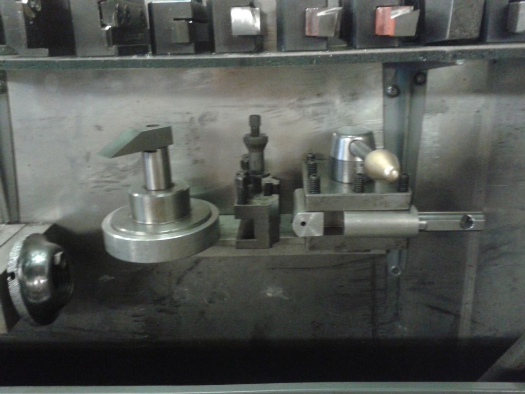

                                          Clive as usual is right on the money.
                                          Howard's comment on an article about a 4 way being as quick to change a tool as a QCTP. Puleeze.
                                          i mean its not a race but how do you beat 5 seconds? If that.
                                          I have a Dickson, and 19 toolholders,and have used Dicksons for 30 odd years, but TBH, all the QCTP these days for home shop use are pretty much of a muchness.
                                          I also made myself a Lantern a couple of years ago, flat washer – no boat, and it has become a usefull little tool, gets in tight spaces and can shift metal.
                                          I also have the original, genuine, ratcheting every 45 degrees 4 way, and is comfortably my least favourite holder, always relegated to last choice and "do i really have to"?
                                          So, plenty of different, healthy opinions, as per usual.
                                          IMHO, i'd get used to your lathe first, buy some HSS, use your lantern WITHOUT the boat, and spend the QCTP money on a decent 6-8" bench grinder.
                                          The choice is yours.
                                          #467908
                                          clogs
                                            @clogs
                                            thaiguzzi…….
                                            rather like ur degree circle…..tool post…..
                                            as I'm getting olde this would make a good add on………
                                            did u make it……?
                                            ta

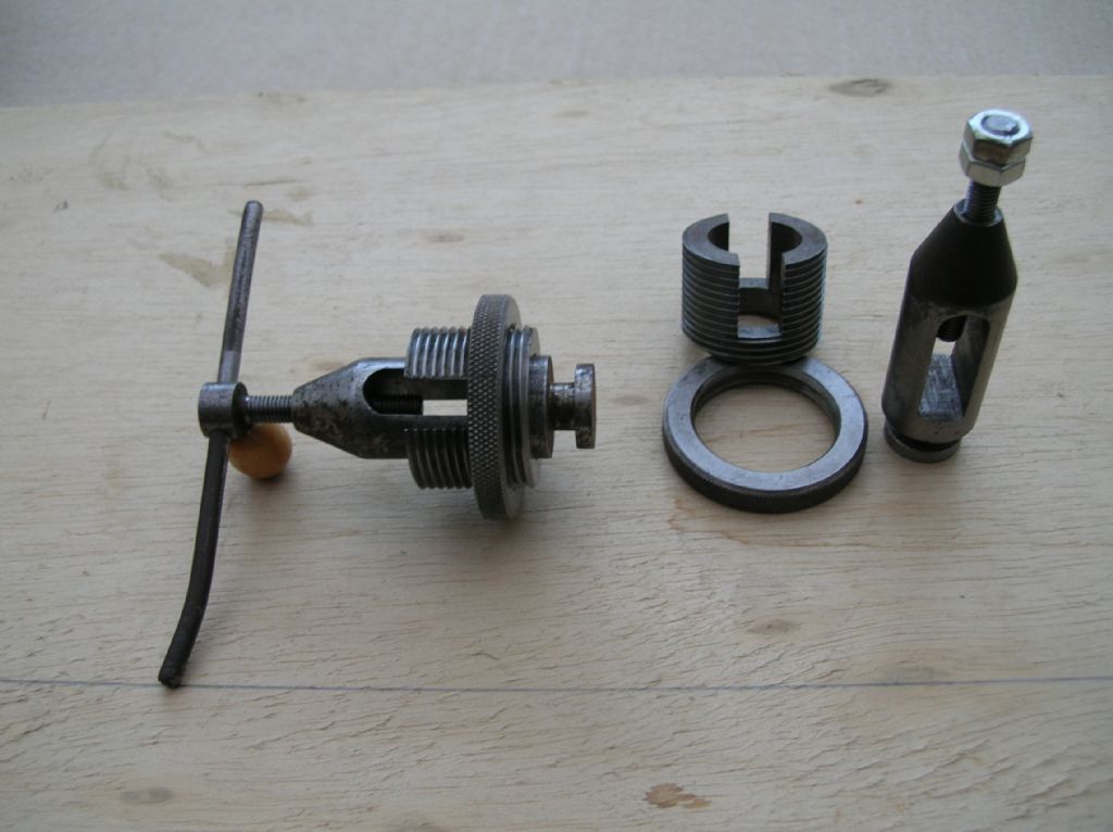

                                                #467925
                                                MK_Chris
                                                  @mk_chris
                                                  Example of Lantern tool post with height adjustment. The thread is the Buttress type at 13 TPI.
                                                  The collar is free to turn but a piece of masking tape or similar with a thin permanent marker line on it can be used for location. Part of recovery project that is slow progress not helped by age and a heart attack. So it still looks rather rough.
                                                  Chris.
