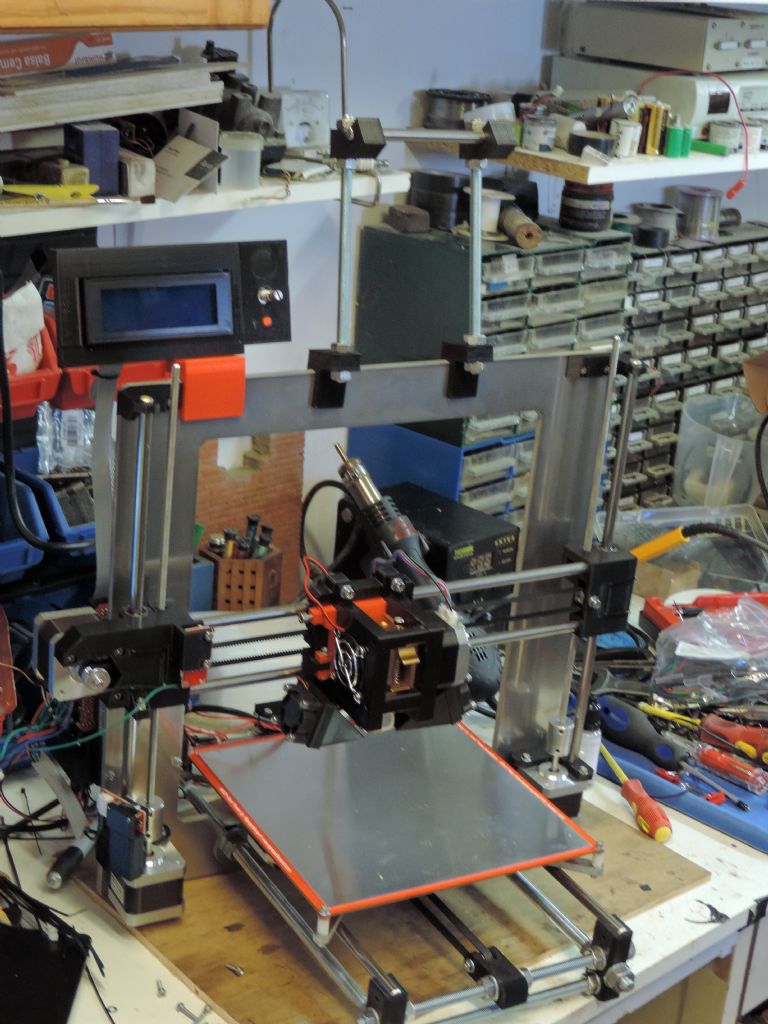

      I've started assembling my Prusa i3 kit.
      So far all going OK, except I had the main frame back to front…

            Assembly takes quite along time… I spent two or three hours on it last night, and I've probably put eight hour in today.
            Some of it was correcting mistakes (mirror image assembly!) and a few things at variance with the instructions. Severally fiddly things were pre-assembled, that the instructions said you would have to do yourself.
            Now I've got to work up the courage to connect it up to 12 volts at 20 amps disgust.

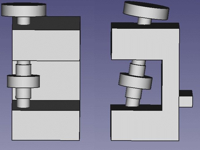

                      Posted by Bob Stevenson on 16/04/2017 12:10:46:
                      Neil,…what are you going to make with it please?
                      ….I took a look at the website….the 'gallery' of made items is massively uninteresting,…just little plastic widgets with no apparent significance or use except in low cost Christmas crackers…..
                      You could make some rough and ready angle blocks, or V blocks or how about a tachometer sensor holder and a push bolt to lock the spindle on an SX2 mill. Small square frame as a one off holder to cut a gear at an angle? Or a T=Rex or some runners for the sliding doors on a steel shed or some hinges for a shower screen or…. Insert endless list.

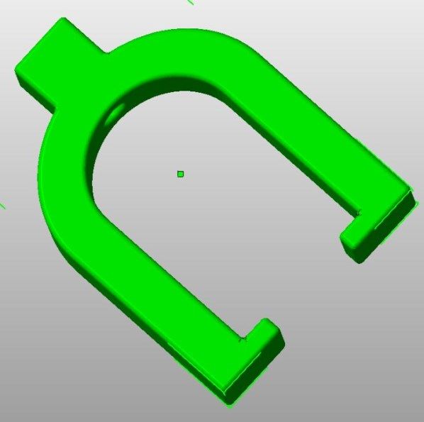

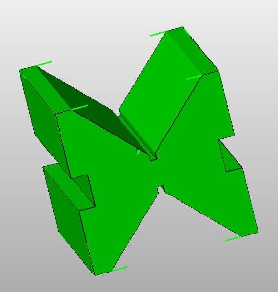

                          A lot of 3D printer users seem tom have an imagination bypass… I'll be printing this sort of thing:

                                    The company that sells the kit I bought, Factory3D, say that they actually use these machines to print the parts they sell. I have to be 100% honest and say they quality is indistinguishable from the prints off the Dremel 3040D. They do stress that it does take careful setting up to get best results.
                                    One thing I noticed was that it's easy to get the Z-axis steppers at a slight angle, loading the flexible joint. They say they are planning to include a simple setting jig in future kits, but ho can do it easily enough with a square.

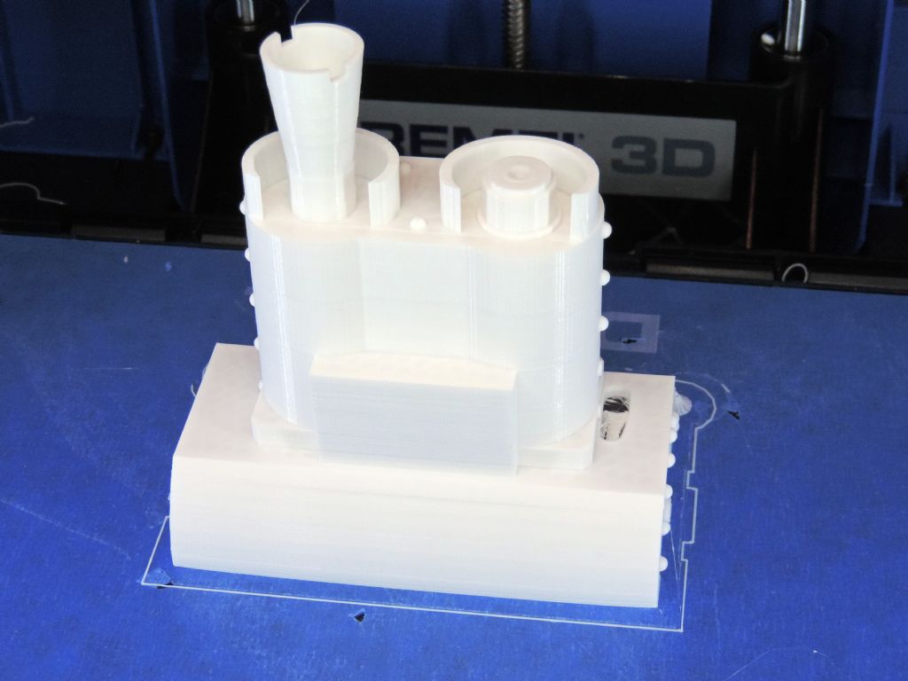

                                              Well I got a pololu today and it works.
                                              I printed a few test pieces including a 'Benchy'. A couple of issues to sort – the lower layers are not cooling fast enough and curling up badly at overhung edges and corners, giving a poor finish. I think I need to use a cooler bed or adjust the fans on the extruder head.
                                              I also had 'stripping' nearly interrupt the benchy when it was printing five small areas at one. I think this is because somehow I had cura retreating the filament much too far – about 1cm! It was thrashing up and down and I think that's why the filament stripped. Also my first few layers don't seem to be printing too well. Where those problems didn't apply, the print quality is very good, if I can sort the curling issue I think I can equal the dremel print quality, but probably Sunday before I can spend some decent time on it.
                                              That said, the 'Benchy' appears dimensionally identical to one printed on the Dremel, so hopefully it will only take a bit of experimenting to get good results.
