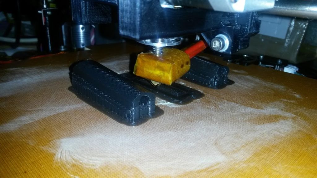

      I have a part that only seemed to work if I printed it one at a time, but that gets old quickly.
      I've just found that the latest version of Cura allows you to enter print head dimensions and gantry height to determine part spacing, avoid crashes and print several parts one at a time, in the same session.
      Nice!

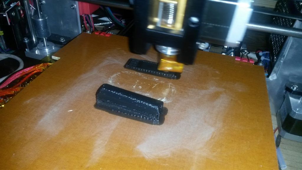

          Photos –
          Whale Tuffnol is for adhesion of Nylon and it really works!

                This is a Nylon part which for temperature gradient reasons doesn't seem to like the conventional multi-part approach, if you have a lot of small parts to print you can save a lot of travel time using a "one at a time" strategy,
