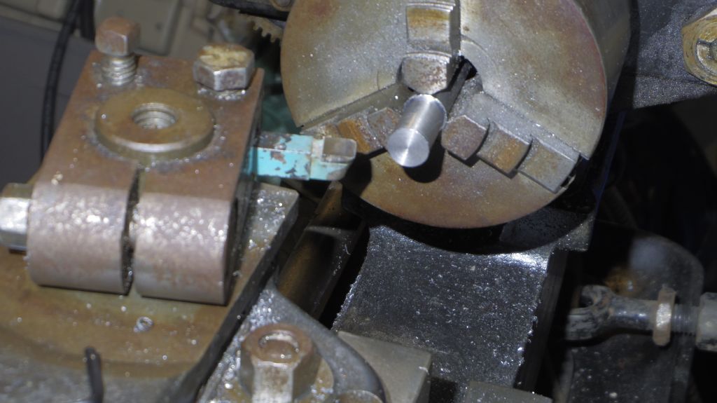

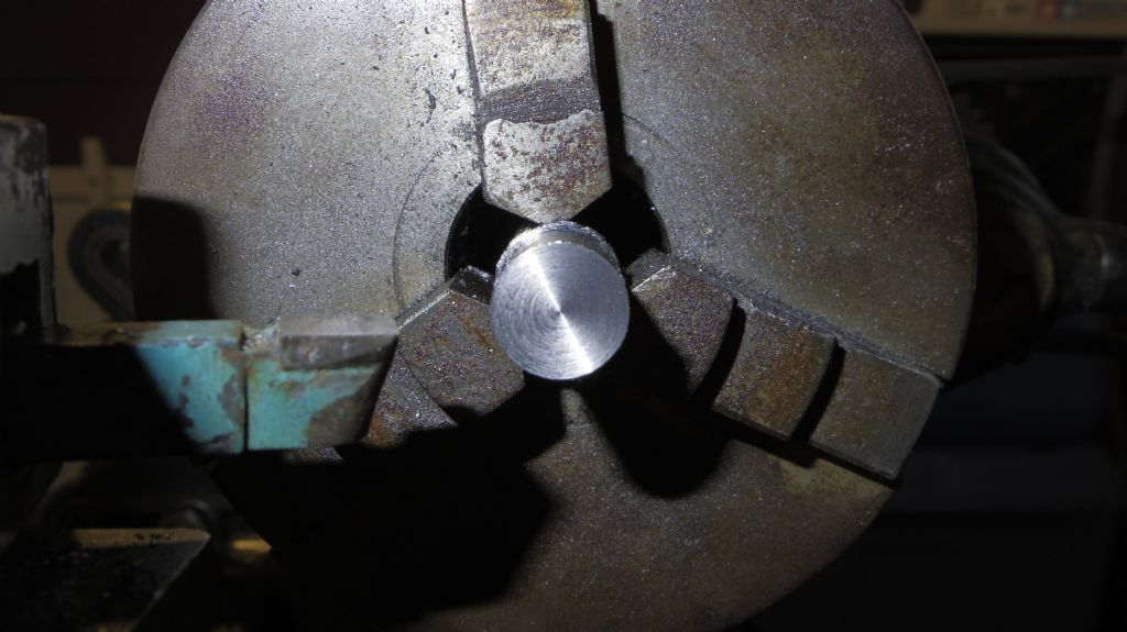

      practice facing 2.jpgI spent a good 4 hours today just going through my HSS tooling that came with my lathe to see what works for facing of, i did manage to get a better finish at the end but I'm wondering if its possible to do better..
      here two pictures of the setup that i found the best and the tool that i used, please any input that would help let me know

              Posted by Barrie Lever on 03/01/2019 23:26:46:
              Adrian
              That looks like a brazed tip carbide tool not HSS, nothing wrong with that though.
              What is the material?
              Unless there is something horribly wrong with the lathe I am fairly sure you will get a better finish than that that.
              Are you in Canada?
              Regards
              Barrie
              Hi Barrie yes I am in Canada and its cold rolled steel so probably not the best metal to use

                Hi Adrian,
                Brazed carbide tipped tools may need to be sharpened to get a good finish, you can use a "green wheel" to grind the cutting edges and then I use a diamond hone. This improved my brazed carbide tipped tools. If you have some HSS tools they can be sharpened with an ordinary wheel on a bench grinder and honed afterwards. As you say, cold rolled steel may not be the best metal to turn, try and get some freecutting steel. When facing you should ideally increase the speed as the tool approaches the centre of the work, so if you have a DC motor or a 3-phase motor with inverter just adjust the speed.
                Thor

                  Hopper
                    @hopper
                    It might help a little bit if you slide the tool back into the toolpost a bit. More overhang = more flex = poorer finish.
                    I've found my old Drummond works best with HSS tooling sharpened to a very sharp edge with a lot of top rake on the tool. Ie, "knife tool". Never had much luck with carbide on the Drummond. Seems to work better on the Myford 7 with stouter headstock bearings and spindle.

                      As Hopper. That tool may be rigid but any excess overhang presents a larger leverage on the rest of the machine.
                      The ideal cutting point would be directly above the centre of the carriage and bed – but not really achievable. As close as possible to the ideal is the best we can do and the further away is “less betterer”smiley
                      The lighter the lathe, the more important these things become. With more-worn lathe parts, little things become even more important….

                        Yes, it looks like you could move the topslide back over the cross slide a little bit more too. And ensure the topslide is retracted to where it's on solid base wherever possible. Every little bit helps on these old machiens. Keep the cutting edge of the tool just ahead of the leading edge of the cross slide so the cross slide does not hit the chuck.

                          Try starting in the centre and work out

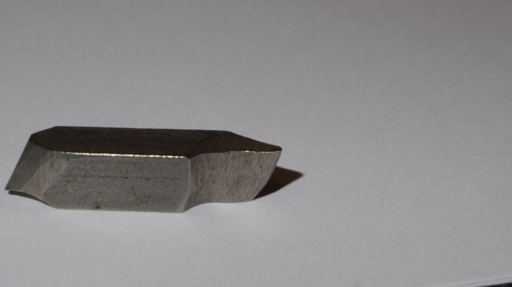

                              would this be classed as a knife edge? I did try a google but did not really find any info
                              so i should keep the top slide over the cross slide as possible and keep the tooling as short as possible..
                              i had read that HSS tooling is best for the speeds of this lathe and i will get a bench grinder fro home as the only one i have access to is at work..

                                    Your tool post system is too soft and cutting edge probably not very sharp.

                                          Adrian – if you look closely at your tool clip you can see a bright line where the edges meet. This is where the light is reflecting off a rounded surface, ie not a sharp edge. Any tool which shows this effect on the business edges could benefit from sharpening.
                                          Cheers, Tim

                                              No, Adrian, the shot of the tool on its own, where the text begins 'would this be classed as a knife edge'
                                              The edges I refer to are really the surfaces of the top face and the ground side you can see. For some of the edge there is no reflected light, but this is behind the cutting end, and shows what a sharp edge should look like.
                                              Hope this helps
                                              Tim

                                                Right I see what you mean.. I have not used this tool yet but I will make sure i sharpen it before i do

                                                  Here is a guide to tool angles. Only the right hand tool is shown.
                                                  https://littlemachineshop.com/reference/rakerelief.php
                                                  The illustration shows what the tip should look like. It will work for turning or facing.
                                                  Other sources for tool geometry may be based on the use of a lantern toolpost. The toolholders for that toolpost have a 15* back rake built into the holder. Any of the assortment of HSS bits in your collection without back rake ground into the tool were likely designed for use in a holder for the lantern toolpost. Their geometry will be wrong if the bit is held horizontal. Sort them out and regrind them to work with your tool post.
