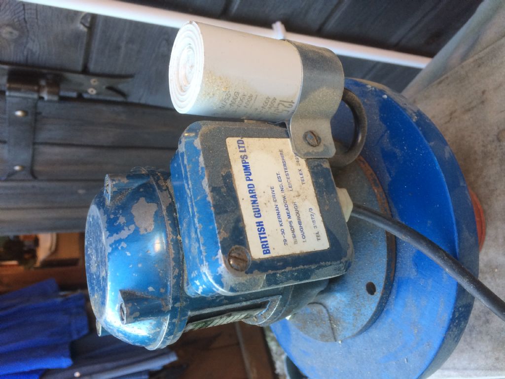

      I have a Myford tank and suds pump. The pump was made by MG Electrical of Colchester.
      At the moment it is connected for 3 phase 440 Volts, Star. The motor can be easily be rewired for Delta and 240 Volt 3 phase. It will take 0.22 Amp in Delta.
      It is hardly worth using a VFD for this application. I know that other folk have connected up the motor using a single phase supply (live and neutral) and a capacitor feeding the 3rd phase. I can play about with the capacitor size, but that mean buying in a selection! I have a 440 volt rated 6 microfarad capacitor which will probably work.
      If anyone has done a similar conversion, then what size capacitor did you use? There is probably a way of calculating the required size, but I am too lazy to start that , if someone has a working value!

        #600866
        Speedy Builder5
          @speedybuilder5
          looks like I used a 12.5 Uf 440v on this one.

          #600867
          Dennis R
            @dennisr
            What horse power is the motor, there is a list of values in the Workshop Practice Series No. 24, Electric Motors in the Home Workshop by Jim Cox.
            For .25 hp it's 10 micro farad loaded or 7.5 lightly loaded.

              #600877
              Andrew Moyes 1
                @andrewmoyes1
                I have exactly the same three phase suds pump on my Tom Senior mill and wanted to convert it to single phase, too. I played around with different values of capacitor and found 2.5 microfarads gave the nearest to a balanced 230 volts across all three phases.

                          I've used a 4 micro farad at 400 volts ex 4 foot fluorescent light fitting for my Harrison/Colchester friends, that was 5/10 years ago and they are still working OK. For those who don't know, connect capacitors in parallel to increase capacitance value and in series to decrease. So, two 4 in series equals two micro farad and same pair in parallel equals eight. All capacitors should be tested at their working voltage 400, not the 9 volts of most digital multimeter John

                          Andrew Tinsley
                            @andrewtinsley63637
                            Found another 6 microfarad cap so using both in parallel gives 3 microfarads. This works a treat, so thank you Andrew Noyes! It gives almost perfect balance, using my scope (unearthed for this measurement!)
                            The tank and pump are stand alone items, to be switched to whatever machine is in use, so single phase is the best bet.

                              #600939
                              Andrew Tinsley
                                @andrewtinsley63637
                                Sorry, slip of the brain, I should have said series NOT parallel! Thanks for picking up my error!

                                              Andrew Tinsley
                                                @andrewtinsley63637
                                                I have now got the suds pump up and running. I eventually used a 2 microfarad cap because it was small enough to fit inside the pump and did away with external boxes. Not quite a balanced three phase, but close enough. Yet another 30 plus years round tuit project done at last!
