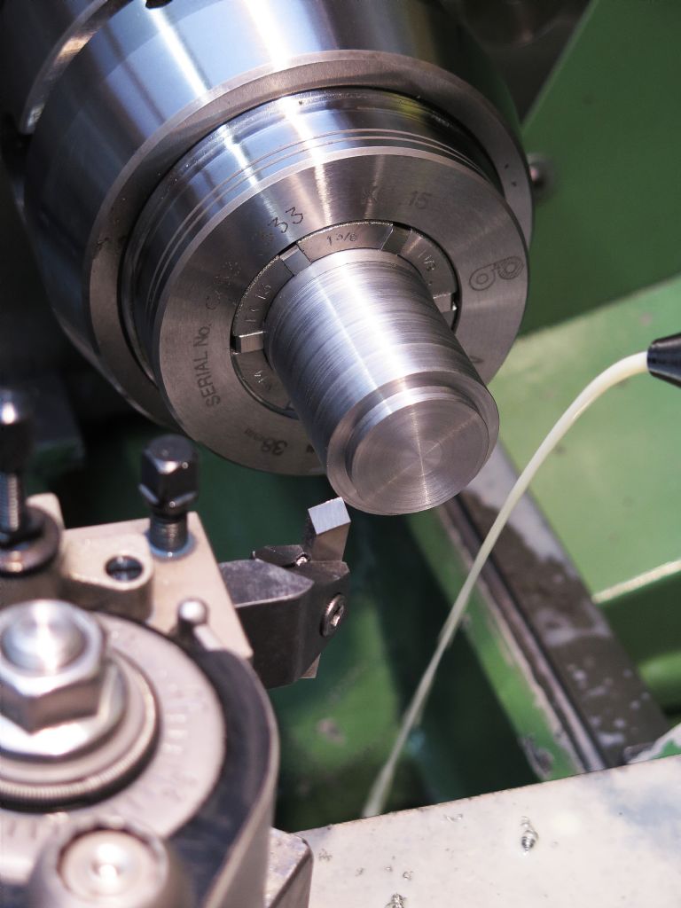

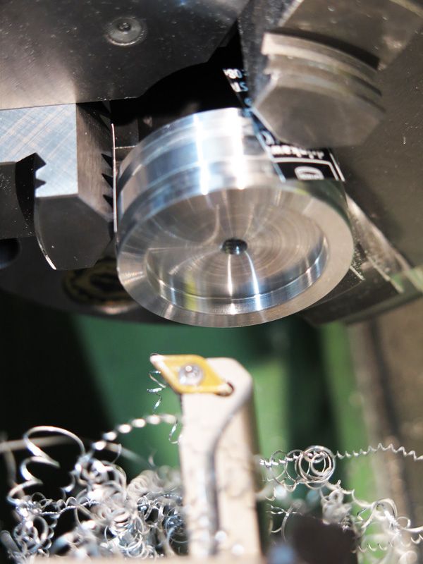

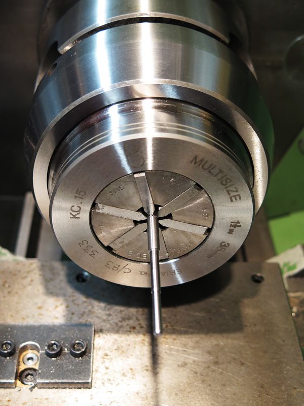

      Lovely finish on the bore Nick, was that using your posh boring bar you were telling me about the other evening?
      Martin.
      #215846
      Nick_G
        @nick_g
        Posted by Martin Cottrell on 10/12/2015 20:39:24:
        Martin.
        lol yeahh. laugh
        It's as they say a cracker. – There is noway as a hobbyist that I could have afforded or justified buying one at retail though. I was just lucky in being in the right place at the right time.

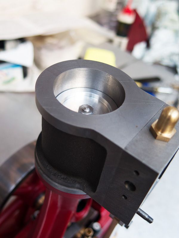

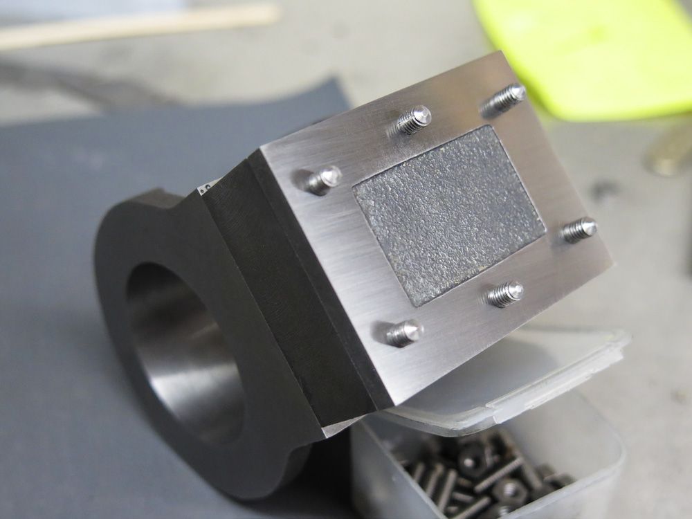

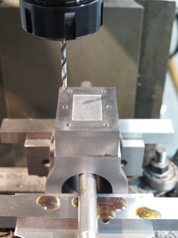

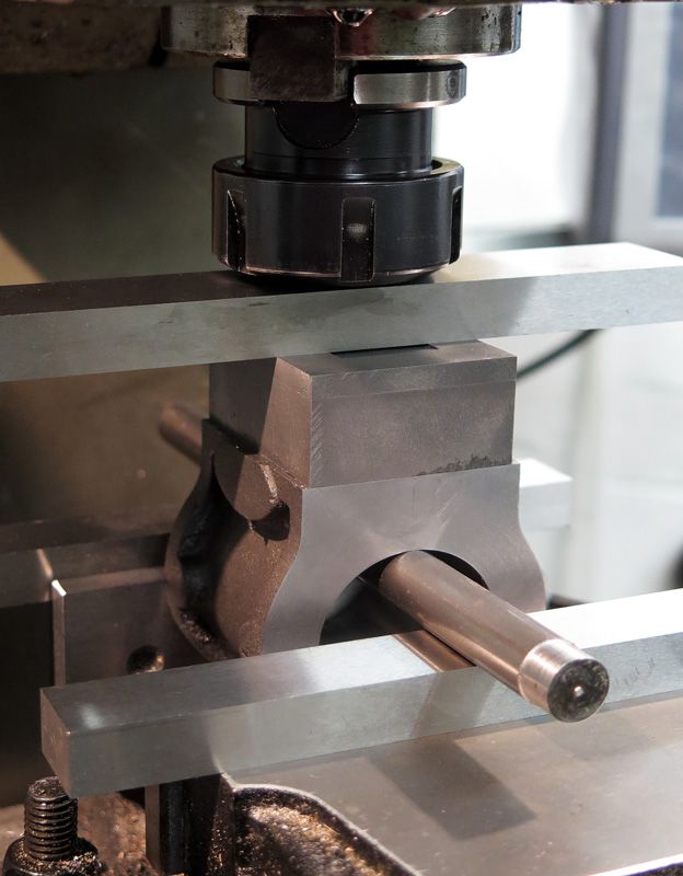

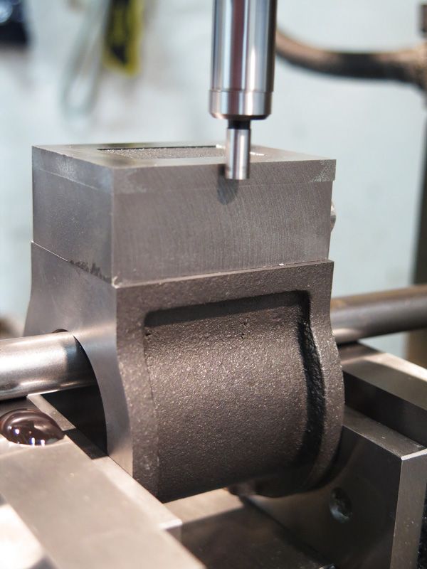

          Time to mount the valve chest and it's cover to the cylinder.
          Semi tacked the bits together using super glue. (a useful trick learned on this forum) and clamped them square into the vice.
          Then used and edge finger to locate the center of the chest.
          The DRO was then used to navigate around the holes and to drill their depth. Tapping size first then clearance size in the cover and chest leaving the cylinder section still at tapping size.
          A blip with the blow lamp to brake the super glue bond, tap the cylinder threads and a dressing to the lid face. ………. Voila.! smiley
          Nick
          Edited By Nick_G on 11/12/2015 02:31:09

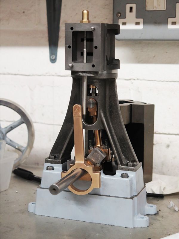

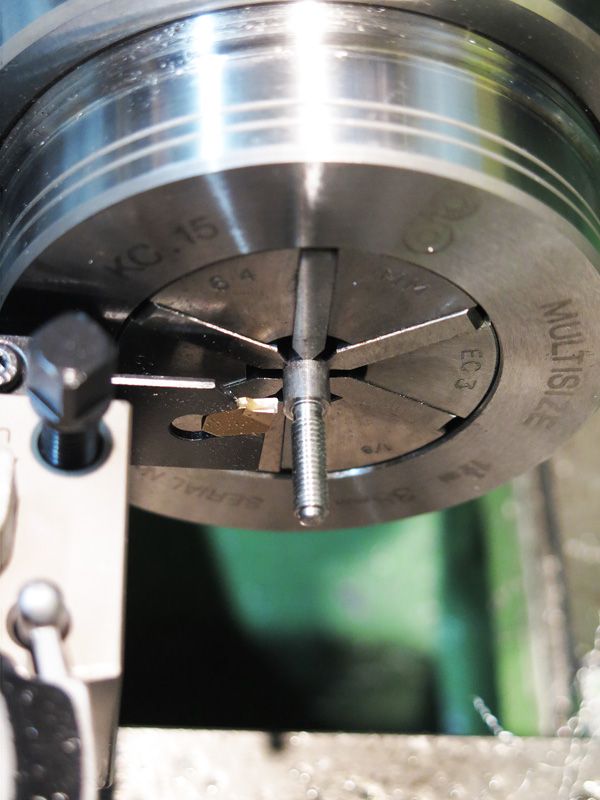

                Ready for a weekends machining. Then find out I have not got some of the drills, taps, dies etc. I need. sad
                Numptie bu33er I am.! blush
                Like this valve rod that needs a 4 BA thread on it. Turn it to size to find out that I don't have the die that size that I 'thought' I did.
                Paaahh, Nick angry
                #215974
                  Obviously not a Boy Scoutdont know
                  Assuming you have a M3.5 tap for rethreading electrical boxes you could single point the valve spindle M3.5 as its a very similar dia to 4BA and tap the valve nut to suit

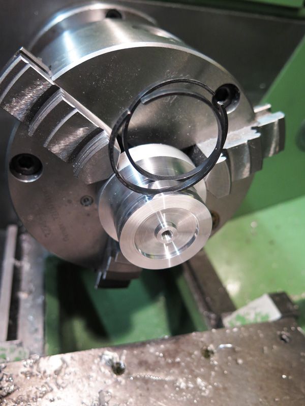

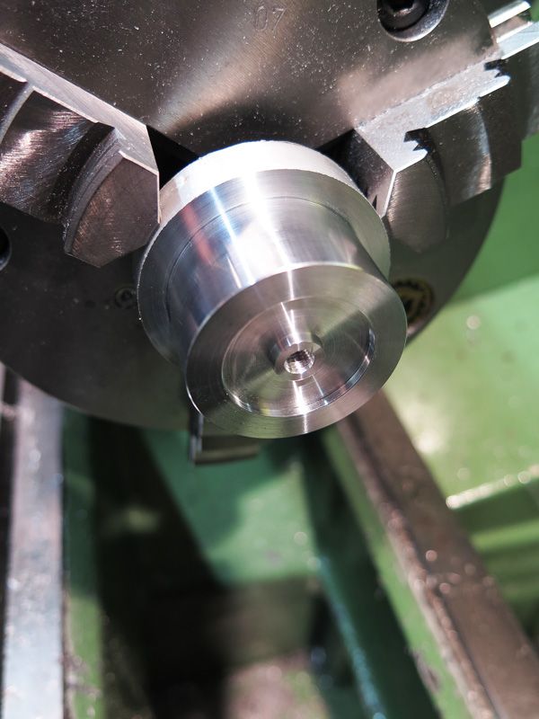

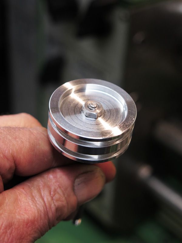

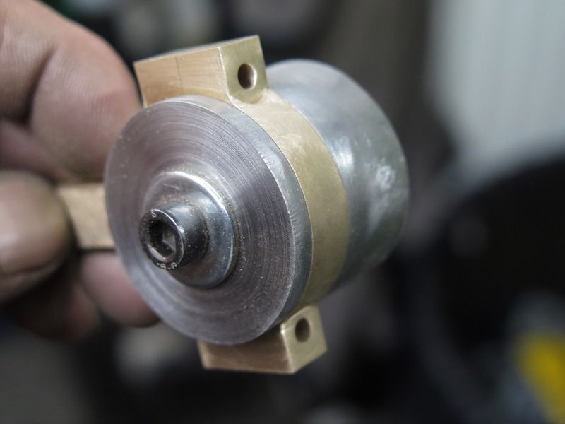

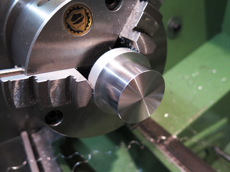

                        Made the piston. After 'consultation' with the wise one decided to make it out of Aluminium.
                        A slug was tuned down to 4 thou under the bore size.
                        The bottom side had a recess let into it then drilled and tapped to 2 BA
                        Grooves for the piston rings were cut.
                        It was then parted off a tad over size, reversed in the chuck and faced off to the required size. A recess was then let into it with a boring bar.
                        The finished up and down thingy. smiley
                        I could then get the final measurement for the length of the piston rod as I had deliberately made it a lttle on the long side until I had ref points from the top and bottom of the piston.
                        Nick
                        Edited By Nick_G on 15/12/2015 23:11:34

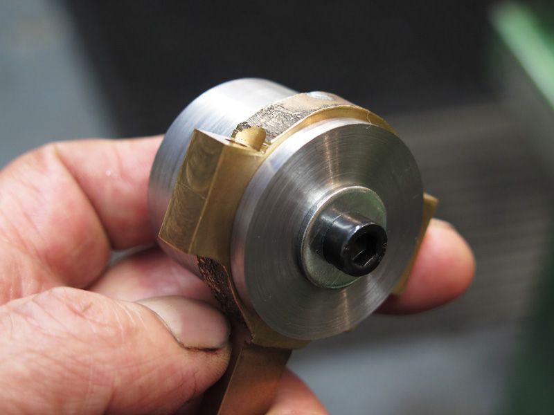

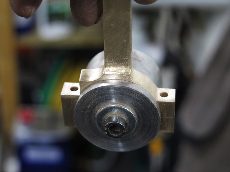

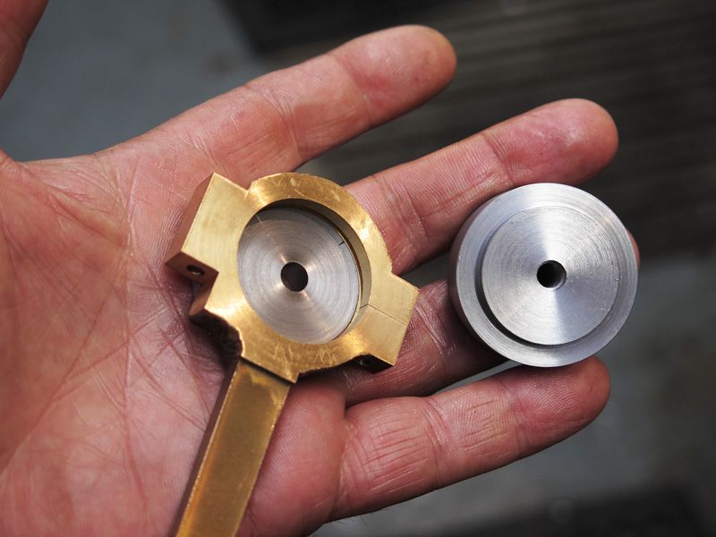

                          Did some work on the eccentric.
                          I decided to make a filing guide. Two stepped buttons were turned.
                          One had a 6mm clear hole in it. The other had a 6mm thread tapped into it.
                          And went together thus.
                          Filing commenced.
                          Then a bit of dressing. I will give it a final finish and polish at assembly time.
                          And how it's all starting to look like an engine. smiley
                          Nick

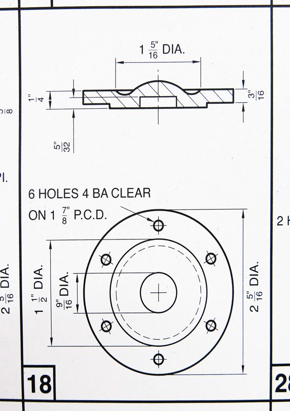

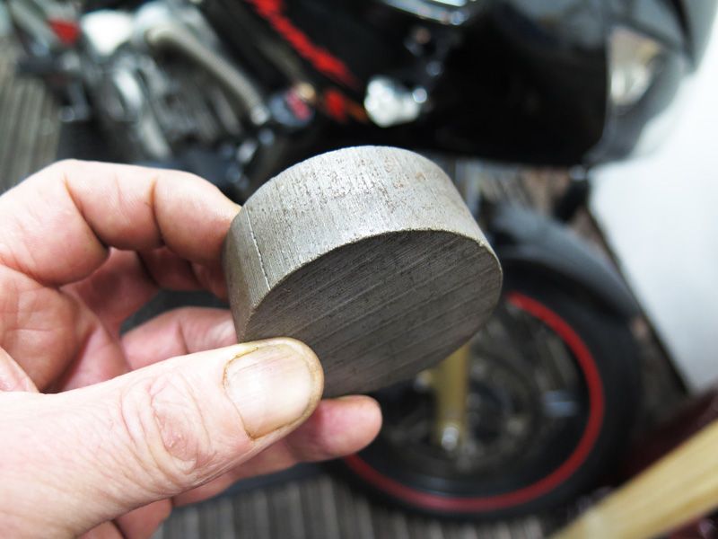

                                Hi Guy's. Need a bit of advice please.
                                I have to produce this :-
                                From this :-
                                I feel confident on the general machining but the top has a cosmetic dome to it. It is I realise not a precise size, it just has to 'look right'.!
                                I have never had to do such. What is the best way please.? A form tool.? If such what is the best way of making such.?
                                Or is there another way.?
                                Cheers, Nick
                                #217363
                                  Too big an area to do with a form tool which will result in a lot of chatter.
                                  I would use a HSS tool with a bull nose end to do the concave outer part and then freehand the convex central part. You can refine the basic shape by hand turning much like woodturning with a hand held tool and finally use a bit of emerycloth. I would leave the machined top surface a little over thickness and then take a final skim once the shaping has been completed just incase you mark it.
                                  Edited By JasonB on 21/12/2015 19:31:05
                                  #217419
                                  Ian S C
                                    @iansc
                                    For brass or aluminium I actually use a wood turning scraper to cut curves. I sometimes file a bit of sheet metal as a template, a bit of cardboard will do ok for a one off job.
                                    Ian S C

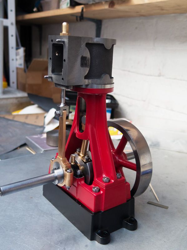

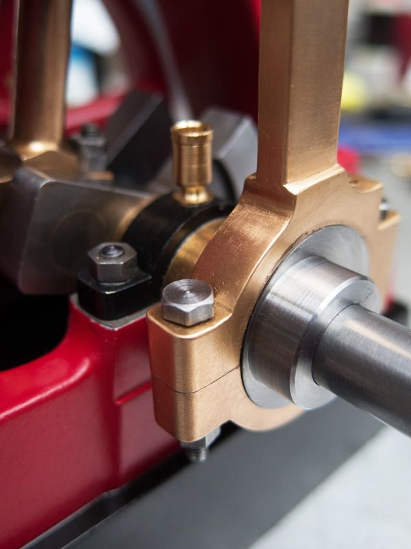

                                        Nick_G
                                          @nick_g
                                          I have been busy. smiley
                                          Nick
                                          #221200
                                            I see the postman had some paint left over from doing his boxes. Looking good.
                                            #221201
                                              Posted by Nick_G on 15/01/2016 13:24:35:
                                              Nick
                                              Busy and effective !!

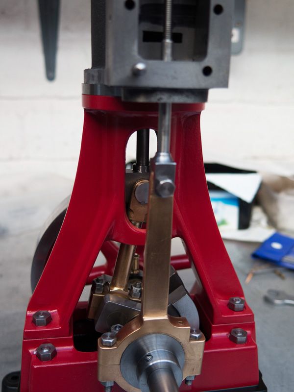

                                                Nick_G
                                                  @nick_g
                                                  Posted by JasonB on 15/01/2016 16:17:51:
                                                  blush
                                                  I admit it is a bit on the red side.
                                                  I picked it from a swatch at a local place near me that will mix the satin paint into an aerosol. – I was sure it looked darker / crimson on the swatch.
                                                  I also took your advice and have given a couple of coats of satin lacquer of the type used on motorbike petrol tanks.
                                                  Rounding off and reducing the size of the cylinder flanges and getting the size the same as the valve chest was a bit nerve wracking but went smoothly once I had grown a pair to actually do it.! – Again I took your advice and made them smaller than the end covers so that the wooden planked cylinder will flow into them.
                                                  On the subject of the wooden cladding. I was thinking of attaching them with super glue then staining / sealing them with linseed oil. Is this a good idea or bad.? Then to trim them up with brass banding.
                                                  Nick
                                                  #221218
                                                    Thats what I did on the Tidman. The other option is to stick them all onto a piece of linen (old hanky) making sure not to get glue on the edges. Once dry this can be wrapped around the cylinder and then the banding will hold it in place.
                                                    Edited By JasonB on 15/01/2016 18:21:10
