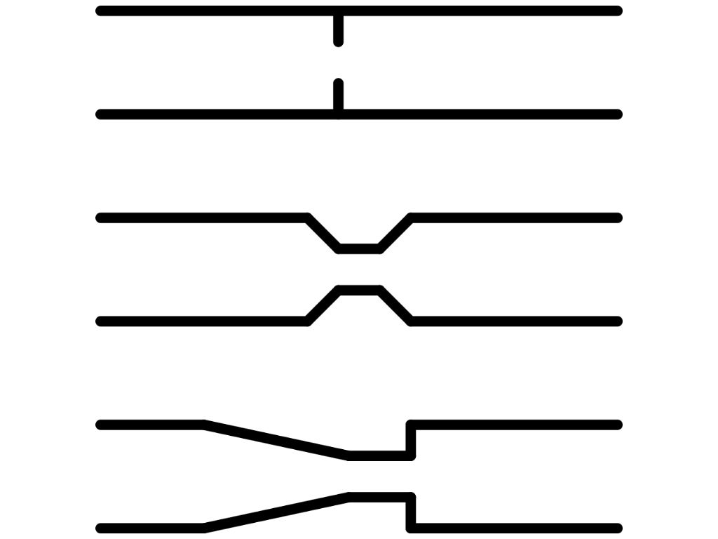

      I wonder if any of you clever people out there can help me with a question.
      Imagine a pipe 3/8 dia, which for a length is reduced to 1/4 dia, and then back to the original 3/8 dia .
      My question is would the flow at the end of the pipe be the same as if it were 3/8 all the way through? Let's assume only water pressure from a tender.
      Originally I thought not, but someone has confused me now by suggesting that the volume would be the same in either example, because the pressure or speed would rise in the smaller pipe to compensate.
      Is this reasonably correct?

          No, of course not. Would a 1/4 diameter pipe provide the same flow as a 3/8 diameter pipe? Just forget the two combined for a few seconds!

            Suppose it was 12 inches diameter reduced to 1/4 – kinda makes it obvious.

              No. I it was true the water companies could fit reducers to water mains and run 1mm diameter pipes

                Perhaps the other person has missed the important point you mention, i.e., the flow would be the same in both cases.
                He or she is right that the flow on either side is the same as in the narrow part of the tube, but rather like electrical circuits, there is a resistance. The higher the resistance, the lower the current flow. Old electrical books make the analogy between water and electrical flow, hence use of the word 'current'.
                In the case of no hole in the smaller tube, there would be no flow, so could we call that an insulator?

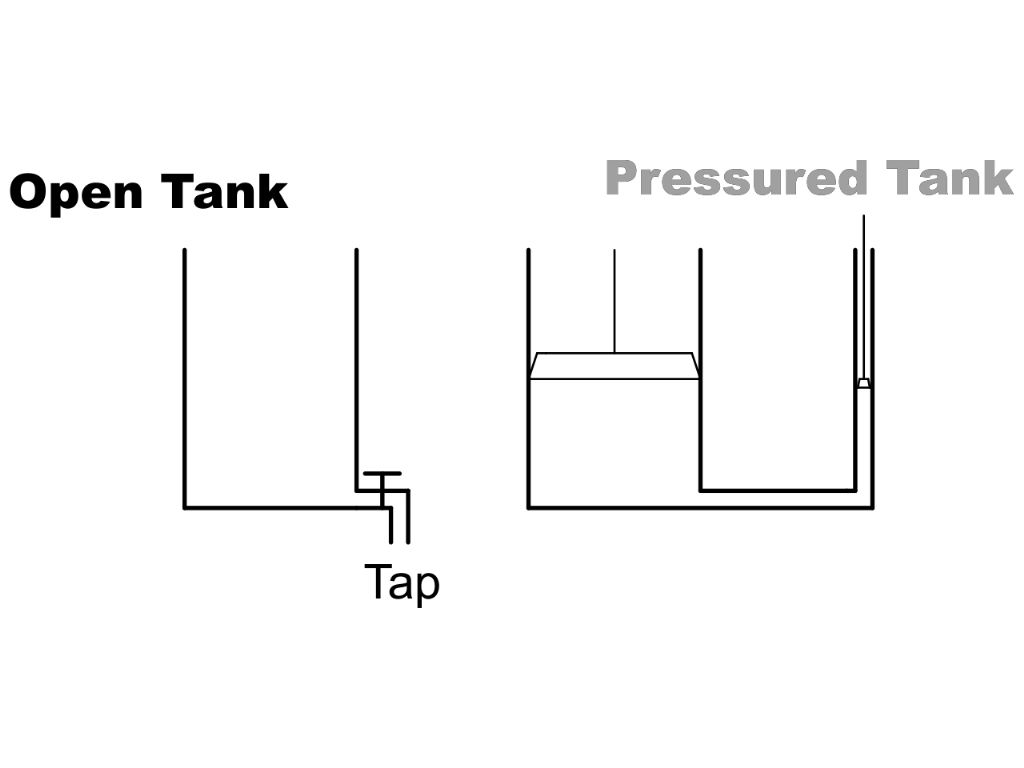

                                                      As a picture is worth a thousand words:
                                                      If the tap on the open tank is cracked open, the amount of water flowing out of the tank will be constrained. If the tap is fully opened, then more water flows but the volume is limited by the water pressure and the diameter of the outlet pipe.
                                                      In the pressured tank, something rather different happens. If the piston in the large cylinder is pushed down a fixed volume of water is transferred to the small piston, which moves much further inside its cylinder. And in reverse, pushing the small piston down moves a fixed volume of water back into the large cylinder, which pisto moves a small distance. While the presence of a choke in the pipe makes no difference to the flow, or to the movement of either piston, it does make a difference to the pressure!
                                                      Open tanks are typical of domestic water systems: water pressure at the tap is usually obtained by gravity feed from a reservoir on higher ground, not from a directly connected force pump. As a system gravity fed water is cheaper and more controllable. Most of the system runs at low pressure, up to about 10bar.
                                                      Pressured systems are typical of heating systems and Hydraulic systems like power steering and road diggers. In a hydraulic system small pipes are used to transfer energy as high-pressure water. The high-pressure is easily produced by a force pump, and the relative movement of different diameter pistons can be exploited to multiply force at the expense of movement or vice versa. The small pump on my Hydraulic engine crane allows me to lift a 1/3rd ton lathe with no trouble at all. Hydraulic systems run at much higher pressures, say 500 or 600 bar. The very high water pressure available from a simple force pump – little more than a lever operated ram in a plain cylinder – is excellent for testing boilers. Although the pressure is much higher than that produced by steam, there is very little energy stored in it. If a water pressured boiler gives way, it won't explode.
                                                      Testing a boiler by pressurising a gas is very dangerous because gas acts like a spring. If the boiler breaks, it could well explode because compressed gas contains stored energy that can be released almost instantaneously.
                                                      Gases and liquids follow the same basic rules, but the compressibility of gases cause considerable side effects compared with liquids. But designing a ship's propeller is much the same mathematically (I'm told) as designing an air-screw. They're not interchangeable though – large bladed ship propellers turn slowly in a thick fluid, while slim aircraft propellers spin fast in a thin fluid. Propellers have to be optimised to the working fluid.
