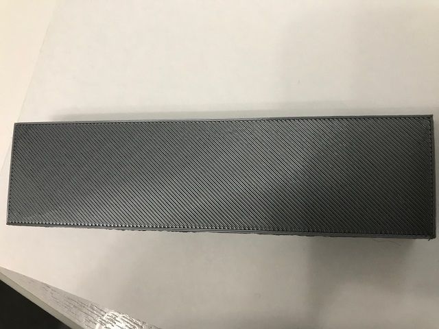

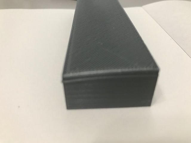

                      #388995
                      Colin Heseltine
                        @colinheseltine48622
                        See photos below of ER11 collet holder. Picture 2 shows the amount of lift which occurred and made the shape somewhat distorted. Picture 1 shows a closeup of the base. From the look of it would I be correct in saying that the Z-height needs lowering.
                        Thanks,
                        Colin

                                        #389365
                                        Steve F
                                          @stevef
                                          Hi
                                          I've had a shower and it gives you time to think.
                                          Maybe stick is not your problem.
                                          I cant gauge the size but it looks like a big "slab" of plastic. What you seeing is the same as the problems you get with ABS. This is caused by Hot Bed-Hot new filament-cooler filament in the middle sandwitch, The print is sticking to the bed but is being pulled off by the cooler layers above.
                                          Maybe you could also try reducing the infill %.
                                          There's a good troubleshooting guide here **LINK**
                                          regards
                                          Steve
                                          #389401
                                          Colin Heseltine
                                            Steve,
                                            That's a good troubleshooting guide. I think could prove quite useful.
                                            The slab of plastic was 114mm long, 30mm wide and 15mm high.
                                            Colin

                                              #389857
                                              Colin Heseltine
                                                XD351,
                                                Yes I built the printer.
                                                With the first Layer settings at -0.550 the PRUSA badge came out very well. I printed the Buddy dog and this also came out well.
                                                PRUSA tech support came back to me once they had see a few photographs and confirmed that the issue was the Z-height.
                                                Next print will be a speaker bracket of Thingiverse.
                                                Colin
