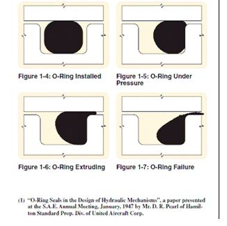

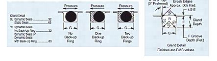

                                            For all the doubters of the O-ring rolling in the groove, perhaps the following from Parker Seals technical documents will clarify the situation.
                                            In a reciprocating seal, there is relative reciprocating motion (along the shaft axis) between the inner and outer elements. This motion tends to slide or roll the O-ring, or sealing surface at the O-ring, back and forth with the reciprocal motion. Examples of a reciprocating seal would be a piston in a cylinder, a plunger entering a chamber, and a hydraulic actuator with the piston rod anchored. Figure 1-9 illustrates a typical reciprocating seal.
                                            Further more they give not only performance data but also recommended groove shapes and necessary radius for a typical groove for different applications. The seminal paper of the use of O-rings was by D R Pearl in 1947 presented at a conference of the American SAE. In it Pearl gave some diagrams of how O-rings behave when used as sealing rings in a reciprocating application. His diagram is shown here. Note the O-ring does not fill the groove when static or moving.
                                            Furthermore, Parker Seals in their technical data give recommended groove shapes for reciprocating sealing rings as seen here.
                                            You will note several important points. Firstly, the groove must NOT be square cut as per a normal piston ring. It should also have a V shape with shallow slopes and the bottom corners must be radiused as is the top transition to the piston wall. Also note the recommended back up pieces shown which makes the O-ring roll properly in semi-circular side cheeks. A square cut groove will not allow the O-ring to work as intended. Refer back to Pearl's original diagram and see how much sideways movement is needed for the O-ring to work correctly. Tight grooves result in poor sealing.
                                            So there is the evidence, if anybody knows any different then please enlighten us.

                                                    Have you actually studied Parkers' design book?? Like so many 'extracts' you've left out critical information and twisted others. O-rings that roll, fail in torsion. Pearls diagram does not show failure due to rolling but failure due to extremely high pressure extrusion. Thousands of psi. Those "recommended back-up pieces" are not there to allow the O-ring to roll. They are there to prevent extrusion and in fact are called that!
                                                    O-ring grooves work very well with straight sides and sharp inside corners. The surface finish inside the groove, expecially the bottom, is critical to sealing. Any scratches must be radial not axial. The tapered sides and inside radii are show as maximum conditions not to be exceeded.
                                                    Anyone following this is recommended to get the Parker Design Handbook and study it.
                                                    Ian, O-rings were used in reciprocating applications before model engineers even knew about them. The X-ring was invented by Parker. Rubber does compress!! That's how it seals! The shape distorts when it does compress.
                                                    Go get it right.

                                                      With respect John, all that really reminds us is to break the corners of the groove don't cause surface damage to the ring.
                                                      They don't show a 'semi-circular groove' as in your first post, but they do show backing rings.
                                                      Extrusion should only happen at pressures above the o-ring's standard rating, and that's when a backup ring should be used.
