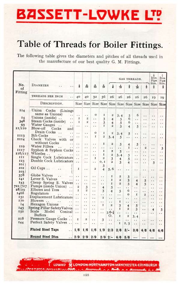

                      The boiler fittings specified for this TE were listed in the Basset-Lowke catalogue and were sold separately.  These are taken from my catalogue – circa 1960!
                      The safety valve was 5/16″ x26tpi
                      The water gauge 3/16″ x 40tpi
                      The blower cock 5/16″ x 40tpi
                      The check valve 3/16″ x 40tpi
                      The pressure gauge syphon 3/16″ x 40tpi

                        Hi Tricky and thanks for that info. I never thought of looking in my own Bassett Lowke catalogue so I just did that and did indeed find a Table of Threads for Boiler Fittings. on page 188:-
                        Bassett-Lowke-Catalogue-Thread-Sizes-600
                        But this catalogue is dated 1932! So the above table isn’t of much help, really.
                        I’d be very interested to see the page(s) from your 1960 catalogue, though if you could manage it, Tricky.
                        And thanks for the offer of the booklet called “How to build a Traction Engine”,  that would be very useful, too. I do have ‘instructions’ comprising 12 pages plus 2 pages of appendix but mine’s called “A WORKING MODEL OF A ROAD TRACTOR – How to make a realistic model from Standard Castings”. I wonder if yours is different – the title certainly is.
                        About the sizes you give, the one “The pressure gauge syphon 3/16″ x 40tpi” is very small. I couldn’t find a supplier offering such a small size.
                        Thanks again for such great info.

                          Hi MEinThailand,  the booklet I have is the same as yours but with the addition of 4 pages.  I have put these, together with the relevant pages from the Basset-Lowke Catalogue, in a pdf in my gallery.
                          The commercial pressure gauges seem to have a 1/16″ pipe fitting so the syphon can easily be made from some 1/16″ copper pipe and a suitable adapter to screw into a bush of your choosing. However, I did find Polly Model Engineering sell a 3/16″ x 40 syphon.
                          Hope this helps.

                                Wow! Tricky, I downloaded the document you posted and it’s terrific. Extremely useful not only does it give thread sizes and TPI for the different fittings but it also gives details of some fittings specially for the 3/4″ Bassett Lowke model I’m building – the displacement lubricator for example.
                                This is so useful to me.
                                Not only that but it gives prices too. For example the big displacement lubricator is priced at 14/7 which I take to be 14 shillings 7 pence. I just checked that with MS Copilot and that turns out to be £32 in 2025. This is the price of the same lubricator today from MaccModels. Fascinating.
