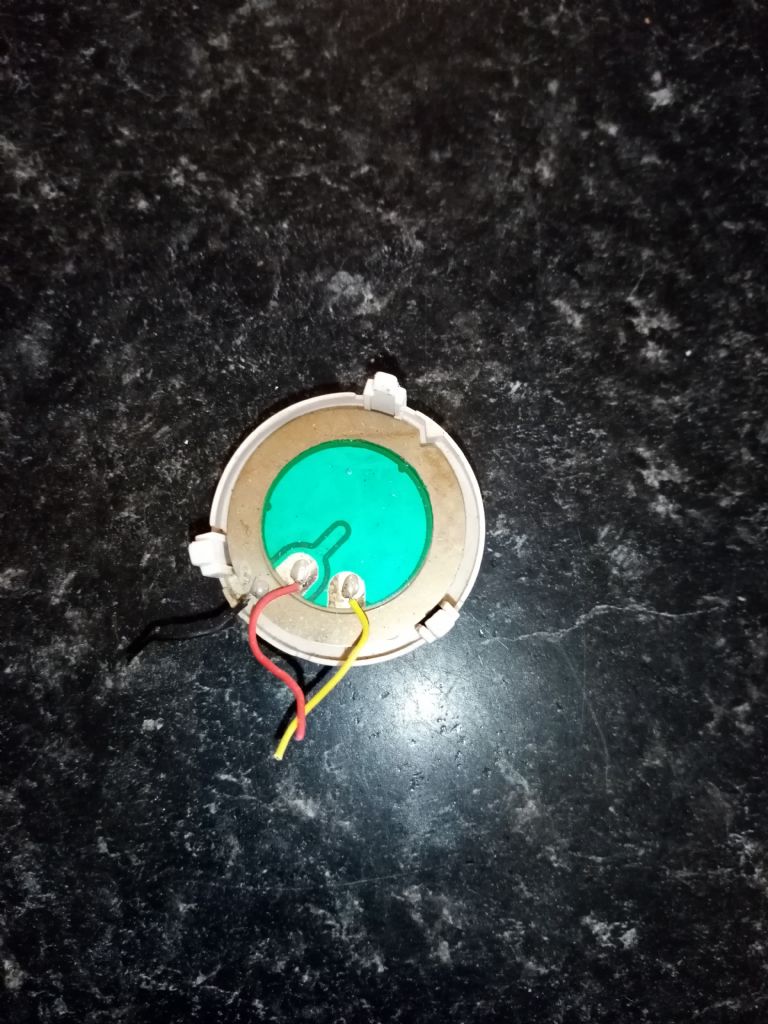

        I've recovered this from a smoke alarm, it looks as tho I have to give it some ac signal, or at least pulsed dc. Before I release the magic smoke anyone know which wire is which? Can I drive it straight off an Arduino, or will it need a drive transistor?

              I'd connect black to ground and yellow to the Arduino via a 1k resistor.
              As they resonate at particular frequency (so the Arduino's output will have to be tuned to match), to avoid blowing the Arduino's output, I'd assume it's a short circuit. 1k-ish will protect it. Might be OK without because Arduino can do 30mA out, but safer not to risk it. A scope would reveal how much 1k drops the 5V line, hence allowing the current to be calculated. I'd adjust R for 20mA to give max safe noise, you might think that's conservative.

                    Gound to the brass disk, signal to the broad plated area. NO resistor in series…Fed direct from Arduino output. These buzzers work well at higher voltages – 10 to 30volts Ac, and must be at the resonant frequency for any useful sound. The one you have ( had..) when used in a single transistor oscillator with a 8 to 10 millihenry coil as resonating inductor – will buzz loudly with a 5volt supply and a scope will show a good 20 or so volts across the piezo – result of resonance of the piezo disc capacitance and the inductor. A straight 5volt sq wave to the piezo from the Arduino would have made sound if at resonance. Just using a audio signal genny with a 5v output sweeping across resonance made my buzzer whistle nicely…soft but definite.

                          Tried feeding it from a sig gen via open collector transistor, piezzo from +ve to collector. I connected +5 to where the yellow wire is on above photo and collector to where black wire is. Still no joy, so wound up the volts to 9v, still nowt. I can hear the little speaker, so not my hearing, although it does get quite challenged above 6kHz. My excuse is it's a devensive mechanism, women have higher pitched voices.

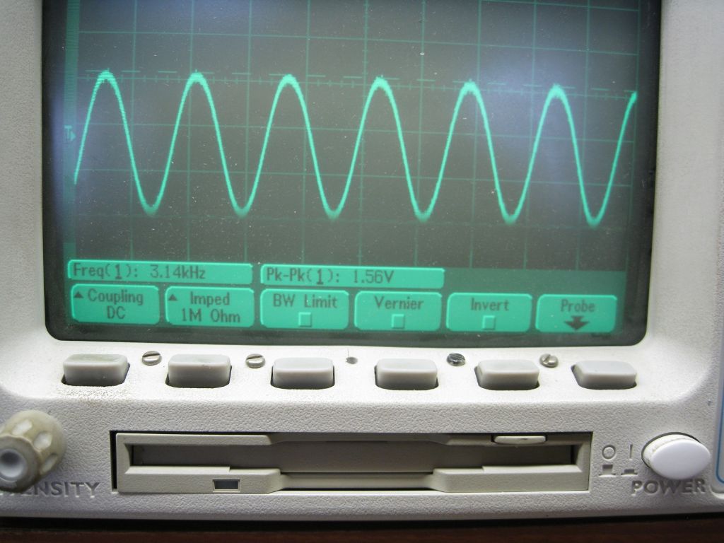

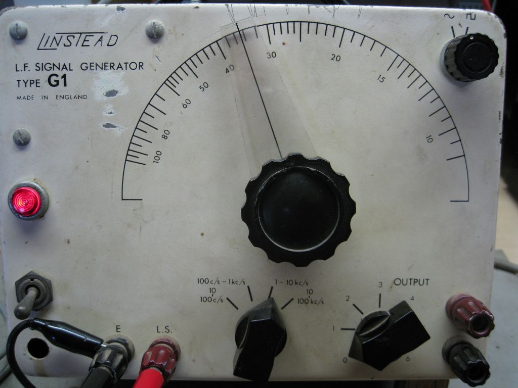

                              Either the Piezo is duff or the transistor is duff or not being turned on Duncan. Knowing what you dabble with, I am sure you took care of sufficient drive to the Base, via series resistor to the base…1K or so…
                              I used an old Linstead English Valve audio gen to do this..
                              Sig Gen set to 1-10kc/s (!) range, output set very low – 1.56v PK-PK on the scope – Freq at resonance approx 3Khz.
                              Check the video and its noise…
                              EDIT – Square wave setting on sig gen resulted in maybe 50% drop in perceived sound amplitude – PK-PK voltage was the same as the sine setting on the 'scope. Also tried the OC transistor – it did not work –  when the transistor turns off, the voltage across the disc remains – there is no discharge / reversal so the piezo does nothing – it cannot bend opposite as there is no voltage plus/minus swap – the next transistor turn on just replenishes the charge on the piezo. ( like charging a capacitor, since that is what it is..)
                              Its not like a voice coil speaker which has a mechanical spring built in to return it to a zero position ( the cone, etc).  The peizo element is a high impedance, except at resonance, and a charge applied is maintained for some time – it dissipates  slowly compared to the period of resonance, so the piezo remains 'bent' in one direction, till you discharge it, charge it in opposition, or leave it for some |miliseconds| …
