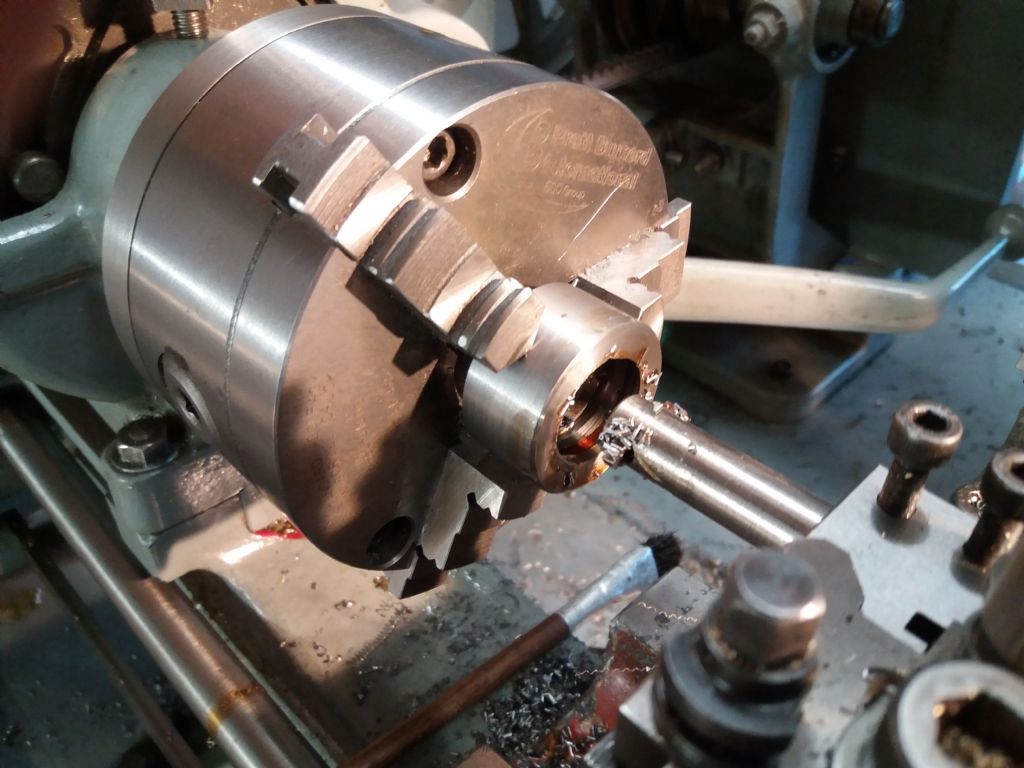

        Is there anyone on the forum, web etc that is able to machine half nuts for the myford m type 3 1/2 ?.
        #405364
        David George 1
          @davidgeorge1

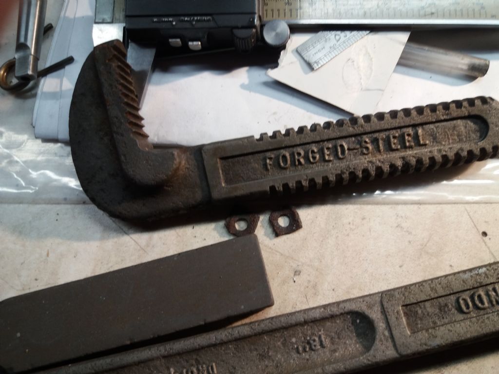

          Hi Grant You would make it as a whole nut screw cut and cut in half before soldering on to original lever. You just screw cut with a boring bar with a tool with a slightly thinner than original pitch size and widen to suit shaft size with compound slide when to depth. Here is a picture of a new nut I recently made for a wrench that needed replacing.
          David
