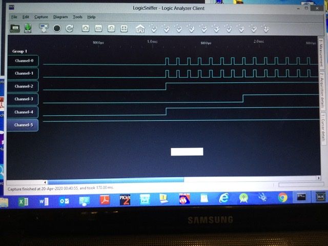

                      Re my previous post
                      The instructions for programming the Arduino and the software to run on your pc are here **LINK**
                      This is a screenshot of the sort of display you get
                      #470509

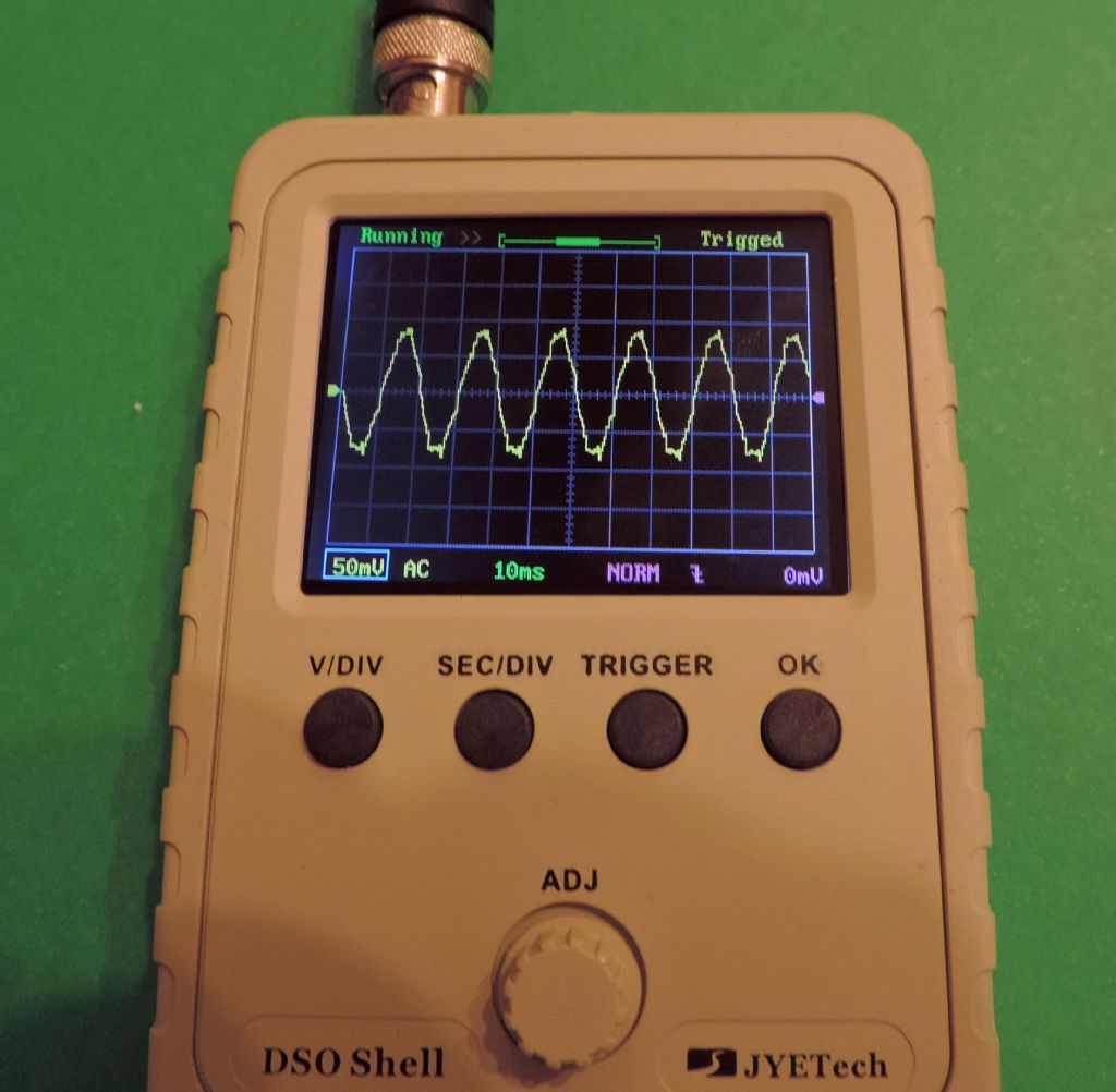

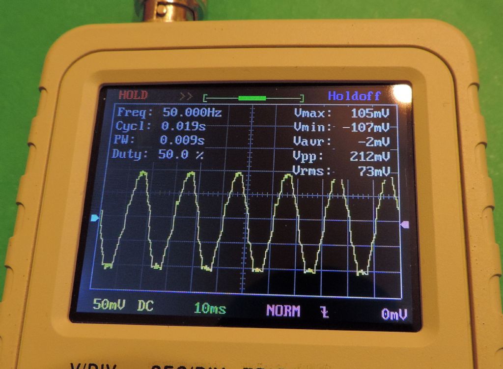

                                            As you just want an inexpensive tool to get a job done rather than something capable of handling limitless possibilities Google KKmoon 2.4" digital oscilloscope
                                            (Edit this is the same thing as the JYE Tech scope)
                                            For £20-30 you will have a pocket scope more than capable (200kHz max frequency) of doing what you need.
                                            I'd add that having used scopes of all sorts these are actually very good within their limitations -its fantastic being able to take a scope to the job rather than the other way around. I've used it with a microphone to compare the frequency responses of loudspeakers. I've 3D printed a cradle for it that takes an old phone battery, charger and voltage booster.
                                            I would suggest ordering a set of X10 probes at the same time. Cheap ones will be fine.
