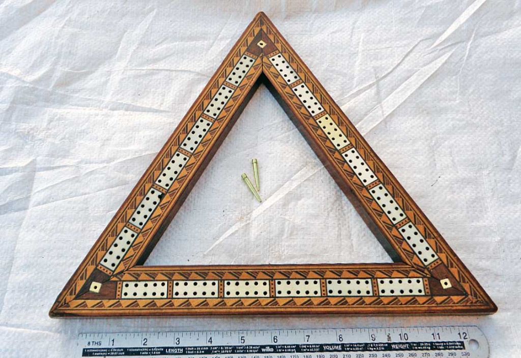

      Hi All,
      I really need to find an old white piano key so that I can cannibalise the white material on the top to repair a very nice antique cribbage board of unusual design that I have just got.
      As this is a job for our business I am naturally prepared to pay for this and postage if anyone can help me out.
      Possibly a small piece of very thin bone would also do but must be a nice whitish cream colour.
      Regards, Martin

            It might be quite difficult to match – 'white' piano keys ain't all the same colour by any manner o' means. I remember once trying to do a refurb on an upright.
            #331919
            pgk pgk
              @pgkpgk17461
              Another alternative might be dental filing material.. available in a whole range of shades and usually both in chem-set or light-set versions. If you have a friendly dentist locally you could take in the cribbage board to see if the shade you need is available.

                      Hi John, Good idea! I had not thought of the old white handled dinner knives, I often see them at car boots, will now keep an eye out.

                        John beat me to it, I repaired a chess piece using the material from the handle of an old knife & it was a good match and no Elephants were harmed in this repair !

                                              Many thanks to George for sending me some piano key tops, just perfect for what was needed.
                                              Added the three missing corner pieces and the one missing score board section and it now looks a lot better:
                                              Drilling the holes was tricky as they were so near the edges, I started at 1.mm and carefully worked up to the final 2.7mm, one corner piece flew out and was ruined but not to much trouble. Made a couple of brass markers also.
