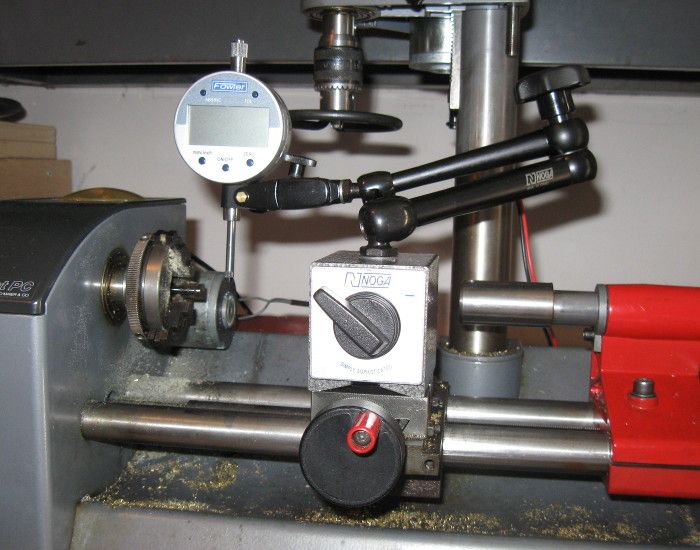

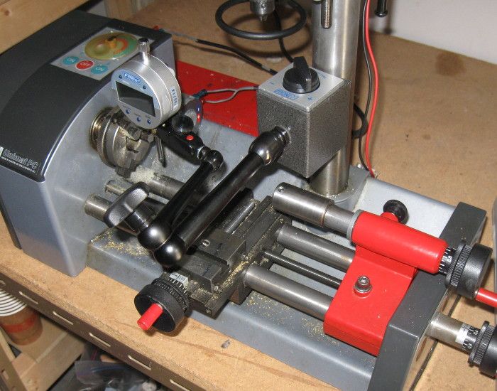

                        I was fortunate find an almost brand new Noga DG61003 at a very reasonable price on a garage sale last summer.
                        At first I thought that it may be overkill on my little Unimat, but in actual fact it has worked out very well. One of the disadvantages of this lathe with a round rod bed, is that the only suitable place for a mag base is on the cross slide. Prior to getting the Noga it could take 10 to 15 minutes of frustrating juggling to get the DI into a usable position in relation to the work.
                        Now it is simplicity itself taking less than a minute. My left hand grasps the DI, my right hand releases all joints in the articulated arms with a half turn of the black knob, thus allowing the DI to be moved almost friction free into position. A half turn back on the knob locks it all up solid again.
                        Compared to the no-name-brand mag base I was using before, besides being a far more practical design, it is also extremely well made, with no rough edges it has a quality feel, and the locking screws lock with the minimum of force and stay locked. Definitely not a cheap made in China item, I believe that it is made in Israel.
                        In my situation, I have found it such a time saver, that even at the full eBay price, it would have been well worth it.

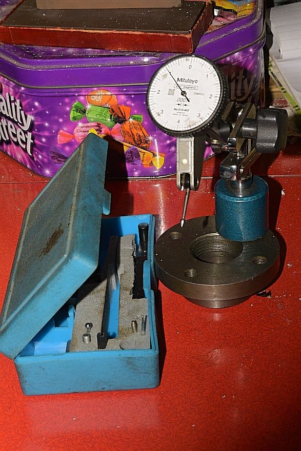

                                  I use the spring adjustment nearly every time I use it but then as I have had it for a long time I'm used to it. I generally set the plates the spring presses on parallel or leave where they happen to be.
                                  If I'm not using that I use this currently with the long finger fitted. I can also use it on the other stand.
                                  laughThe tin is full of boxford change wheels and my favourite stone for tools and a larger one intended for sharpening microtome blades I am playing with sits on top. The smaller stone is back to it's old self now I have used a diamond lap to remove the HSS clogging it up. It's improved the microtome one too but that one is insanely fine.
                                  Forgot to mention the bar just above the magnet on the finger DTI stand is also a spring but I have lost the screw that adjusts it some how. Need to make another. The joints are ball joints. Easy arrangement to make if some has a ball turning gizmo. The plates each side of the balls just have depressions in them.

                                      @Ketan – my probably "60kg pull" version is pretty hopeless, it won't support itself at reasonable extension with a DTI fitted when stuck sideways onto the mill column. It might be 60kg to pull it off vertically, but it rocks sideways far to easily IMHO. Mind you the Noga is only 81kg pull so not a huge difference, and the sideways grip isn't defined
                                      I regularly use it mounted on the round column of the Unimat milling attachment, as this is about the most practical way of aligning the milling table (when fitted).
                                      The Noga grasps very strongly in the vertical mode, there is absolutely no slippage, and horizontally there is no rocking at all. It is however possible to grasp it firmly and rotate it around the column. It takes a fair amount of force to do this, so there is very little danger of this happening accidentally.

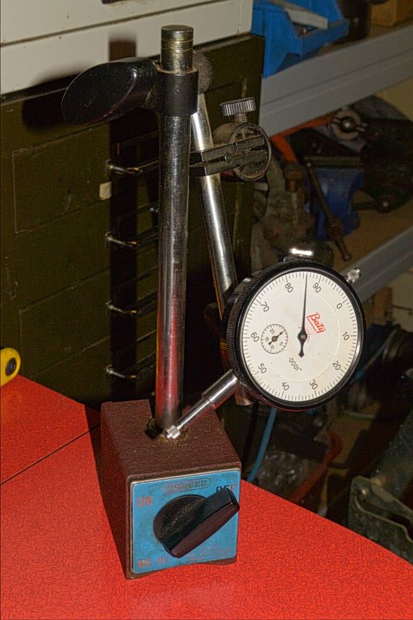

                                          Mine is by Draper. Not sure but this is likely to be after they bought Mit and tried to sell expensive under their own name. It even states made in Japan on it. I did have a finger DTI and holder etc later that was definitely from that period. The adjustment on this one is a little on the coarse side for a 1/10,000 dti really but not that bad. I recently bought the dti that is on it. My previous one was showing signs of plunger wear – the readings drift in a direction according to the way things are rotated. I generally use the tip of dti's to gauge by eye before actually engaging the plunger. The long travel is there for mishaps really.
                                          The spring on the finger dti stand is a better arrangement in some ways. It's very hefty and at the bottom of the main stem and has a limited range of adjustment. The "spring".can only compress by about 1.5mm Not sure how Mit adjust the one I linked to. The price isn't too bad for their equipment.

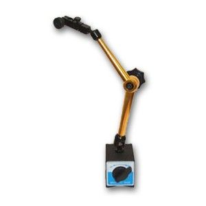

                                                  Not really wink The OP said " and select 350mm w/Dovetail clamp"
                                                  This is the item Martin was referring to:
                                                  I don't know what the pull is on mine but it certainly holds in place upside down or sideways on my milling machine. Doesn't this sort have wire inside to lock everything up when you turn the arm knob?
                                                  But I certainly agree about the spring adjustable, I've got one of those as well and have ditched the spring bar for a solid one.
