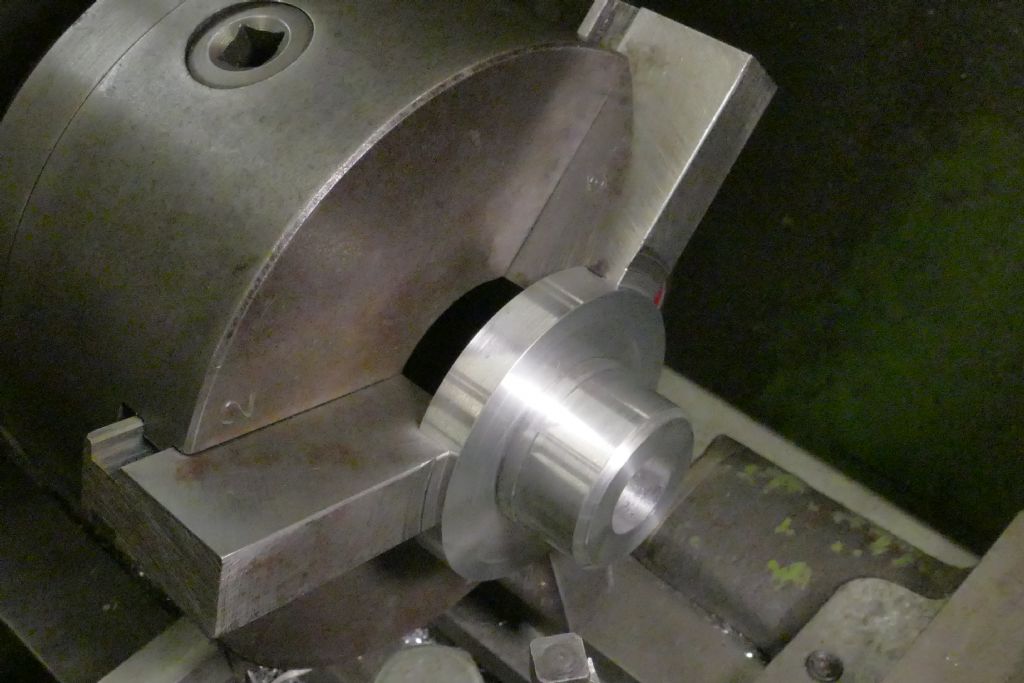

                              I made some soft jaws for my Burnard 150mm chuck. Recut and used them yesterday for a part that needs to run true and needs a good sliding fit on a motor shaft. The latter requirement means removing and replacing in the chuck may be required (I've made a stepped plug gauge already but you never know.. ). A between centres mandrel was considered but as it is an aluminium alloy I was a bit wary of jamming a taper in the bore.
                              Martin C
                              PS. I also need to drill and tap the flange face in 6 places so I will clamp the chuck to the mill table as a holding fixture that will not mark the part.
                              Earlier thread showing these jaws before use
                              Edited By Martin Connelly on 07/12/2020 09:19:29

                                        Posted by Martin Connelly on 07/12/2020 09:05:13:
                                        I missed this elegant example of lateral thinking first time round and don't recall the short article requested by Neil ever appearing. Now might be a good time for it!

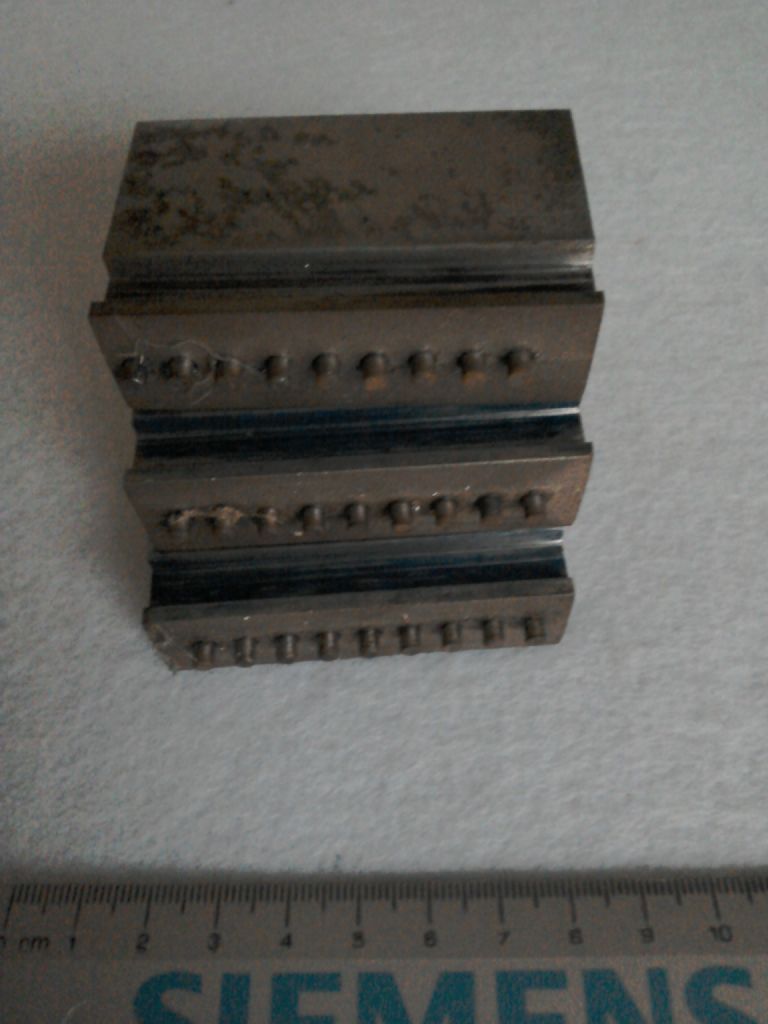

                                          As Clive says scroll to chuck jaw contact is a single point. Since this is the case I knocked up a spare set of soft jaws for one of my chucks using case hardened dowels. They are for thin parts often in aluminium alloy or brass so don't need great force to hold for turning. The jaws are reversible as well.
                                          Martin C
                                          From the other thread. Pic says it all. Brilliant!! I gotta make me some.
