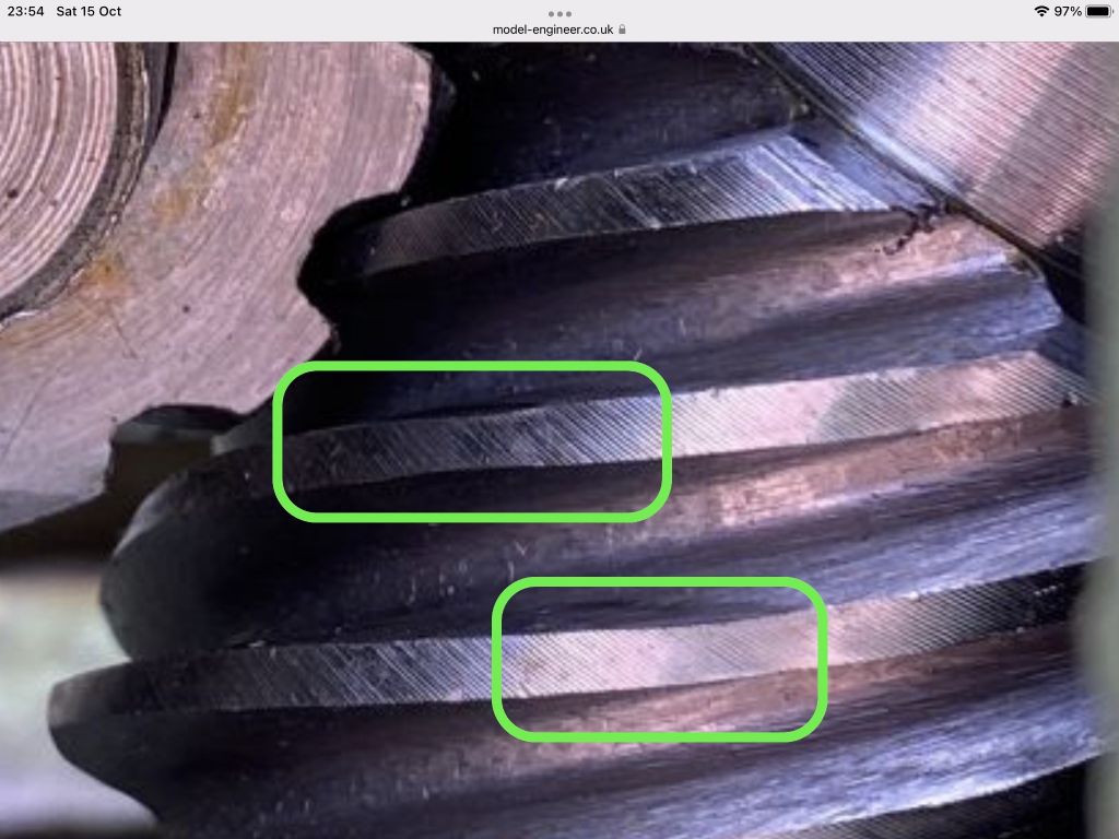

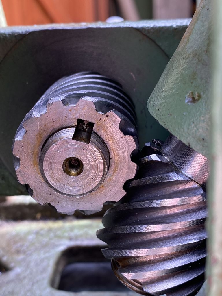

      Does anyone know if it might be possible to obtain the elevation gears for the Myford VMC anywhere? I suppose best bet is knowing which machines it was the same as (at least in respect of the gearing for Z axis). Mine has some roughness when lowering the knee and, although better on raising, still not perfect. You hear a click click click on when lowering. Everything has been cleaned but i cannot see any way of adjusting the gears.
      Wondering if they are all like this?
      Photo of gears cleaned up and with the retaining washer and nut removed. All greased up with fresh grease but no different.

                The gears look ok to me; I'd be looking for a problem elsewhere.
                Andrew
                #617453
                  I defer to your wisdom, Andrew
                  … but they don’t look a patch on what you have shown us of yours.

                                  The gears look a bit worn, but there don't seem to be any dings or damage that would cause intermittent action.
                                  Skew helical gears are not the best choice in this appication as there is significant sliding action rather than simple rolling action of the teeth. The flanks of the lower right gear appear to be quite worn. A gentle pass over the tooth flanks with needle files or wet 'n' dry may help remove any small imperfections due to wear.

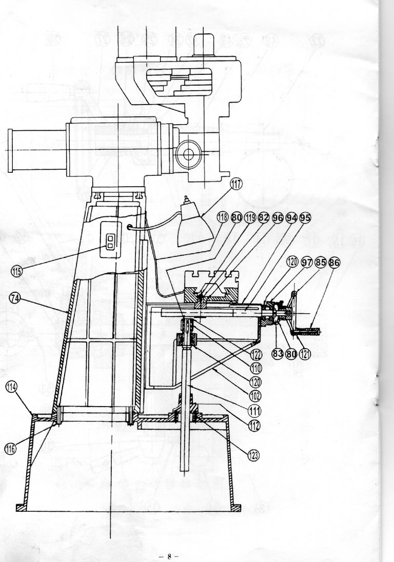

                                                  Those gears look about normal and are much the same on my Warco
                                                  2 AF mill ,the backlash on my machine is shown as 0.0015 " on the
                                                  index dial so you look to have excessive backlash on your machine.

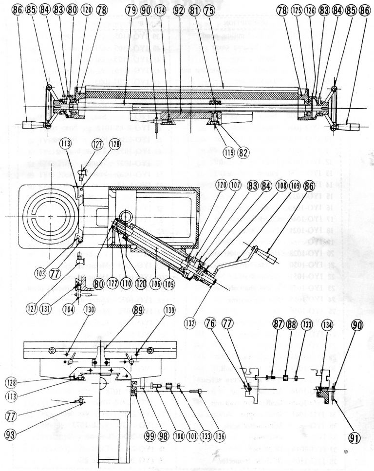

                                                  As far as adjustment goes the knee and gear shaft sleeve as depicted
                                                  in the following images are 2 separate parts 102 and 105 ,i expect the adjustment
                                                  for the backlash is made on assembly after which the these parts are filled
                                                  and eventually painted over to look as one piece.
                                                  You can soon tell if this is so as if you feel up inside the casting you may
                                                  find the holes or bolts protruding.
                                                  Even if you find a supply of new gears they may fit exactly the same if
                                                  the adjustment was out from new.
                                                  It may well be possible to adjust the mesh unfortunately it would mean
                                                  digging through the filler and paint to find the bolts to dismantle and
                                                  adjust.
                                                  When i got my A2f from Warco these 2 gears were very rough in operation,
                                                  i mixed some green label fine Timesaver abrasive in with the grease and
                                                  after a short time they were as smooth as silk ,this abrasive is non imbedding
                                                  and can be left on as it eventually becomes inert , i use this grease on these
                                                  gears "Rocol 18302 Tufgear Universal Open Gear" it is more suitable.
                                                  You could turn off about 1/8" off the top of lead screw gear and refit it with
                                                  a 1/8" washer underneath likewise also with the input gear to
                                                  establish a new contact point on the gears.
