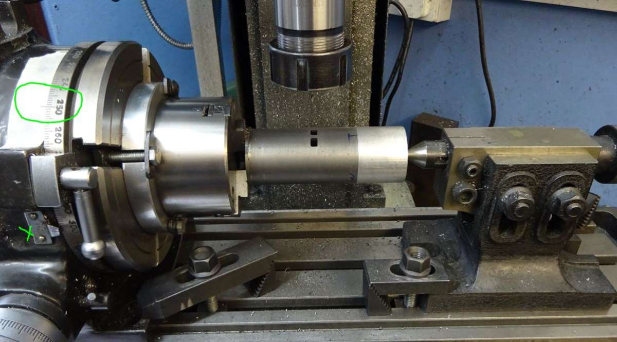

                                Simple work around when you want to angle the topslide is to stick a bit of masking tape on it. Mark a line against the zero on the scale and then just rotate to your required angle. When job is done peel off the tape and he o Myfords will have been harmed.
                                I do it quite often with the rotary table particularly when using it vertically as the mark is hard to see when it is in that [position. Similar with the quill scale on the mill, a sharpie mark where it is in my line of site has worked for years rather than the factory one which needs me to bend down to see.
