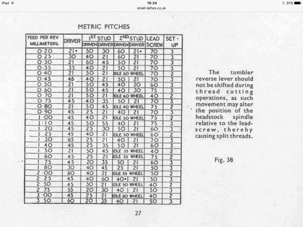

      Hi all.
      can I just get the gears listed inside the gear cover and fit them or will I need the special quadrant ?
      Thanks in advance.
      Pete H

          First question. Do you have a gearbox? Whether you do or not determines the answer….

            Yep, the gearbox was fitted from new I thing, 1968 by the serial No.

              In which case you do need the metric conversion set, including quadrant, I'm afraid.

                      Peter, If you want to use the original Myford method with your gearbox then yes you need a special quadrant and some extra change wheels.
                      However see the links below and you can get very, very close to all the metric pitches you need with much less fuss and less cost, you need only a few change wheels to change then use the gearbox as well and bob's you uncle.
                      There are some links in these posts as well — hope this helps John

                                If you have the gearbox fitted then you do not need a metric quadrant to be able to cut metric and BA threads.
                                There is a simple solution using swaps of the tumbler feed gear and this has been written about many times. This is what Brian's book describes. There is a link here to this forum **LINK** when the subject was raised a few years ago.
                                I can supply you with a complete table of all the tumbler gear swaps if you message me with your email.

                                      Karl, as has been widely documented here and elsewhere, you can cut most metric threads with perfectly acceptable accuracy without a 127 tooth wheel, at least for fasteners.

                                        So far I understand that a 120/127 tooth compound Wheel would be the most accurate. Is that correct? Would that apply for a ML7 with no gearbox as well?
                                        Two 21s and a 63 with the usual changewheel set should cover most of the metrics
