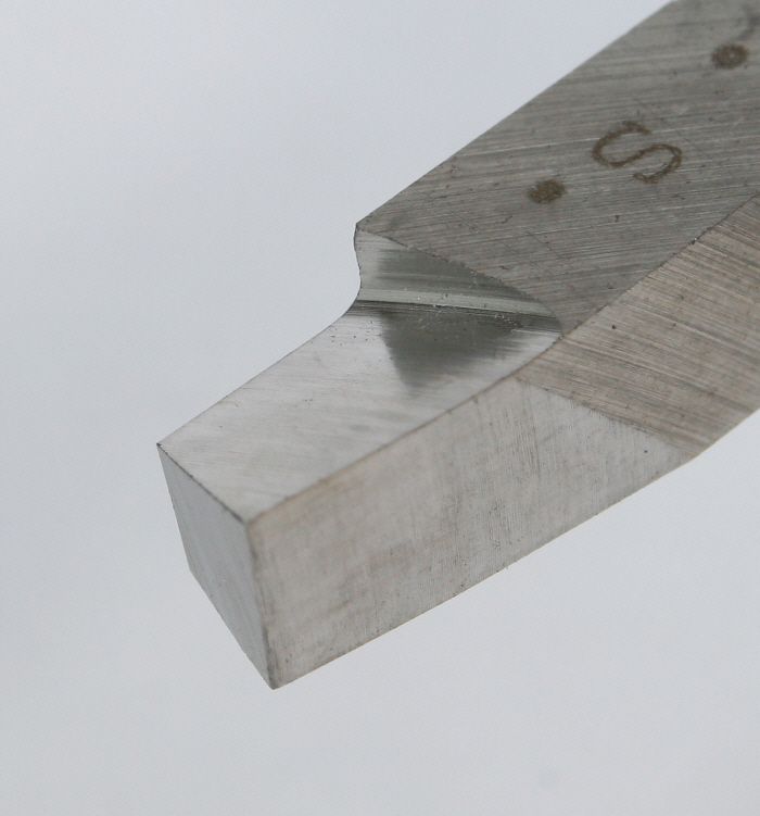

                                            Hard to tell from the glary pic but that does not look like a suitable tool for turning steel. It looks more like a form tool for brass. It appears to be dead flat on top. Tool for steel needs at least 10 degrees side rake on the top surface. And the tool shape with large flat on the nose is what you don' t need.
                                            You don't need special wheels on your grinder to grind HSS bits. The wheels that come standard on common hardware store grinders are suitable. Usually one wheel is coarse for roughing and the other is more fine for finishing.
                                            You need to look up "knife tool" to get an idea of the shape of tool required. I'll see if I can dig something out and post it for you, but Sparey's book "The Amateurs Lathe" is invaluable for this stuff.
                                            Agree with you that the red painted brazed tip carbide tool is not the best for your little lathe. You might try it again with tailstock centre and see. But usually the flat top surface and reduced clearance angles on them require a more rigid lathe than a Myford.
                                            And I wouldn't be too quick to convert to 1/2" HSS tooling. It takes a lot more grinding to make a toolbit. I go the other way and use 5/16" HSS set on a piece of packing strip in my Myford. Much quicker to grind up.
                                            #447264
                                            Hopper
                                              @hopper
                                              OK. Here's a pic of a basic, common "knife tool" used for plain turning of steel as you are doing.
                                              The angle on the top surface is about 10 to 20 degrees.
                                              The clearance angle on the leading edge (the side of the HSS toolbit) is about the same, as is the angle on the front surface.
                                              There is more detail and how-to here **LINK**
                                              Disregard what they say on the link about "back rake" on the top surface. You don't need it on small lathes like your Myford. I never use it on my HSS toolbits, and they will take .100" deep cut and give good finish on finer cuts. So you angle the top surface sideways as in the pic above, but not backwards as in the drawings on the link.
                                              And to start with, you don't need the large radius on the cutting point of the tool as shown in the link. Just grind it straight like in the picture. You can later add a small radius to that corner by rubbing the toolbit on a bench oil stone, the type used for sharpening knives and chisels etc.
                                              Clear as mud? Good. You'll get there. Keep experimenting.

                                                  400rpm for mild steel 1" diameter. Halve the diameter and double the speed. Double the diameter and halve the speed. etc etc.
                                                  Aluminium and brass, about double the rpm for steel.
                                                  Stainless, slow down a bit and see. Maybe a 25 per cent reduction in rpm. I would not mess with stainless at this stage. It can be a PITA. Work-hardens as you machine it.
                                                  No cutting fluid needed for general work on Myford scale. It's nice to extend tool life but not necessary.
                                                  For screwcutting, use ordinary lubricating oil, engine oil, hydraulic oil etc.
                                                  WD40 for cutting aluminium.
                                                  Oh, the other thing with toolbits is to minmize the distance it sticks out from the toolpost. Less leverage = less deflection = less chatter.
