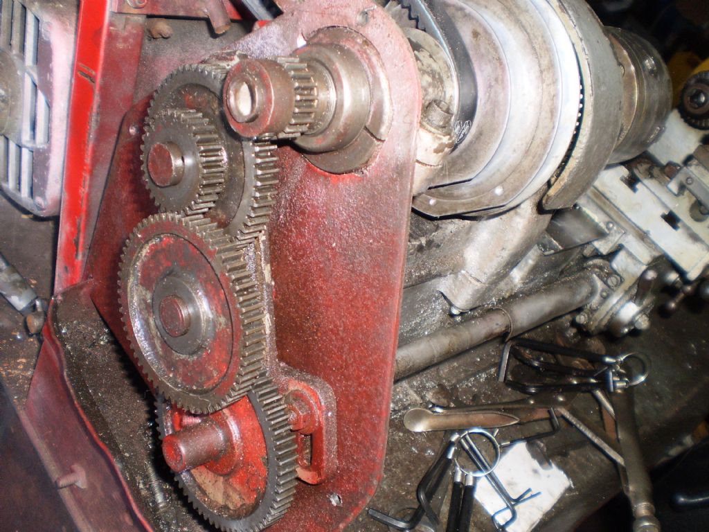

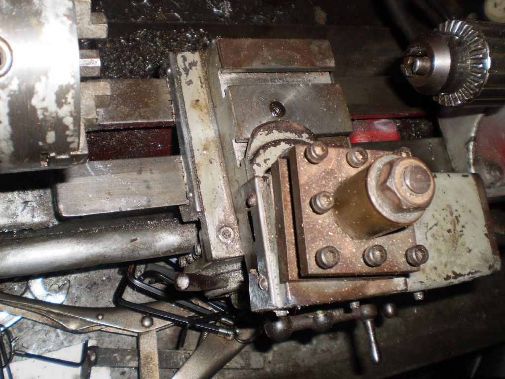

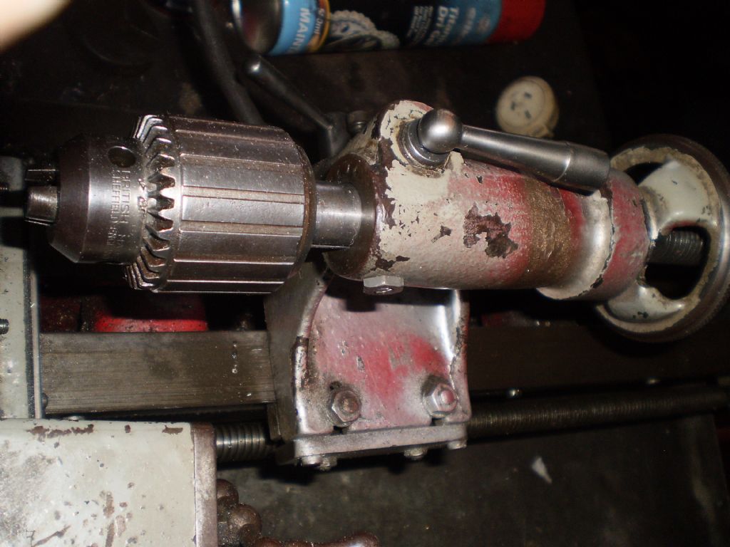

        Hello
        I am new to this site but have just purchased a Small Myford lathe and having trouble tracking down the model I found the serial number on the front of the lathe but doing a search on that has been unsuccessful. So I found your site and thought if anyone knows it will be you.
        The serial Number is L with 874 under it. Any ideas? I need to post some photos and will when I can get a clear shot at it. My lathe is V belt driven and has a forward and reverse switch, also has a back gear. Not sure what else you need to know for an ID. But anything will be helpful

                Like David I think your lathe might be an ML2 which will date back to the late 1930s. The method of attachment of the headstock to the base varied on these models, the early ones were cast as one, later versions were equipped with a detachable headstock held by a single bolt midway along the space for the pulley cluster and two smaller bolts in a line below the front spindle bearing.
                Lathe centre height above the bed varied as well from 3.25 inches to 3.5 inches. Flat belt drive was an early method, vee belt drive became normal later but previous owners may have upgraded anyway so that is not a reliable means of identification.
                One of your pictures shows a glimpse of the motor case which looks like a Hoover. Many left the factory with those motors fitted, they used several suppliers.
                I noted there was no tumbler reverse for the leadscrew which rules out the ML4 models and the spindle has a collar securing the small, 20 or 25 T gear in place with a side fitting screw. Later a more secure joint was made from a 2 BA grub screw end end fitted down the joint face, gear to shaft without a collar
                If you can post some other pictures including the back gear installation it might help pin down the model rather more precisely. Details like the nose thread for example. Is it 9 tpi or 12 tpi and what thread diameter is it?. These things are most helpful, Myford made all kinds of changes as the models developed over the years.

                    Thought someone had just chucked a motor from what ever they had laying around but i thought an old sewing machine like the one on my mother's machine.
