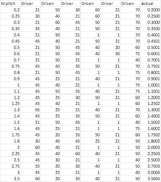

            (Deep sigh) The whole point of this thread is that Myford use a 21 tooth gear as a driver, not a 63 tooth. Do try and keep up wink
            How accurate do you want to be?:
            The above is the table taken from the S7 handbook. The 1:1 changewheels are just a convenient way of introducing the idlers into the Excel spreadsheet. I'm not really worried by the odd tenth of a micron.
            Cheers,
            Rod

              Roderick Jenkins:
              Thanks for the table. The presence of the "Actual" column surprised me as my recollection was that Myfords did not include this (hence, perhaps, the uncertainty as to exactness). Having checked my edition of the manual (No. S.723N), it seems either that you have a different edition or have helpfully included a column of your own derived from Excel.
              Can you please clarify?
              Incidentally, I believe I mentioned the "not exact" point some time ago and it's certainly not new. My understanding is that a 127T gear would have to be involved to achieve theoretical exactness. The inconvenient size of the 127T gear has led to continuing attempts to find closer approximations but, as you imply, this has more to do with mathematics than engineering.

                  Posted by ega on 29/12/2015 09:57:23:
                  Roderick Jenkins:
                  Sorry, I should have made it clearer. I've taken the table of changewheels supplied by Myford and then used Excel to calculate what the actual pitch is using those changewheels for each metric pitch. The Myford table introduces idler wheels for some of the pitches so I have replaced the idlers by a 1:1 ratio, just so that I can use the same calculation for every row – it's just an easy way to use Excel by copying the calculation cell down the column.
                  HTH

                                #218312
                                Roderick Jenkins
                                  @roderickjenkins93242
                                  Confusion reigns. The metric conversion set is for the the gearbox version, which is why it includes a new banjo to replace the fixed geared version on the imperial gearbox. We are talking about cutting metric threads using the changewheels, aren't we? For this, you just need to get an extra 40T and 2 x 21T gears to add to the standard set to cut all the threads shown in my table above.
                                  In response to ega, the actual threads cut using the gearbox conversion set are:
                                  Column 4 is the gearbox setting. Still very good in my view and no use of the 63t gear, which is only used for DP and BA pitches. You can't wriggle out of it that easily John cheeky.  But, as I've mentioned before, I much prefer the 33/34 trick which I learnt from you.  However the ability to use all the various gear options has come in dead useful for setting up leads for helical gears.
                                  Cheers,
                                  Rod
