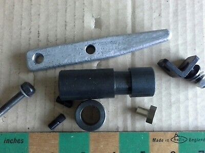

                    Another question has popped up: On the brass (presumably?) block that attaches to the operating lever and engages in the groove on the dog clutch body, is the surface of that block curved to match the diameter of the groove in the dog clutch body, or is it just a flat block that sticks into the groove as best it can?

                      It is curved as you suggest.

                        Thanks EB. On second thoughts, I am guessing it must be a slight curve rather than a close fit to the radius of the dog clutch body, because the block actually travels in an arc as the lever pivots, so a tight fitting curved block would bind. That explains why in the one pic I have of a dis-assembled unit, the block looks to have a slight curve to it but not a tight fitting radius. I reckon I can fake something up that will work on that principle.

                          Here is the one pic I could find of a dis-assembled dog clutch. The slider block does appear to have a slight curve on it. But very hard to tell from the pic. So good to confirm that. Thanks.
