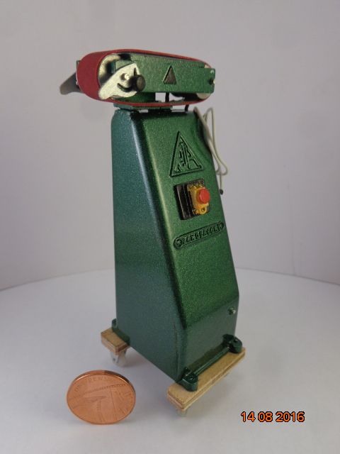

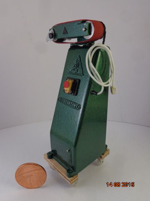

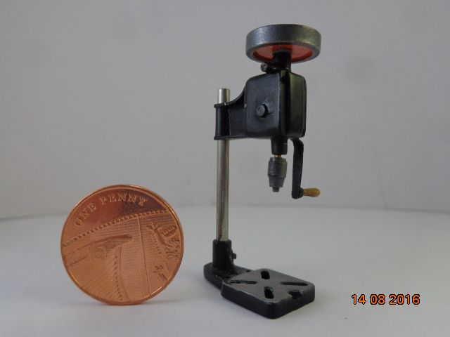

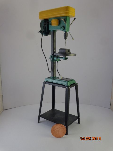

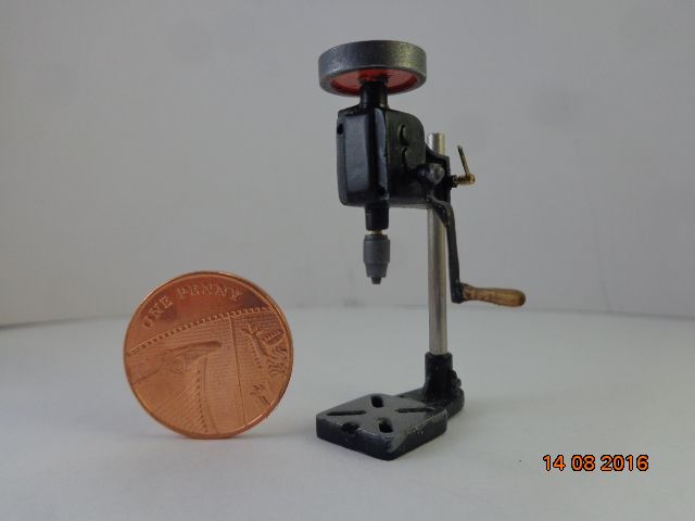

      Hi all, this is my first "real" post just to show my what I do really dsc06919.jpg this is my collection of scratch built machine tools so far (i have started on the lathe not in this image). they are built to a scale of 1/10 and are exact copies of the machines in our workshop/my bedroom (the little metabo drill is in my bedroom/model making workshop) dsc06918.jpg

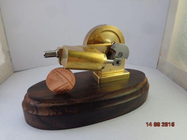

      my first real lathe project was Elmers wobbler engine, fun little engine that really taught me a lot.

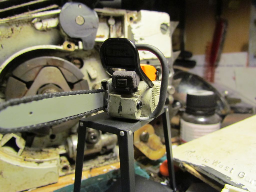

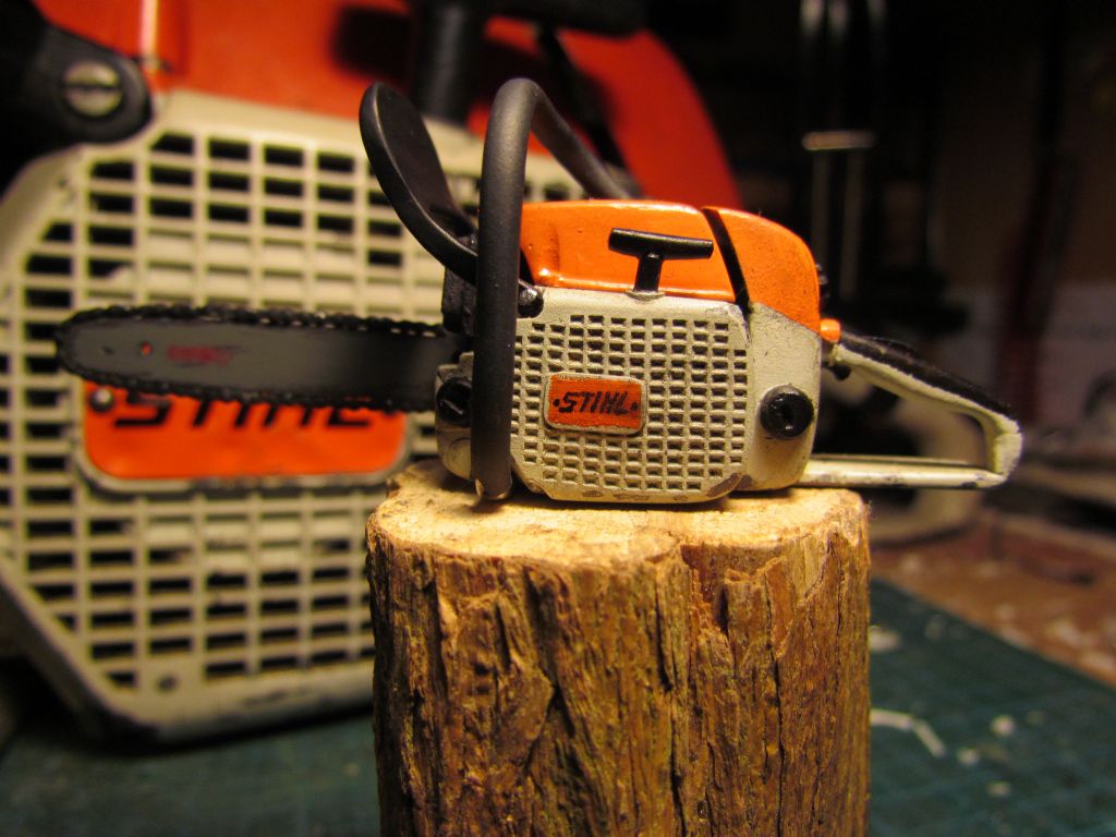

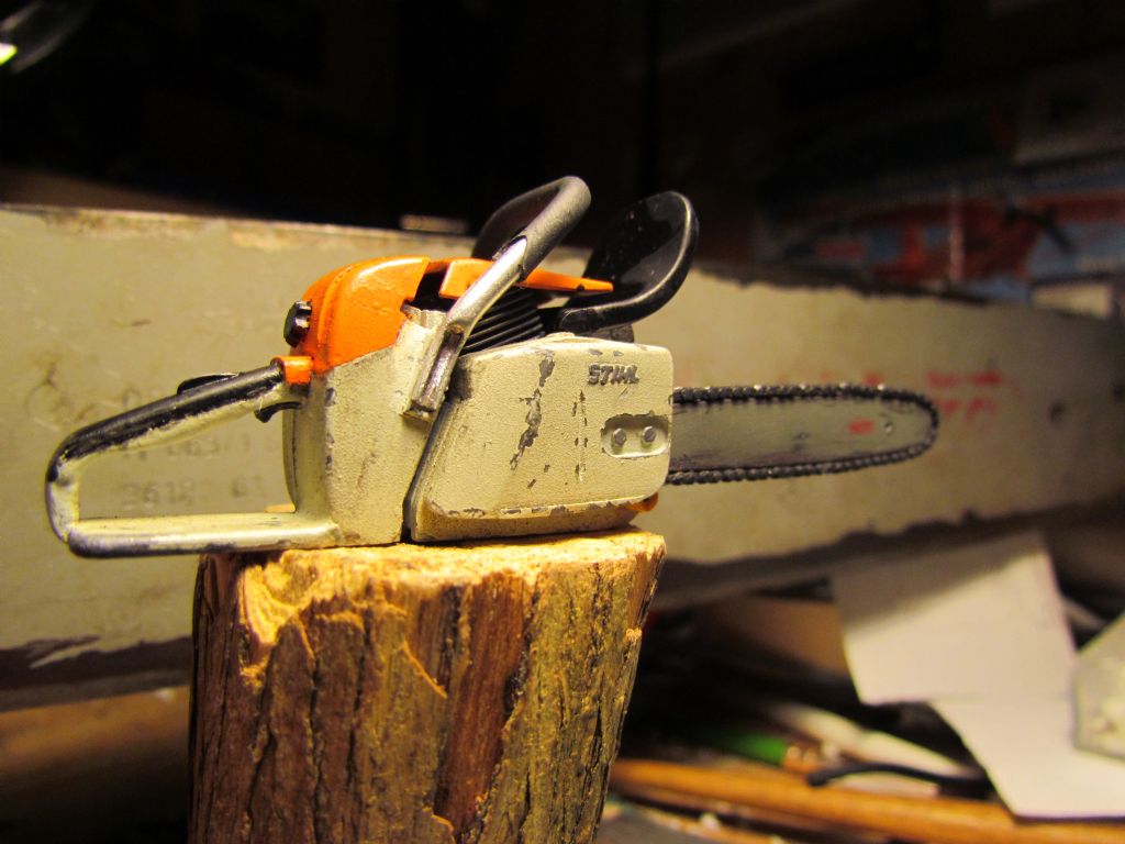

      This was may latest model i have made, a sthil 028 chainsaw, this was my first commission by an artist for a piece she wanted to do. I got the commission by helping out at my granddads lost wax casting business, when she saw my above machine tools and asked if i would make her the chainsaw. i had to make a stamp to punch the mesh type grille on the side(easy peasy with a milling machine and slitting saws) the full size chainsaw was on my desk in my room for about a month whilst i made the model, so you could say i'm a bit odd with a chainsaw and metabo pillar drill in my room but hey ho. Anyway i'm classed as a bit strange at school because my house doesn't have a single games console in it, got far better things to do than play computer games.
      thanks for looking
      William

            Very Nice William, what materials do you use to make the models? a picture without final paintwork can be as interesting to look at as the finished item.

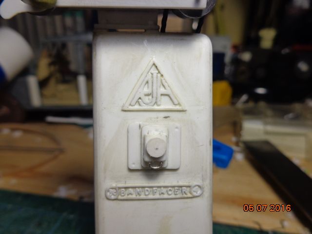

                    Posted by SillyOldDuffer on 17/05/2017 11:21:54:
                    Most impressive. It took me a moment or three to twig that the tools are miniatures. Or are they? Am I actually admiring a giant penny that you made…
                    Yep they are miniatures! Don't have a large enough space to set up a white background for the full size articles or the facility to make a large penny!

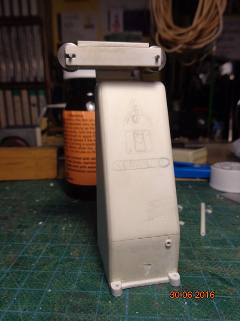

                    All of the machine tool models are made up of:white plasticard (styrene) sheet in varying thicknesses, plasticard shapes (rods,tubes,etc.) brass rod and tube, aluminium, assorted wire, paxolin rod is used for the motors and a few bits of wood. They are all painted with Hammerite and/or Humbrol paint sprayed with an original 1980's Humbrol airbrush.
                    Here are the models without paint

                                                  Posted by William S on 17/05/2017 11:02:37:
                                                  thanks for looking
                                                  William
                                                  William,
                                                  Please add me to your list of admirers
                                                  [ the first name that came to mind was Gerald Wingrove ]
                                                  This is is excellent modelling, and I'm glad to see that you have been 'commissioned'
                                                  … that should start the ball rolling !!
                                                  I would be interested to see a more detailed write-up of the chainsaw model, and also anything you can share about your Grandad's business.
                                                  #298639
                                                    the full size chainsaw was on my desk in my room for about a month whilst i made the model, so you could say i'm a bit odd with a chainsaw and metabo pillar drill in my room but hey ho. Anyway i'm classed as a bit strange at school …
                                                    William
                                                    On this forum I'd say that's normal behaviour, or it would be if 'She Who Must be Obeyed' hadn't put her foot down. I wouldn't worry about what they think of you at school. Everyone is "strange". It's just that the majority put more effort into hiding it.

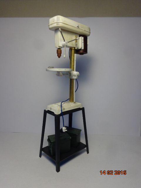

                                                      The pillar drill was the first one I made, after being inspired by the work of Barry Jordan, Gerald Wingrove is another inspiration, after seeing him on a recording my dad did on to VHS of the series, Model Magic by the late Bob Symes.

                                                      Quite useful knowing someone in that field (the flywheel on the wobbler engine i turned out of wax and got it cast by him)
