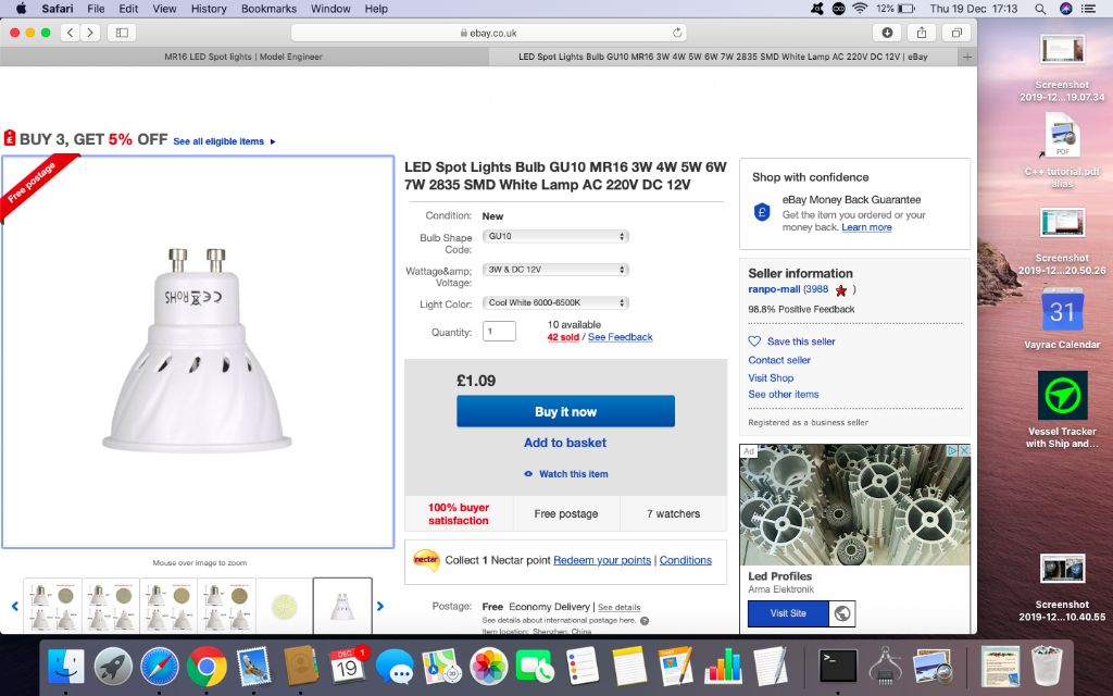

                  GU10 12volt lamps, where have you seen them ? Do they actually make them ?

                                              Speedy Builder5 You may have them all over your workshop…They are not GU10 LED's, as GU10 lamps are all 240 Volt.

                                                    Posted by Speedy Builder5 on 19/12/2019 11:14:34:
                                                    Peter S – yep, I have them all over my garage which has no mains supply, just a battery and solar panel. Plenty on your favourite auction site or armazone !
                                                    BobH
                                                    Please could you provide a representative link, Bob
                                                    There is clearly some misunderstanding of your situation [possibly by me] but: GU10 is a mains voltage fitting, and I am quite sure that it would be both dangerous and illegal to sell 12V lamps that used it.
                                                    Thanks in advance
                                                    #442403
                                                    Speedy Builder5
                                                      @speedybuilder5
                                                      And here we have some Scotch Mist.  Look at the drop down box where it says 3 Watt 12v DC:-
