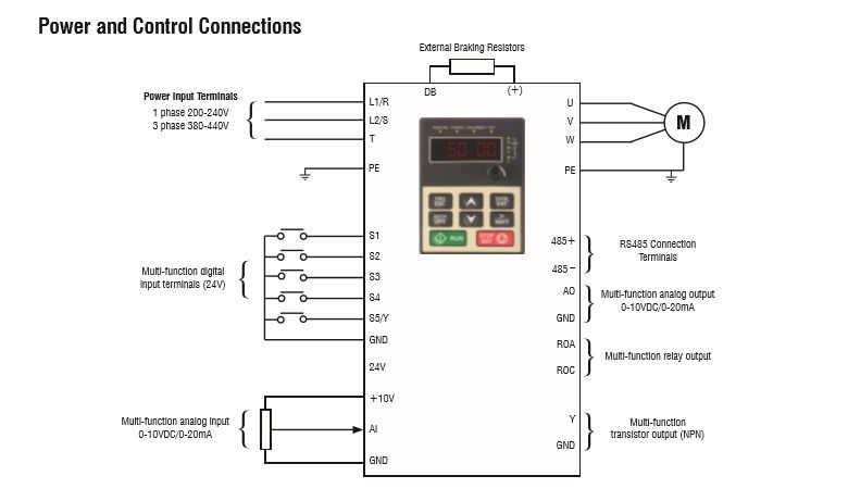

                    I don't want to hijack the original poster but is there a way to combine an emergency stop to a lathe controlled by an inverter/electronic pendant? I'm just saying because I don't have one and ideally I should.
                    The stop button is a little obscure for when my hand might be trappedindecision

                        Mitchael-w,
                        You can probably connect an emergency stop button in series with the stop button on the pendant. This is assuming that the stop button in the pendant is an normally closed contact type. To be sure you would need to provide w wiring diagram of the pendant and how it is wired to the inverter. Also a copy of the page of the inverter manu manual that shows the control input connections. would be helpful.

                                  That is what my inverter terminals look like, so it's a bit different to how they name the terminals on the jaguar.

                                    We now need to know the functions that are configured on the multi function inputs S1 to S4 and S5/Y. We also need the schematic of the pendant so we know which switches / buttons are connected to each of the control inputs.

                                      I've had a look through the manual of the IMO idrive 2 inverter, but i can't find any reference to a facility to emergency stop on it, i'm doubtful as to whether my particular model is able to do this unfortunately.
                                      Guess that's what you pay for on an jaguar.

                                        Ok i'll see what i can do Les, however, i don't think i ever got a circuitry diagram nor can i find one online however, i can open the thing up and see if i can make sense of the spaghetti inside, this is the best thing i could find on "what does what" for the pendant in relation to the inverter.

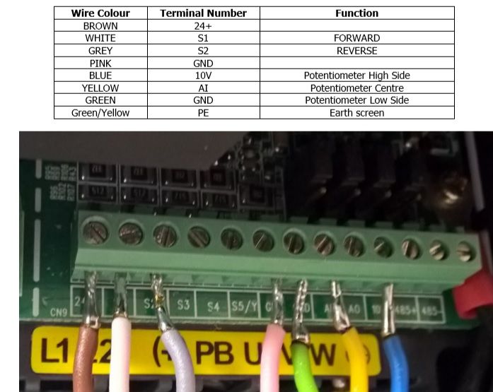

                                            I just took so long because my computer seemed to have a miniature fit over transferring the photos (curse you, windows app; TWINUI) For now i'm going to have to review everything thru paint.

                                                Does the pendant have a three way switch (Forward, stop, reverse) or does it have three buttons (Forward, stop, reverse) ?
                                                John makes a good point about having the emergency stop in conjunction with an NVR in the AC supply to the VFD I think which way you choose to do it is personal preference. It is normally not recommended to remove the power from a VFD when it is driving the motor but safety is more important than the risk of damaging the VFD. I have chosen to tell the VFD to stop the motor. The reasoning is this. I think the risk of a fault occurring on the VFD that prevents it stopping the motor at the same time as you have an accident is very small Also the VFD stops the motor quicker than it just coasting to a stop. You can get some emergency stop buttons that latch in the off position. You could use one of these without an NVR providing the contact rating was good enough.

                                                  The image above shows stranded cables that have been tinned before being clamped in the connector block. I believe that this is no longer considered good practice. The cables may be tinned at the very tip only to maintain shape but no further. Apparently the solder wicks along the cable under the insulation and may lead to cracking especially if vibration is present. The length of bare wire is also too great, any flexing may lead to a short. Crimp ferrules on the cable ends are now I believe the preferred method.

                                                      Posted by Journeyman on 31/03/2017 22:03:41:
                                                      I would agree, I've definitely heard people talking about using crimps or connector blocks for AC power, although those wires in particular are simply part of the wiring for the pendant and therefore have no direct connection to the power line, i'm not sure i've heard anything about vibration before but this is a stock photo from transwave converters, and that's the way they supply it.
