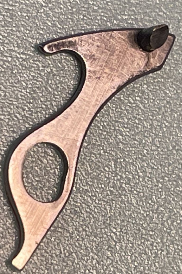

                  Example of missing part: Minute Recording Jumper
                  Edited By Graeme Yorwarth on 04/02/2023 10:06:50

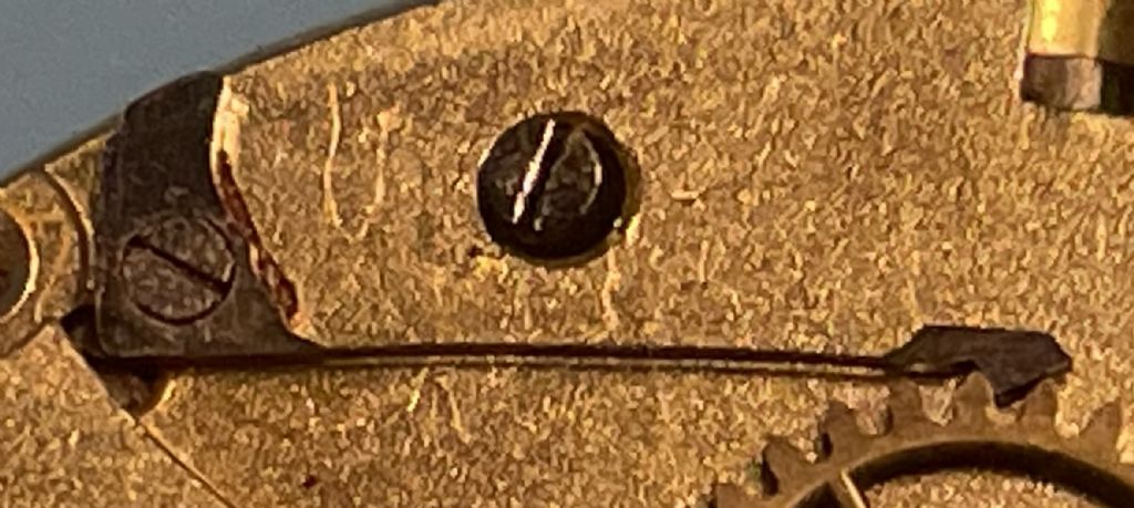

                    Example of missing part: Column Wheel Pusher ?
                    Here is the peg that I need to manufacture on the lathe, it's diameter is 0,22mm
                    Edited By Graeme Yorwarth on 04/02/2023 10:13:20

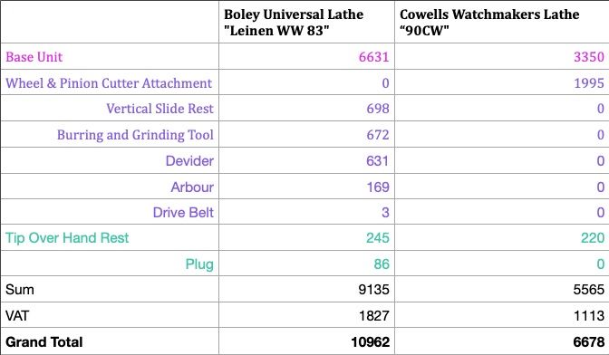

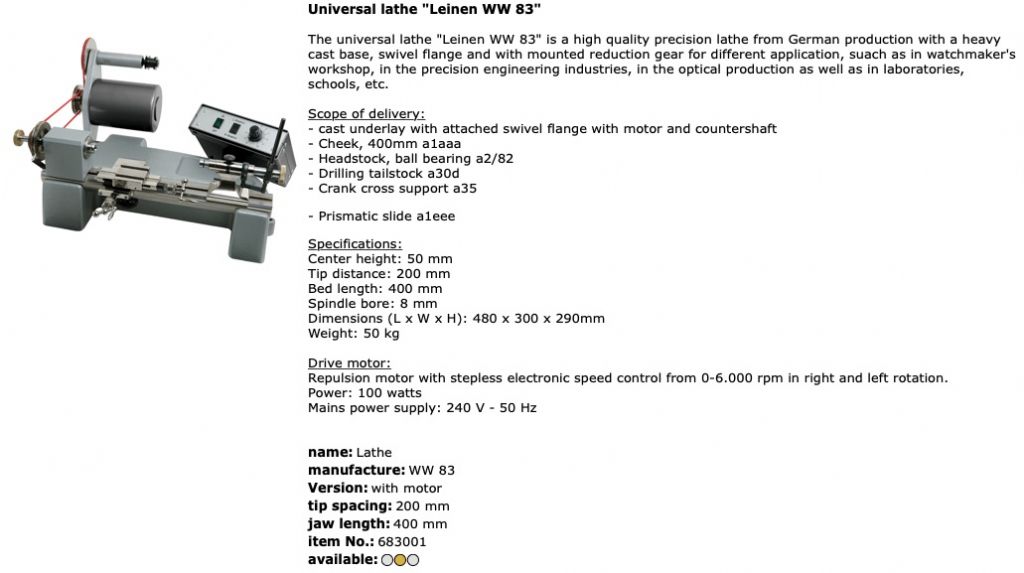

                        #632498
                        Graeme Yorwarth
                          @graemeyorwarth55263
                          #632499
                          Graeme Yorwarth

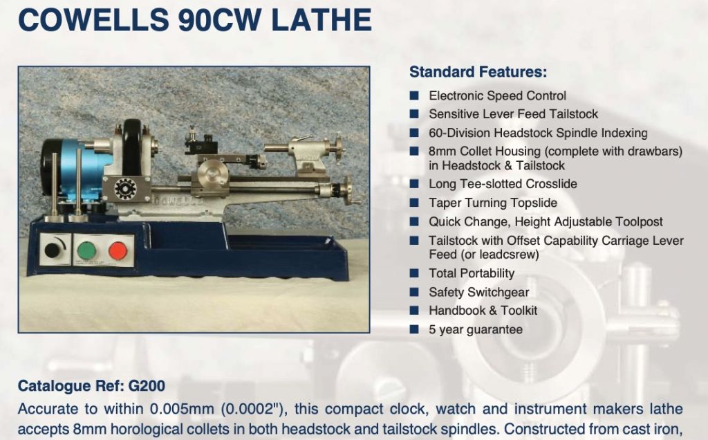

                              Hi,
                              What did I get…..
                              Ordered the Cowells 90 CW with a hand rest for graving.
                              Quite excited, but wish that they did the foot operated speed control.
                              Graeme
                              #634289
                              Hollowpoint
                                @hollowpoint
                                Posted by Graeme Yorwarth on 18/02/2023 22:01:18:
                                Hi,
                                What did I get…..
                                Graeme
                                I think that is a good choice for your use case. It should serve you well.
                                Since the speed control is electronic on the 90cw, controlled by a potentiometer, I expect rigging up some kind of foot operated speed control will be possible.
