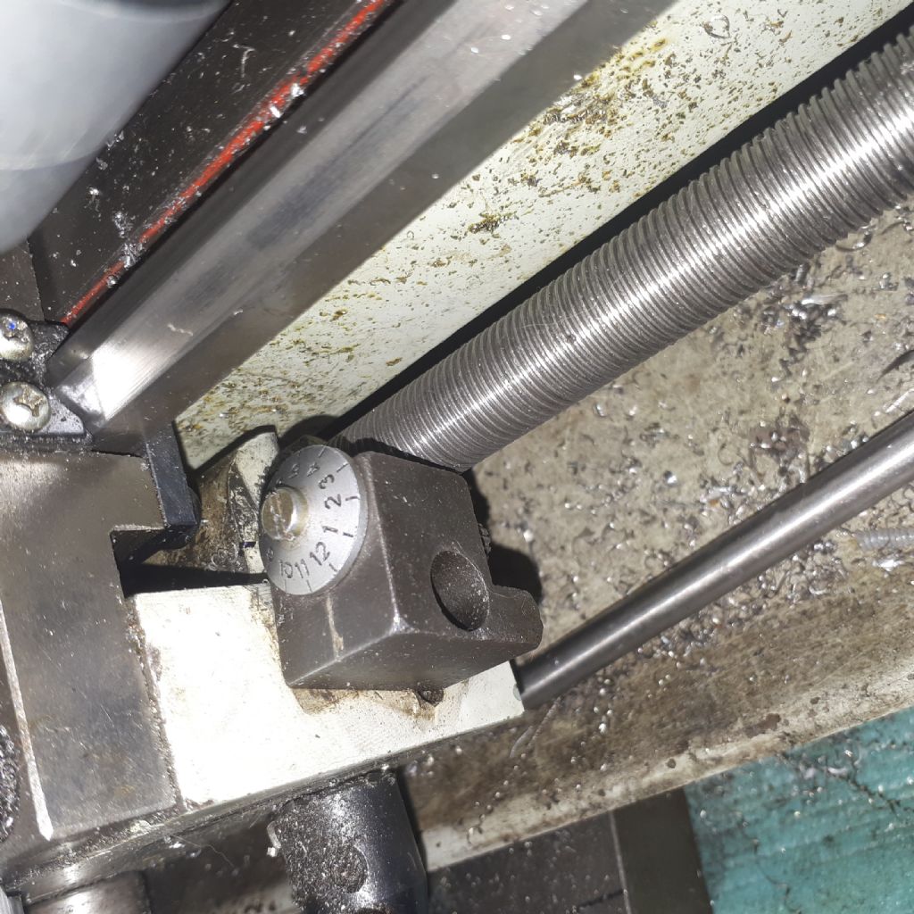

      Hi everyone .complete newbie to this. I have bought a Chinese mini lathe,and in the accessories bag are two splined dowels. The instructions don’t mention what they are,where they go or what they’re for. Anyone come across them??? I can’t find where to add a picture on here

            Hi Jeff
            I suspect they are for the threading dial, you should have three, one may be already fitted under the dial marked 1 to 12. They have different number of splines depending what pitch thread you are cutting.
            Cheers Michael.
            #391938
            Michael Horner
              @michaelhorner54327
              Hi Jeff
              The disc with the numbers, the splined shaft fits underneath and meshes with the lead screw.
              Cheers Michael.
