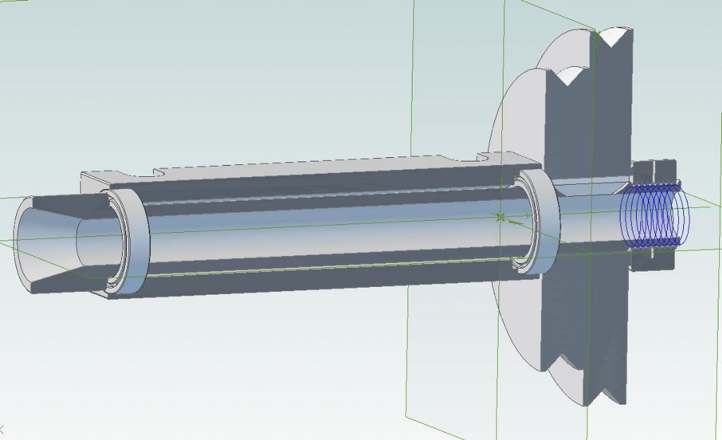

      I want to make a small belt driven milling/drilling spindle to accept 8mm watchmakers collets. I envisage making the body from 3/4" mild steel square stock.
      Has anyone out there made one of these or similar?
      I would welcome any advice regarding bearings etc and preventing any play along the spindle axis.
      Many thanks
      Steve

          Given that you probably want at least a couple of mm of spindle around the collet body at a minimum then a 12mm spindle, more if the head is to fit without excess overhang. into a 3/4" housing does not leave much room for bearings, would probably have to be plain bronze to keep them thin enough.
          #374030
          Steve Crow
            @stevecrow46066
            I was planning to use a 12mm spindle. The 3/4" dimension is not set in stone – I could go up to 1 inch square stock.
            I realise I won't have much space so I am thinking about oilite sleeves. What concerns me are the thrust bearings to prevent play.

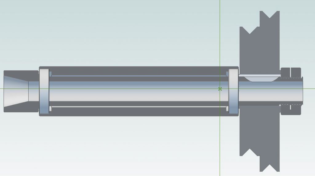

                                      Plenty of small lathes just use a pair of ballraces for the spindle and end play is dealt with by threading the end of the spindle so a nut/nuts can be used to take up the play.
                                      Assuming a 12mm dia spindle with a larger "head" to accomodate the collet taper then you can get thin ballraces 12mm ID and 18mm OD which you should be able to get into say a 20mm casing, could even narrow it down in the middle if you want to get it into a toolpost. This would mean a small amount of overhang due to the bearing not being around the widest point of the collet.
                                      If you wanted to have the whole of the spindle within the bearings then you would need say a 15ID x 24OD thin bearing at the tapered end but could still use the smaller 12mm ID at the far end. Body would need to be 26mm or 1" at a push but could still be thinned down for most of it's length to make it easier to clamp but I would think one flat face would be a good idea.
                                      The "head" would bear against the inside of one bearing and your fine threaded nut against the one at the opposite end. Spindle protrudes beyond the nut so your drawtube can bear on the end of the spindle

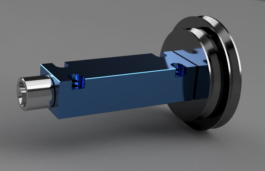

                                                    Had a quick sketch to illustrate what I suggested earlier using the thin bearings and along the lines of the 3/4" and 1" spindles in the book but with a hollow spindle to take WW collets and drawtube. I can't really see the point in having a round body and then a big clamp round it so you can hold it so went for 20×26 which allows for M4 fixings down the side though square would do if you wanted to keep it compact as per the opening post.
                                                    I even did it with an Ali body so Neil can practice his anodisingwink 2

                                                      Posted by JasonB on 02/10/2018 11:40:40:
                                                      Now we know how you 'make' all those stationary engines so quickly
