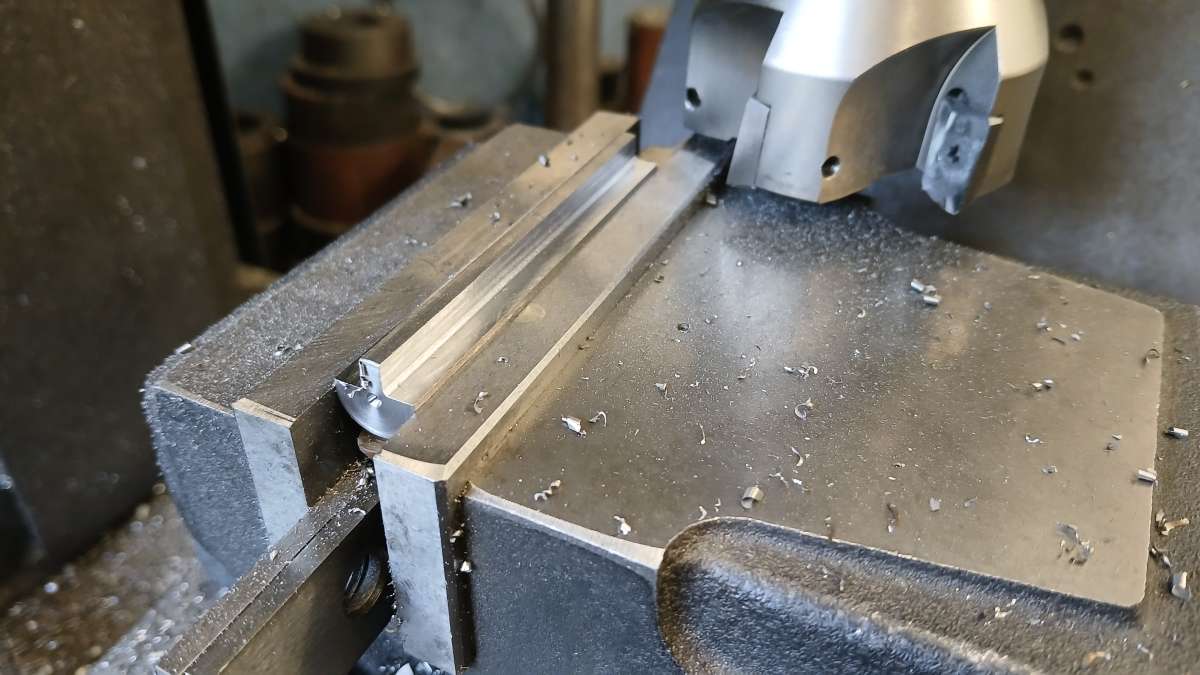

          Depends on the shape of the insert and it’s use.
          If it is a facemill and takes say APMT or APKT type inserts then 0.8mm is common going upto 2.0mm but you can also find them down to 0.2mm particularly those for aluminium and non ferrous. Have a look through these for starters
          If it is an older one that clamps a simpler shape insert then you can get down to 0.2mm
          Having a few diffenten sets of inserts with different radii can be useful just like they are on the lathe or with solid milling cutters if you want to leave an internal fillet for strength or in my case mostly for looks when creating fabricated castings like the fillet on these parts that are half way through becoming “+” shaped
          20240915_082942
