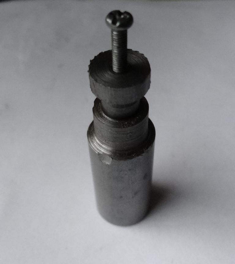

                                        Variation of advice already offered by others. Make a pillar that can be clamped into the mill's vice, tapped to allow a carrier and/or workpiece to be rotated against the side of a milling cutter. dsc05959.jpg
                                        Take care – the thick washer in the photo was damaged by a grab. Beware of fingers – take it gently, don't climb mill or use large diameter cutters that might allow a small job to be pulled inside the helix.
                                        Not tried it myself, but a more elaborate version of the pillar fitted with length of hacksaw blade bent in a circle, can be used to index a gear-wheel.
                                        Nice thing about owning a mill and a lathe is you can make things to make things. I often make jigs or fixtures to hold or support work during awkward cutting operations. For example, this aluminium block was made to put a filleted half-flat on a long brass pin.

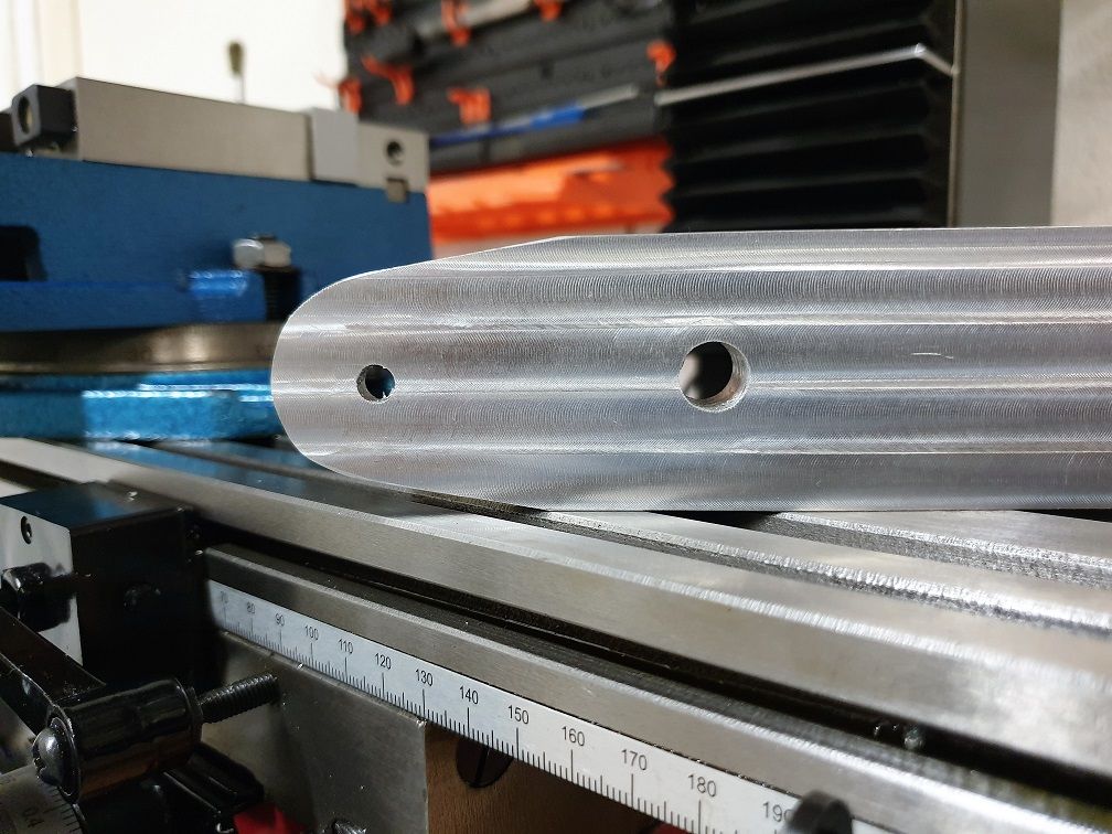

                                            Roy Garden
                                              @roygarden83469
                                              Gents, I'm profoundly grateful for the advice, thank you all.
                                              Through some budding bodgineering (which is what I aspire to) and using hints and tips from this thread, I've kind of got close to what I was after.
                                              The "nail it to the table, and spin it round" advice kind of covers most of the equipment I currently have.
                                              The "File it, it's faster and easier" Well, I have a car, driving to get a bacon buttie is fast and easy, flying there is a pain in the butt, slow, unreliable, fraught with wasted effort, but good fun ! (99 times out of 100, I'll take the easy option, but when it's new . . I'll go with the wasted effort just for the experience)
                                              Can I file? Yes.
                                              Do I want to file? No, that's why I bought a belt sander.
                                              (Tho, having said that, I've never heard of using bearings whilst filing, Can I get a link for how that works? )
                                              I went with the "Pin through a hole and rotate in the vice" method, Sadly, a long (ish) piece of work and a low vice meant I managed very little of the curve that way, but enough to get a "feel" for the shape, 5 minutes on the belt sander and, from a distance, with yer glasses off, in low light, it kind of, looks ok.
                                              Probably 4 hours time playing with the mill today, I think the finish looks good (it's what I wanted to see)
                                              I'm discovering that "machining" is probably best done by fairly accurate sawing, finished off by machining the bits the saw can't do and providing a surface texture.

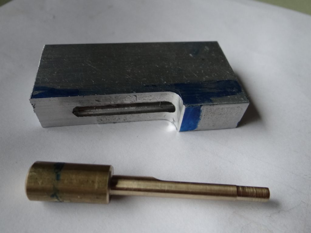

                                                    Nigel Graham 2
                                                      @nigelgraham2
                                                      On thin plate-work, and assuming matching radii, I often use a washer as a filing template rather then revolving button.
                                                      It won't work for thicker, quality pieces like those connecting-rods… unless your filing is rather more accurate than mine!
                                                      Unless you need to use filing-rollers directly on the work-piece very often, they could be simply of mild-steel and allowed to spin on the shank of a bolt (preferably to a screw), held by lock-nuts tightened just enough to allow free movement.
