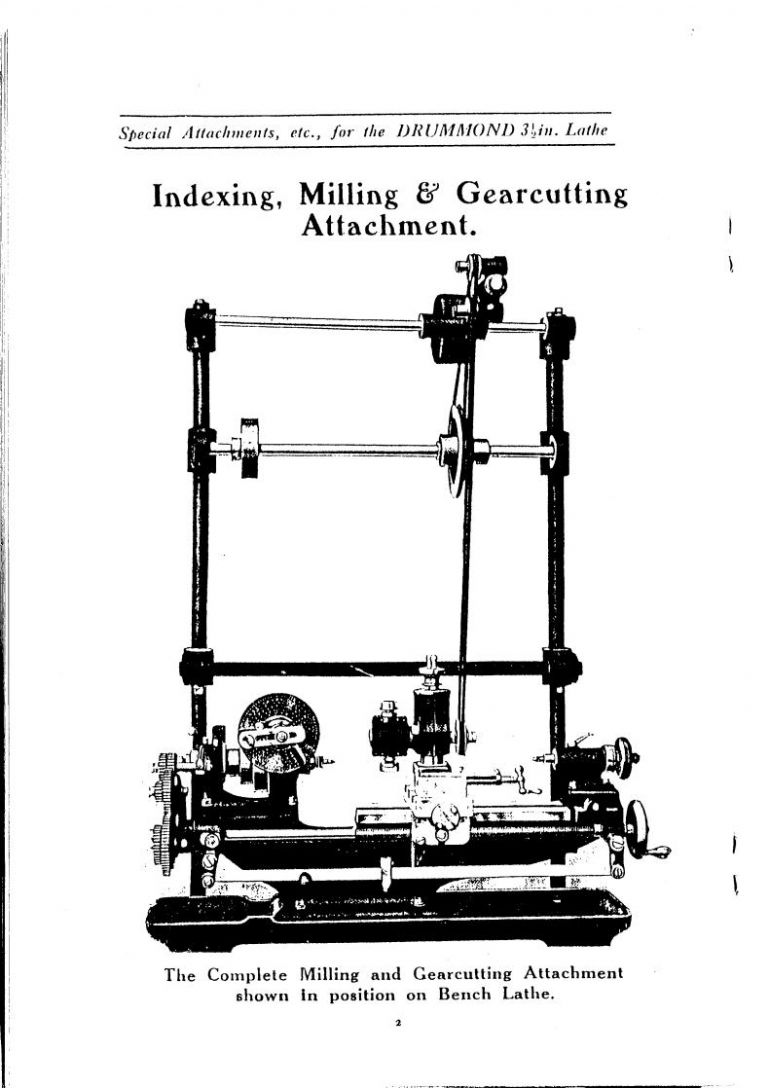

                Ady1
                  @ady1
                  When Drummond did it the whole gubbins cost more than a new Drummond lathe
