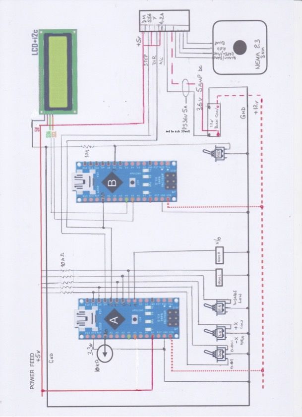

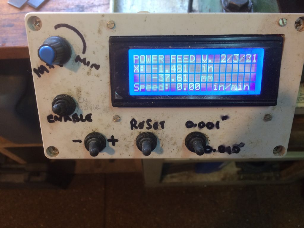

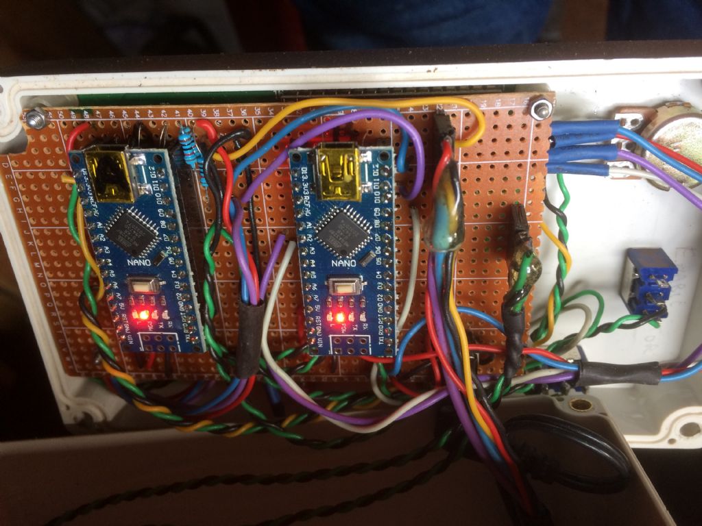

                power feed 1.jpgpower feed 3.jpgpower feed 2.jpgAs stated, several projects. I wanted a display to indicate where on the 'X' axis the table was, so I used some ARDUINO code from the net (Saunders & Reig) and ELECTRONOOBS and modified them to my own requirements. [apologies if I have miss quoted authors].
                Basically I have a pair of Arduinos, one which controls the stepper motor and the other for the display. The advice I was given was that a single processor didn't have the speed to doo both tasks.
                The "clutch" for the lead screw is just a simple pin between the timing wheel and hand wheel. The piece of wood is a crude guard to keep chips away from the toothed belt.
                Ps,  this is fitted to an old Warco Economill.

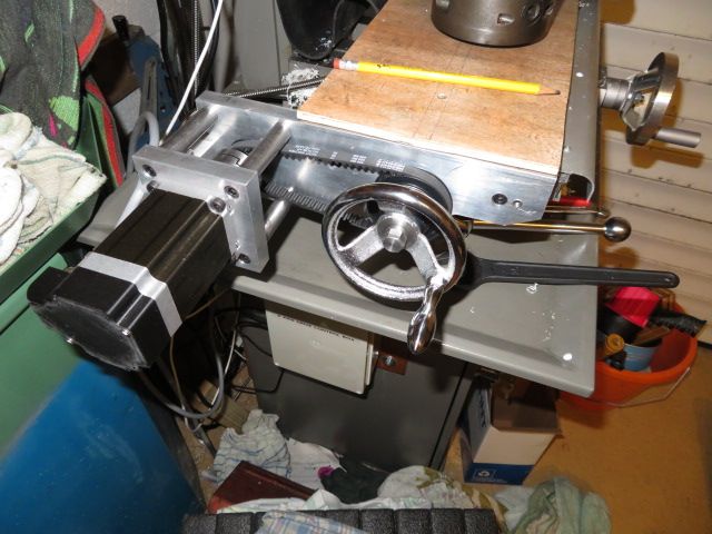

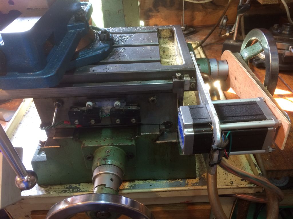

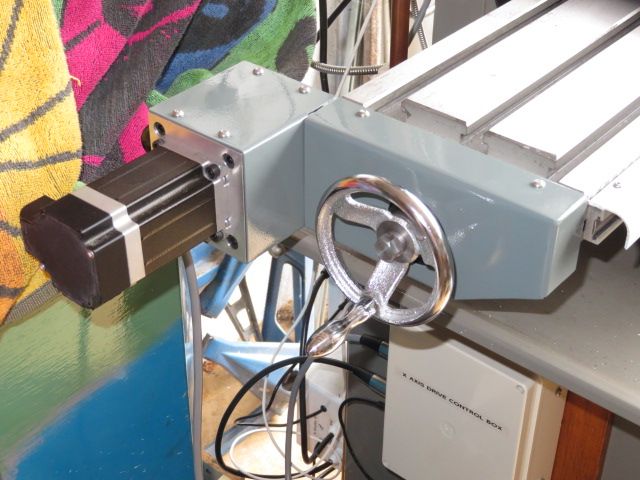

                  img_2561.jpgimg_2523.jpgPeter
                  Here are some pictures of my X axis drive fitted to a Chester Champion V20 mill. It uses an Arduino for control purposes, a simple design compared to that of Speedy Builder 5 above.
                              Though it complicates the wiring, using a second Arduino to drive the display is a good idea.
                              The problem is the display rather than the microcontroller, because the Arduino 'blocks', ie stops and waits until the display gets its act together and does it's stuff. LCD displays in I2C mode are slowest, 4-wire much better, and 8-wire parallel the quickest but they're all slow compared with writing to USB or a serial comms connection. It makes sense to have one Arduino blast data to another, and have the second Arduino sort out the display.
                              A while ago Duncan Webster and I collaborated on a Dynamometer project and looked into improving Arduino performance in some depth. On the dynamometer, display delays limit the maximum RPM that can be measured and/or accuracy. (Be nice to measure RPM with more than one pulse per revolution.)
                              Our cure was to stream the data to a PC over USB for off-line analysis, and to send edited highlights only to the onboard display. This approach isn't OK for all applications.
                              USB/Serial can cause trouble too. If USB speed is important, it pays to choose between the various Arduino boards. For example Uno USB is relatively slow and primitive, whilst a Mega is smart and faster.
                              I've recently been experimenting with the new Raspberry Pi Pico, a £4 board with two fast CPU's on the same chip. Each is about ten times faster than an Arduino Nano. In theory, I ought to be able maximise throughput by collecting data on one CPU whilst the other manages the slow display. In practice, using two CPUs is slower than one! Ho hum, something is wrong… At least Speedy's circuit works!

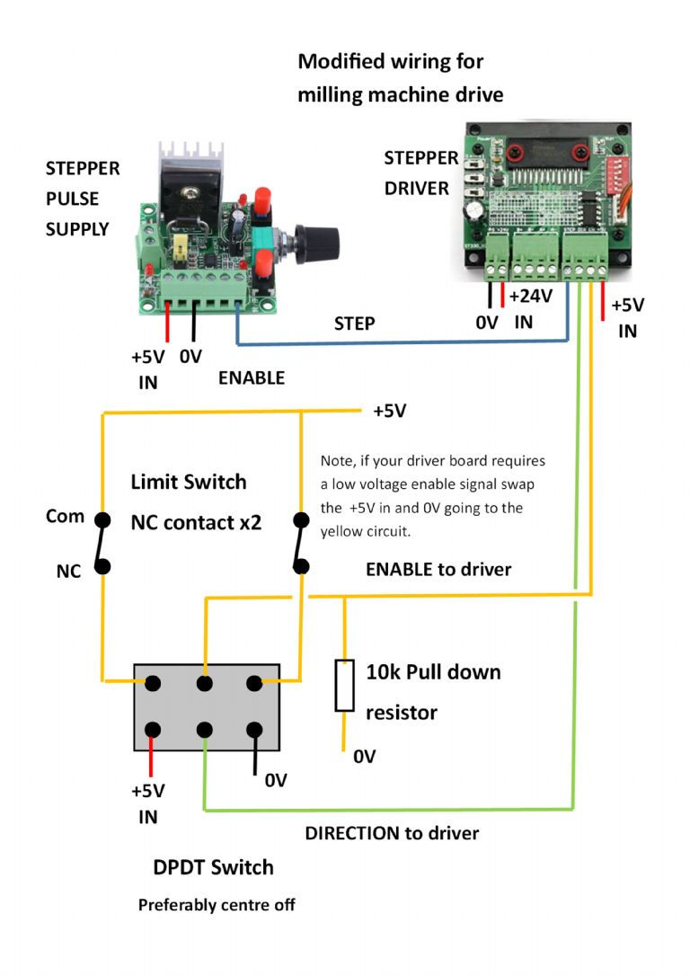

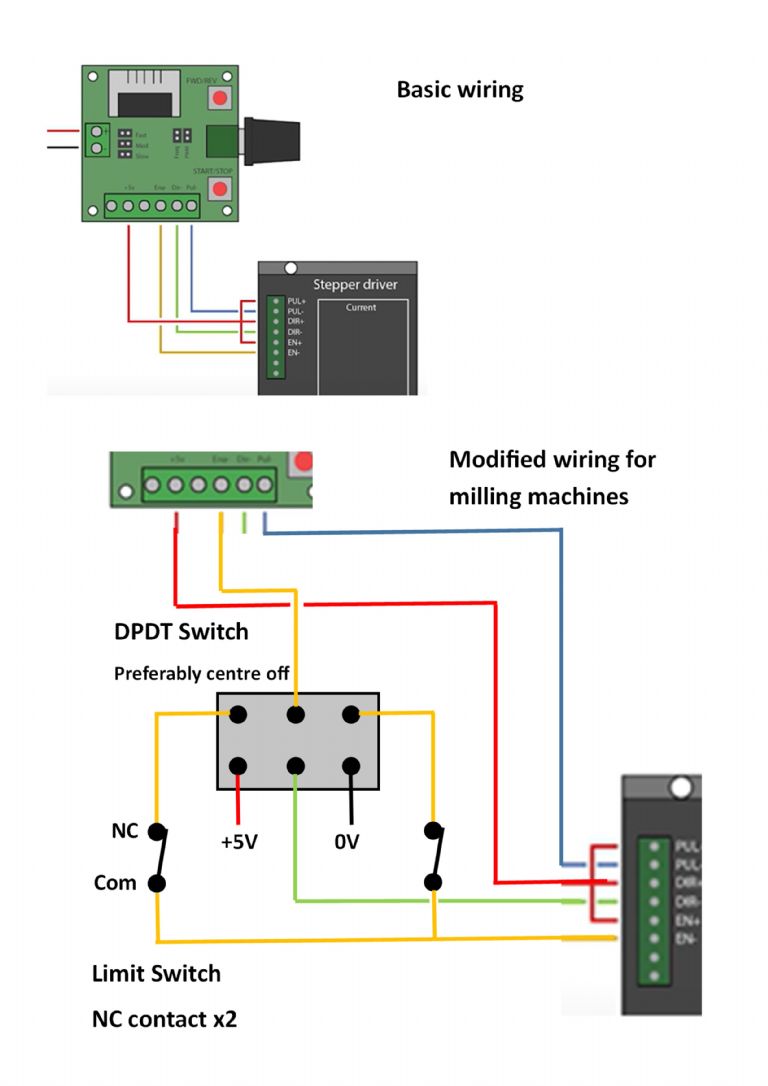

                                    If anyone wants to know what's needed for a simple stepper drive on the electrical side this is something I put together for someone else.
                                    Martin C

                                            I have had a think about the circuit I posted on 08 Oct and modified it. I then cobbled together a simulation of a milling machine table with bits and pieces I had laying about. The power supply I was using has an always on fan so sorry about the background noise. I found that the pulse signal was present at switch on and did not require the start switch to be pressed to make everything run.
                                            Martin C
                                            Edited By Martin Connelly on 22/10/2021 16:43:01

                                              Martin, I found that crashing into a microswitch stop at end of travel was a bit severe. By using a microcomputer, you can slow the stepper motor down thereby reducing the shock of a heavy table attempting to come to a dead stop. Then whilst you are about it, add the jog function,
                                              Bob
                                              #567783
                                              Martin Connelly
                                                @martinconnelly55370
                                                I didn't have the parts to do it but in theory you can have a three position switch for low, medium and high speed to replace the jumper on the pulse driver board since they share a common ground connection. I think if you had a table heavy enough to cause a shock when the microswitch operates then you wouldn't be using stepper motors. I also would not expect such high speeds on a small machine since for a machine with a relatively short travel there is no real need for very high speed travel.
                                                This is just a how to for people who want to use a stepper motor for power feed on small machines.
                                                Martin C

                                                    just a note to the above, if the stepper is going full pelt and you crash into the stops, there is a lot of inertia stored up to be dissipated into the tooth belt drive.  With a micro controller, you can reduce speed progressively on hitting the stops. Ie:-  stop the stepper motor within – say 1 revolution ?
                                                    I guess that you could also monitor current consumption of the stepper motor to detect a crash into the workpiece.
                                                    Bob

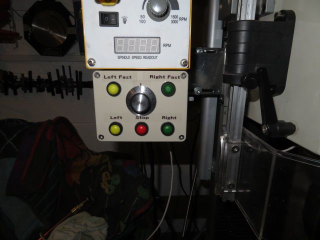

                                                      Some 15 years ago I bought a Cincinatti Toolmaster turret mill. It had a fancy power feed system with rather special motors. One motor packed up and the replacement was about £1500.
                                                      I grafted in the largest available stepper motor from Mr Arc Euro Trade and made up a simple 555 timer pulse generator (circuit from the Brabani books). I made up two 6 way rotary switches with a matrix of resistors to give ABCDEF and 123456 so 36 different feeds. Plus “straight through” for rapid. It is still working fine.
                                                      The control panel featured in my article on Lasertrans in MEW, again some years ago.
                                                      Happy to give more details if required.
