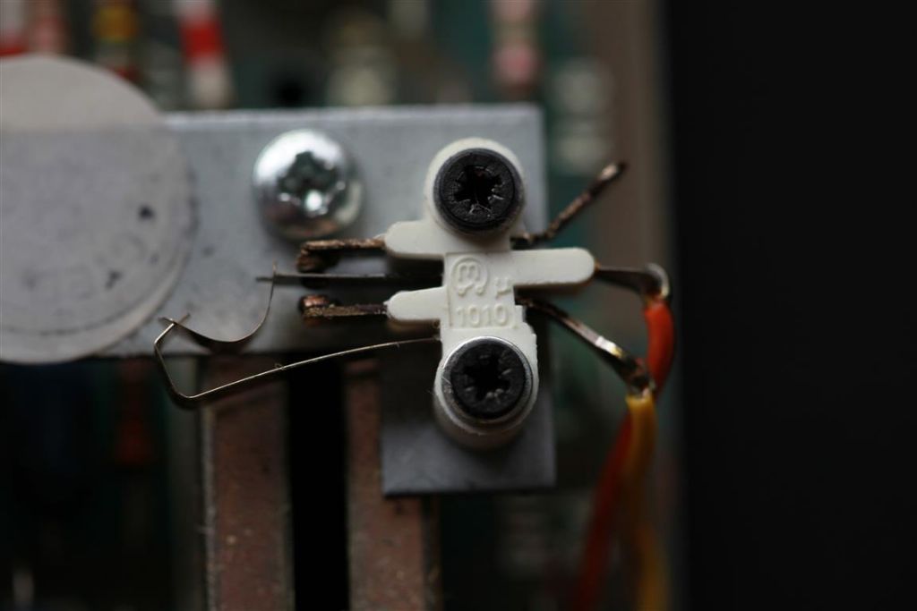

        Can anyone identify this micro switch ?
        i have lots of these all faulty because the spring has done a runner

        Brian G
          @briang
          Marquardt 1010 series. Out of stock at RS though Marquardt
          Google image search for 1010 microswitch brings up plenty of them

          Ian Parkin
            @ianparkin39383
            brilliant Brian
            now to find some in stock somewhere

            Ian Parkin
              @ianparkin39383
              Hmm lots availble but at high prices
              Mouser came up trumps though at a reasonable price for 10 switches
              but only shipping option  is £12 ( ouch)
              Many thanks to Brian

                  Jeff Dayman
                    @jeffdayman43397
                    Hi Ian, If possible, I would recommend changing to a modern enclosed microswitch. I have used Omron's D2F series in many projects with great success. About 1 UK pound retail, probably 50 p or less each from an Omron distributor in UK. Many styles of lever and terminals available, several operating forces and volt / amp combinations up to 5A at 250 VAC. These are good units with small size high performance and quality at a good price. No connection to Omron except as a very satisfied user. (if you still use a computer mouse chances are it has two D2F's in it, or a cheap knockoff of one – billions of them in service worldwide)

                        Ian Parkin
                          @ianparkin39383
                          Jeff
                          they are fitted in this piece of av equipment
                          and theres 7 of them fitted in each one
                          made in Germany in the 70’s and 80’s by kodak
                          its really tricky to retrofit new styles of switch
                          but as i said they all seem to lose the spring
                          they only carrying small currents at 24v

                                peak4
                                  @peak4
                                  Posted by Ian Parkin on 01/07/2020 20:54:51:
                                  Jeff
                                  Maybe use a short length of clock mainspring with a couple of holes either punched or drilled through in a simple jig.

                                        Martin Connelly
                                          @martinconnelly55370
                                          You can buy small long lever microswitches that I think would replace these if the lever was bent to suit.
                                          Martin C
                                          RS part 0150710 for example
