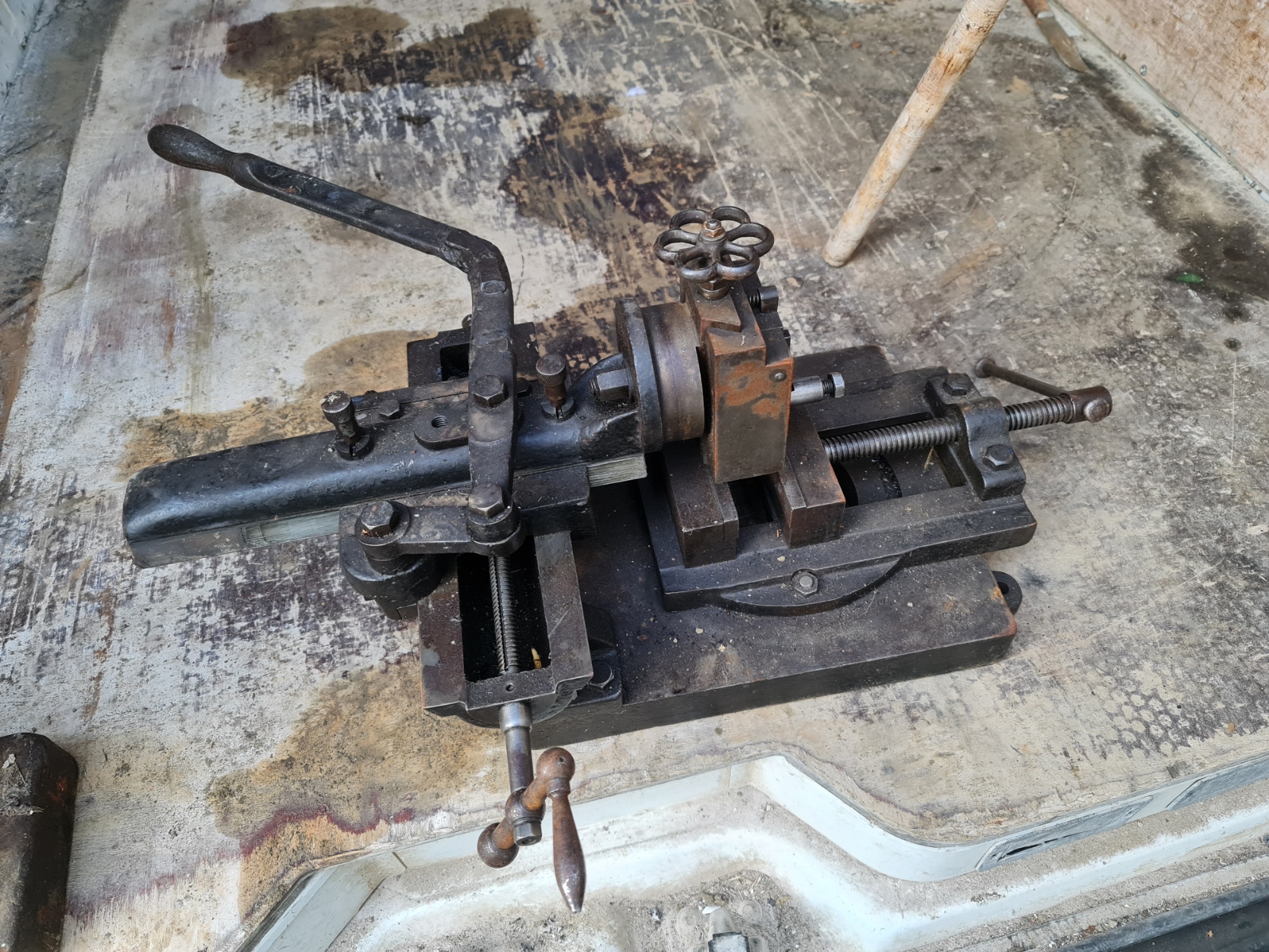

      There is a flea market nearby and every Sunday I see this nice manual shaper. I like it but I can’t agree with the seller on a decent price. Anybody used such a machine? It looks interesting to me.

        At first glance, this little shaper has very limited horizontal movement (headroom) Sonic – so may have been for a specific task or just some one’s home made ‘these parts are available’ job. If you want a small hand shaper an Adept No 2 or Cowells might be a better choice.

            A decent price would be about £10 (if you wanted the parts for restoration or some other project).
            As stated, a home made lash up, virtually no travel on the z axis, no auto feed on the x axis, cant see the state of the clapper. No dials on the feeds. Rubbishy looking  drill vice and the ram looks fairly well worn. I think you would be very disappointed when you got it home and attempted to use. Save your money for a good condition small shaper, if you feel your workshop is incomplete without one.

              ..very basic, but looks like bolted-up construction, so probably possible to change the configuration.
              Slow work with a limited envelope, but might be a useful little slotter at the right price.
              The problem with adapting ‘less-than-ideal’ tooling is whether the end result is worth the trouble & time invested..
              ..what it really needs is some way of accommodating different heights of workpiece, see examples linked to here;
              https://www.lathes.co.uk/adeptshaper/index.html
              ..maybe you can find a big slotted block or couple of substantial angle plates at the market..

                        It does look as if made from salvaged parts, but perhaps that was genuinely all its builder could do to give himself at least something to make flat bits on.
                        The cross-slide looks as if from a Drummond manual shaper (I have one), where it is on the knee this machine lacks.The Drummond’s ram slides are fixed, machined in the body itself. Some shapers were made in that configuration, the ram rather than table moving across, though.
                        The ram is from some other machine; the clapper-box and its slides possibly from others again That does not greatly matter as long as it works.
                        The vice is as Martin suggests, probably intended for drilling; and perhaps not intrinsically as “rubbishy” as he alleges but not really robust enough for use on a shaper. You can’t really have the fixed jaw on the inside, but this does mean the vice needs be very strong. I use my Drummond shaper with its own vice set along the carriage, not across it, so the thrust is not against the screw.
                        The main handle does not look ex-shaper – it would be very awkward to use with such a long reach at the back of the stroke. It is normally straight, at right-angles to the ram in mid-stroke. You could modify that one by cutting and welding.
                        The down-feed handle looks ex-valve.
                        Having no self-acting cross-feed is a major disadvantage. It would not be too difficult to make one though. The principle is that of an ordinary spur-gear engaged on the return-stroke by the wedge-shaped end of a sprung, cylindrical pawl. This can be rotated to give feed in either direction with a central, neutral (disengaged) position; and its carrier is linked to the ram to give it its rocking motion.
                        You could improve it by raising-blocks to give more vertical height, etc. but you need consider whether it is worth the money and extra work involved.

                              I think the original picture is a French make that occasionally appears on ebay. Characteristic fixed bed.
                              Vice is perhaps a drill vice but probably original as very very few shapers actually have the fixed jaw on the leeward side including the Drummond and Adept originals.
                              Small hand shapers are perfectly good and useful devices for small parts and small models, say up to Gauge 3. They are better in a small shed than a milling machine as they can be put onto the bench in this case, or held in a vice for the Adept No1, when needed instead of permanently using space like a mill.
                              Value perhaps up to £100 in the UK.
