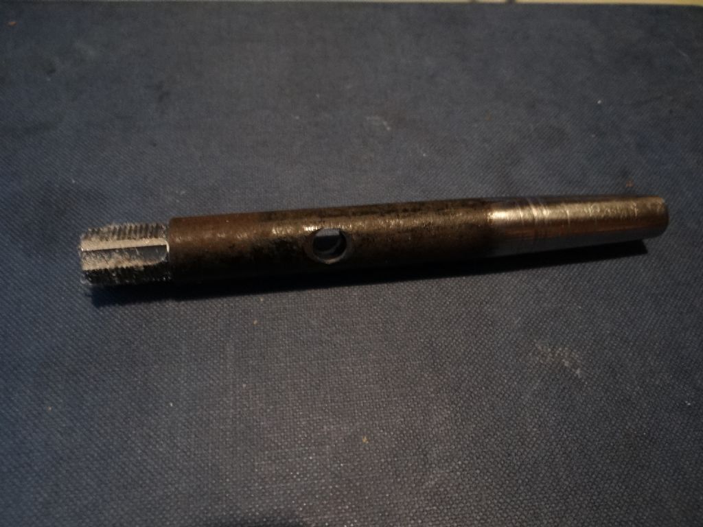

      In another thread I was helped to find some PE-Xb/Al/PE barrier water pipe needed to make a loop antenna. It is a 16mm x 2.0mm plastic pipe with an internal layer of aluminium about 0.3mm thick.

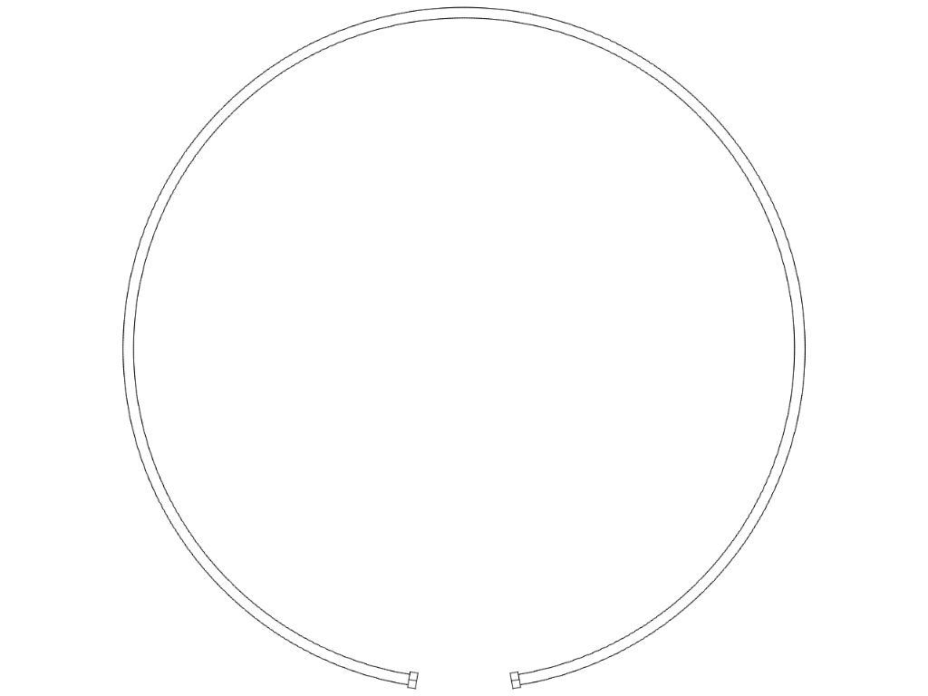

      The antenna loop is about 1m in diameter with a gap at the bottom. At each end, I need to make a very good electrical connection.

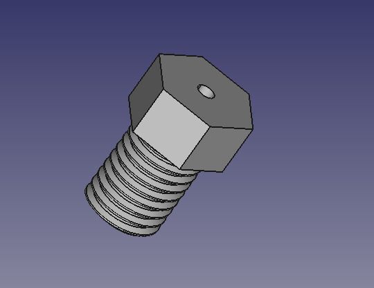

      One way is to hack or burn off the outer layer of plastic and put a clamping bolt through it. Messy. I would like to make a neater and weatherproof job by tapping the inside end of the loop and screwing a purpose made aluminium terminal bolt into the pipe. The terminal bolt will be drilled and tapped to take an M4 brass screw that actually terminates the cable connection:
      I made a special tap to cut the thread into the pipe. The Mark 1 version is made out of yuk steel 1/2" conduit pipe. One end is the tap, the other is tapered to clean up the plastic pipe end after hacksawing. The tap is 1.0 mm pitch.
      In theory the steel tap cuts a thread through the inner plastic pipe and penetrates the aluminium sheath. Then a matching Aluminium terminal can be screwed in to make a good corrosion resistant contact.

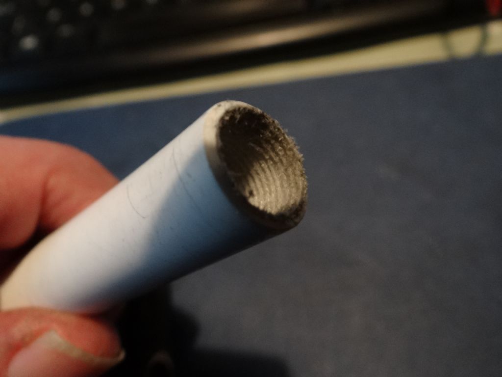

      My problem is that the tap isn't working well enough. Although I get a working thread there is no electrical contact with the Aluminium layer. Not sure why not. Perhaps the plastic tends to deform away from the tap rather than cutting cleanly?
      Having got this far, I admit I don't know what I'm doing. To save me experimenting endlessly with home-made taps can anyone advise on how best to cut threads in plastic that will expose the aluminium layer?

              The tap will need to be very sharp. It might help to put the pipe in the freezer for a while to stiffen it up prior to threading (reduce the tendency to smear around the cutting points).
              Are you using a tapered thread on the plugs?

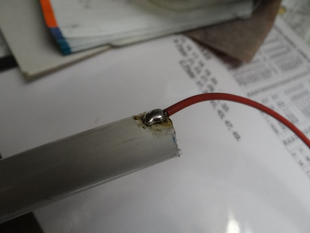

                Soft solder a wire onto the outside.
                Abrade to a shiny finish
                Cover with 3 in 1 oil to stop oxide film forming
                Tin with solder under the oil, scraping with the end of the bit
                Solder wire to tinned patch

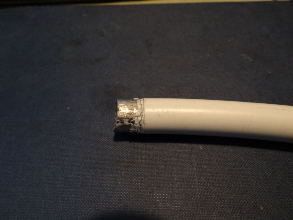

                        Even with carefully sharp taps (these are essential), I found it is necessary to support the pipe with a collar. If not supported the pipe walls expand away as the tap bites. Even with support the tap still didn't cut the plastic inner cleanly and if made big enough would not enter the pipe directly. I dealt with that problem by using two taps, a small one to create a pilot thread followed by a larger to penetrate the Aluminium. Then to get a good contact, the Aluminium plug has to be made slightly larger again and forced in with a spanner. It helps considerably to remove some of the inner plastic with a Dremel.
                        The approach works but it is very hard work, prone to bend and doesn't solve the next-stage issue that brass and aluminium are prone to electrolytic corrosion. Also I wasn't satisfied that the Aluminium inner pipe and plug were making a really good contact. Threading left a lot of plastic smeared over the aluminium inner and electrical contact is only made over parts of the thread. As Aluminium oxidises easily I wasn't confident that the joint would last.
                        Reaming out the inside of the pipe to get a clean electrical contact is possible but it takes ages. I also spoilt a couple of attempts with the Dremel because it removes aluminium faster than plastic when you get to it and the Aluminium barrier is very thin. At this point I decided not to make an expanding plug. I'm certain it would work, but it's more error prone than a screw plug and it would need a permanent collar to stop the flexible pipe creeping off.
                        I left Neil's suggestion till last because I don't like soldering Aluminium foil and feared melting the pipe. Not a problem in practice, Neil's method is straightforward. I exposed an area of Aluminium with a sharp Stanley Knife, cleaned it to bright silver by scraping with the knife edge, applied 3-in-1 oil to stop oxidation, and tinned with a 140W solder gun. I used old-fashioned 60:40 lead electronic solder rather than the modern tin variety. Once the Aluminium is tinned it is easy to solder copper wire to the pipe, job done!
                        No melting to speak of and the brown mess is only cooked 3 in 1 that cleans off. The pipe bends nicely into a perfect loop.
