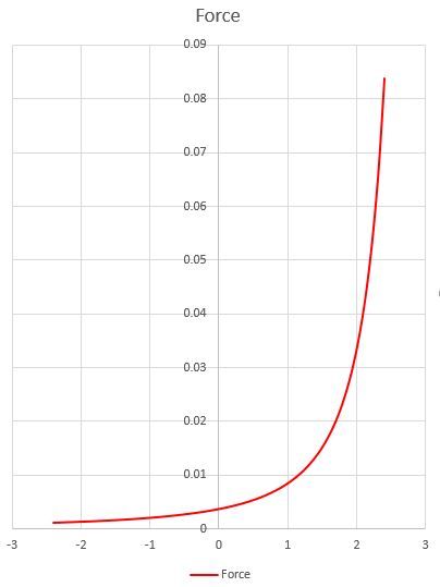

      I am planning to make an electromagnetic mandrel, some yokes (shaped pole pieces) and a pendulum bob from something called black steel in Thailand. This steel is available in large sheets of varying thicknesses and can be plasma cut for pennies.
      The idea is to use an electromagnet to impulse a steel pendulum bob with zero escapement error and the magnetic forces essentially tangential to the arc of the pendulum swing thus keeping g at 9.81 m/s/s.
      My modelling suggests that the location of the centre of impulse from the electromagnet (needed to take the escapement error to zero) is a function of the magnetic permeability of the steel used, hence the query.

                      #306971
                      Colin Whittaker
                        @colinwhittaker20544
                        Martin,
                        The following chart shows how the force in Newtons picks up as the pendulum closes the air gap between the two pole pieces. (The x axis shows the distance between the pole pieces in cms.)force versus swing.jpg
                        Integrating the area under the curve shows that a balance point exists ( y = 0) with equal impulse before and afterwards this point on the x axis. This balance point should correspond to the bottom of the pendulum swing if the escapement error is to be zero.
                        The electromagnet should deliver around 1/3 of the energy in the pendulum with a 12V power drive. This is probably too strong but it will allow the voltage to be lowered or the excitation time shortened,
                        Colin
                        #307051
                        Russell Eberhardt
                          @russelleberhardt48058
                          Posted by Colin Whittaker on 13/07/2017 12:39:48:The electromagnet should deliver around 1/3 of the energy in the pendulum with a 12V power drive. This is probably too strong but it will allow the voltage to be lowered or the excitation time shortened,
                          Yes, much too strong when you consider that the Q-factor of a seconds pendulum is about 10,000. So 1/3 of the energy in the pendulum would only be required every 3,000 or so swings.
                          Russell

                            #307101
                            Colin Whittaker
                              Russel,
                              I plan to drive a counting wheel from the pendulum so I guess the Q will come down a lot. Extracting energy without introducing a pseudo escapement error could be fun but I'm looking closely at the techniques used in MORT.
                              Martin,
                              I can always drop the drive voltage or add a resistance in series with the coil to reduce the impulse. But if the electromagnet pulse is too small it can't easily be boosted.
                              As I don't want to build mutliple iterations of the clock I plan on giving myself a very generous overkill on the impulse.
                              And the good news is with the latest iteration of the magnetic circuit and a few bugs fixed in the spread sheet the balance point is a lot less sensitive to orders of magnitude changed in mu r.
                              Still, at the moment it looks like I have a 1kg copper coil that's over a kilometre long so I may try some shorter versions and only increase the coil size if I can't maintain the oscillations.
                              Cheers all.
