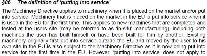

                              I don't know where you get the "put into use" statement from, I can find no reference to it anywhere in the current CE legislation. Are you referring to equipment being put into use after purchase? As I said before purchase is the operative, if you offer for purchase an new item which is covered by CE requirements, in the EEA, it must carry a CE mark, but the onus to assure compliance is on the manufacturer, not on external independant testing, as it used to be in the UK with BSI etc. CE most certainly does not apply to things you make yourself, and then later may offer for sale as a one off used item, be it a model, a mechanism you have built, or a piece of used workshop machinery. Do you really imagine that the vast amount of used engineering and other equipment offered for sale on ebay for instance is all CE approved?
                              I concur with your brother, a fabric aircraft cover does not require CE marking and it would be illegal to put on on them. In fact they need no approval of any kind.
                              Put into use is in MD 1.7.1, 1.7.4, 4.1.3, and The Supply of Machinery (Safety) Regulations 2008v (UK implementation of directive section 3.9 says " A person who is not a responsible person shall not put machinery into service unless it satisfies the applicable essential health and safety requirements and is safe" i.e is CE compliant and section 7 says "
                              (1) No responsible person shall place machinery on the market or put it into service unless it is safe.
                              (2)Before machinery is placed on the market or put into service, the responsible person must— (a)ensure that the applicable essential health and safety requirements are satisfied in respect of it; (b)ensure that the technical file is compiled and made available in accordance with the requirements of Annex VII (Part 7 of Schedule 2), part A;
                              The other directives have similar provisions.

                                  Also from the official MD application guide
                                  The cut of bit refers to used or modified equipment and references guidance on the amount of refubishment or modification that requires compliance.
                                  Pretty clear.
                                  Robert G8RPI.

                                    Robert,
                                    All that's happening here is that people are applying interpretations to regulations about circumstances they were never drafted to deal with.
                                    My I suggest you contact the HSE and ask them what the situation is with regard to hobbyists?
                                    Taking my lead from PUWER I think it's clear these rules apply to the self-employed and also volunteers working in the charge of an organisation, but PUWER says nothing about hobbyists.
