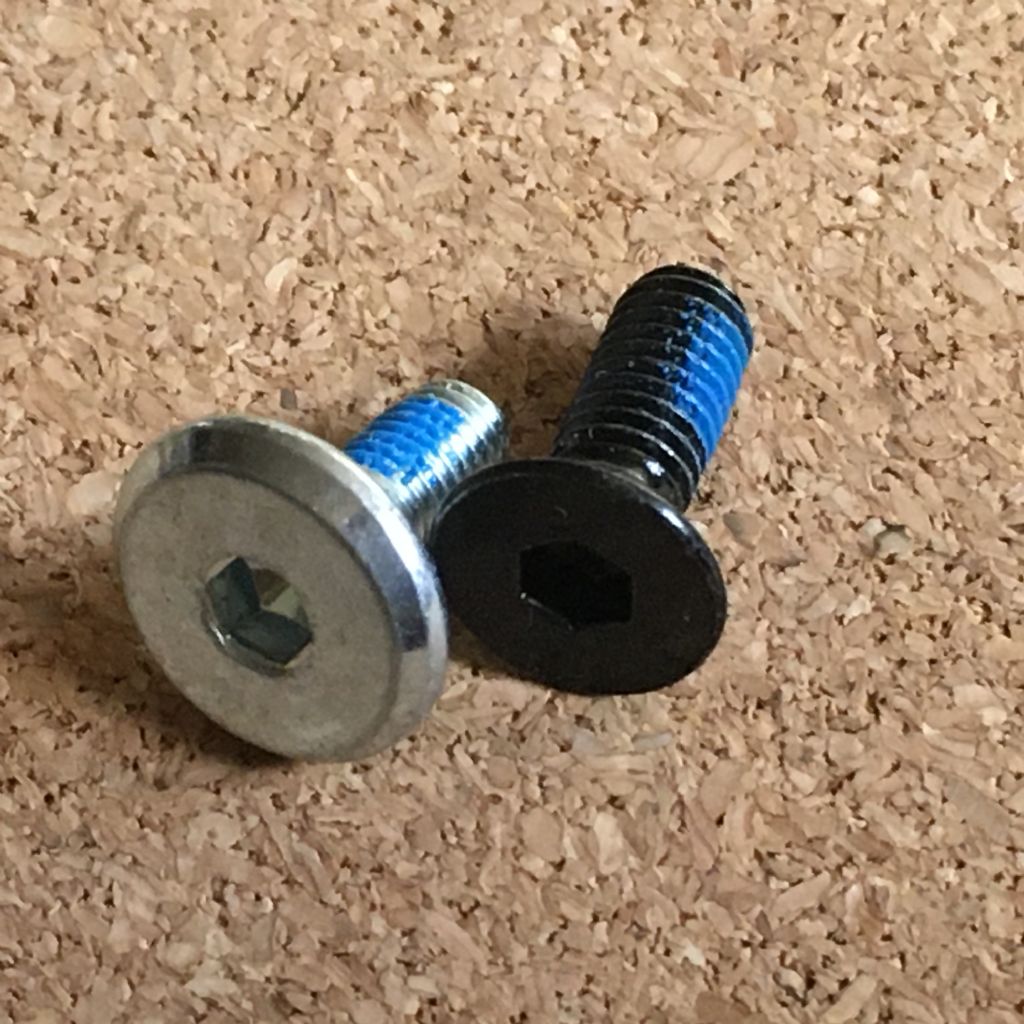

      I would like a 12mm M6 screw, preferably socket head, that is stiff to turn in a normally tapped blind hole. I have seen thread locking screws but not in the size I want. I pondered slitting the screw that then might look like a threaded split pin or perhaps cross drilling and fitting a nylon plug. The screw must not damage the tapped hole.

                    If you can bear it … Pop over to IKEA and have a look in the ‘spares’ rack
                    At Ashton-under-Lyne this is ‘free access’ just after the check-outs smiley
                    They have [or did have] a good assortment of M6 screws with hex socket pan-heads and locking patches.
                    … on the other hand : Life may be too short.

                                    It turns-out that my M6 IKEAscrounge screws are countersunk
                                    … the plated ones with large pan-heads are M5
                                    Apologies for the misleading information blush
                                    … there may be other variants available.

                                                  Here’s some info. about Nylon Patch screws [as per my IKEAscrounge]: **LINK**
                                                  https://www.fastenerdata.co.uk/thread-locking
                                                  Quite a useful device, I think.

                                                      Posted by Michael Gilligan on 02/10/2021 00:18:43:
                                                      That's very interesting, Michael – I'd seen those before but assumed it was some sort of pre-applied Loctite, rather than nylon. Good find, thanks yes
