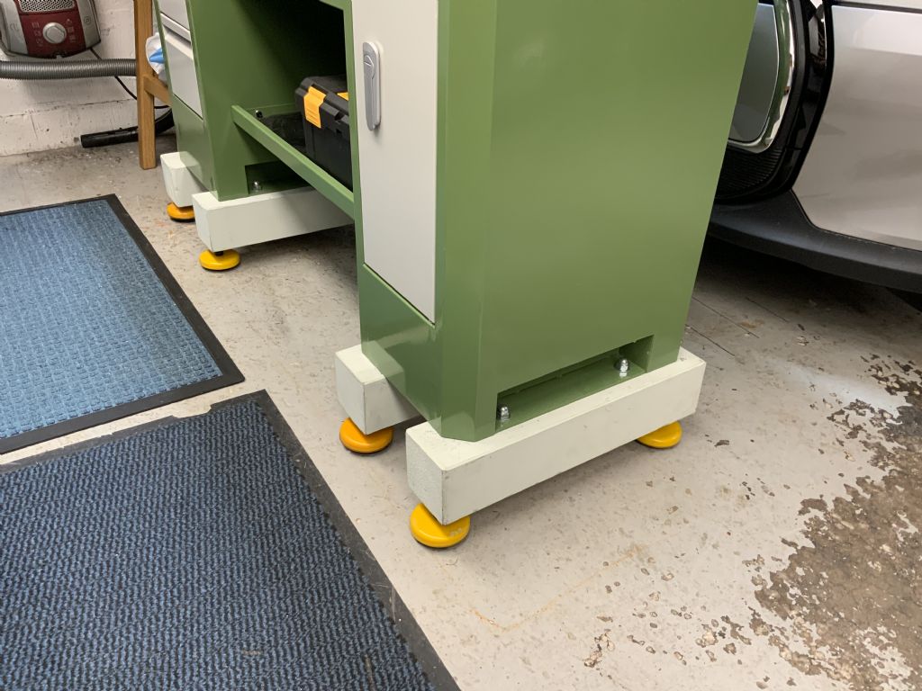

      A bit of advice please on trueing up a lathe. I’ve recently upgraded to a Warco 280V and I need to turn a long shaft as accurately as possible. The Warco test record shows parallelism of spindle centre line to carriage movement in both planes to be 0.02mm at 250mm from the chuck. Turning a 25mm steel test bar held only in the chuck, I’m getting 0.04 at 200mm, so I need to take out some twist in the bed. The lathe is on the Warco stand resting on 4 adjustable pads at each end, (see photo), the question is: how to go about the adjustment? I could shim under the bolts fixing the lathe to the stand, or, more likely, use the adjustable feet, what’s the best way of doing this? Leave the headstock end alone and wind one pair of the tailstock end feet out of the way and adjust with the weight on two feet, or something else. All advice appreciated.Warco WM280V

          Stands are quite flexible so any shimming of adjusting of feet is more likely to move the stand than the stiffer cast lathe bed.
          You would be better using tailstock support for long shafts which is likely to give a different reading to a long bar that possibly deflects when held at one end.
          My 280 has given good service just stood on a wooden floor leveled with a builders spirit level and for that length I would be using the tailstock for support

            I would adjust out the twist by loosening the outermost pairs, using the innermost pairs to make your adjustments then bringing the outermost pairs of feet into contact. You might do the last bit whilst keeping the level at the same end to be sure that you don't impart any unwanted twist.

                In my opinion adjusting the feet will do absolutely nothing. When I got my Warco 290V lathe 3 years ago I packed the stand base so it didn’t wobble on the rough concrete floor and then shimmed the rear tail stock foot area to get the lathe to cut parallel.

                  If twisting the bed to get it to turn parallel, I would shim under the tailstock mounting feet on the lathe bed, not the cabinet base. But the cabinet feet could work too so you could give it a try.

                          IMO adjusting the feet of the stand is unlikely to be very effective in taking any twist out of the bed.
                          My 300Kg monster is mounted on six 1/2 UNF setscrews, with nuts above and below the mounting feet to provide adjustment to remove twist.
                          This is effectively the same means of "levelling" adjustment provided by the Myford riser blocks.

                            Thanks for the advice. I agree that shimming under the lathe bed is probably a waste of time, tightening will just distort the top of the stand, whereas if the stand itself is lowered on one side the lathe bed should settle with it. I have now experimented with this, and although the bed looks massive and the whole thing weighs 210kg, lowering one side does have a measurable effect on parallel between spindle centre line and carriage. The advice to shorten my test bar will be followed, but I don’t think a travelling steady will help as it will just follow any twist in the bed in the same way as the tailstock will, this is why it needs to be turned unsupported. I’ve actually had the lathe for 6 months and it’s had a lot of use, but before machining a long shaft I just wondered what was the best way of actually adjusting the twist back to factory tolerance. Thanks again to all.
