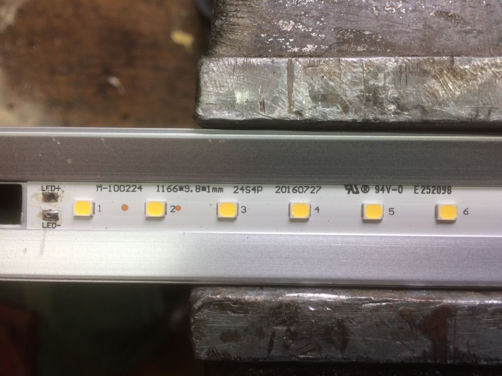

        I was given a 4foot long LED tube light with the replacement starter which is in fact a fuse. The wiring instructions said – remove the starter and replace with the LED fuse (Which is the same shape as a starter). But it hadn't worked for the previous owner, and didn't work for me. No problem, so I took it to pieces and decided it was junk. HOWEVER
        The LED strip is a string of 96 LEDs, I put a voltmeter on the output of the electronic gubbins and got a reading of 1 volt DC (feeding 240v to the supply side of the unit) – re-connected the LCD strip to the 1 volt output, observing polarity etc. So that did not light up the strip of LEDs ! I tried 1.5 volt, then 9 volt and gave up after that.
        Would anyone hazard a guess as to what voltage a strip like that would need? Would the LEDs be driven in parallel or series?
        I ask this before I consign the lot to the bin.

          You should be able to determine how the LEDs are wired by looking at the copper track (outline visible under the paint layer). I would imagine that they are basically wired in series as each LED will have roughly 3 volts across it.
          Why did you decide it was junk?

            Might be a clue to the arrangement in the number '24S4P' printed on the strip. Maybe 4 parallel strings of 24 LEDs
            I'm not familiar with these long arrays in tubes but there will be some current limiting device involved possibly a capacitor

              doesn’t the 24S4P tell you – a string of 24 leds each approx 3V drop across the LED and 4 such groups wired in parallel
              There should be a series resistor or possibly a constant current circuit in each group of 24 – my guess is that each 24 group is expected to work from maybe a 110V circuit – there should be some voltage dropper (capacitor usually) or possibly as the LEDs are unidirectional 2 groups are wired might be wired in series and then the 2nd set of 2 groups wired in reverse polarity.
