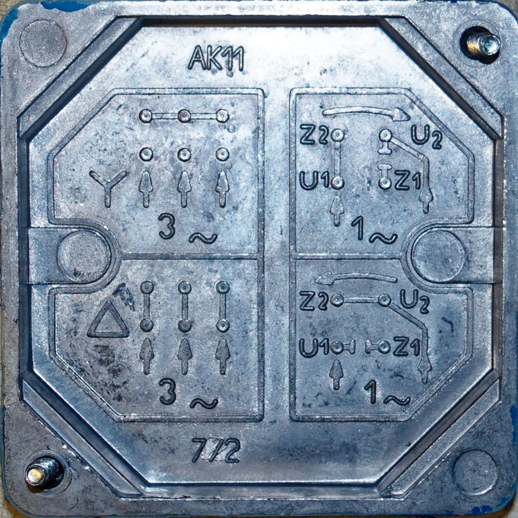

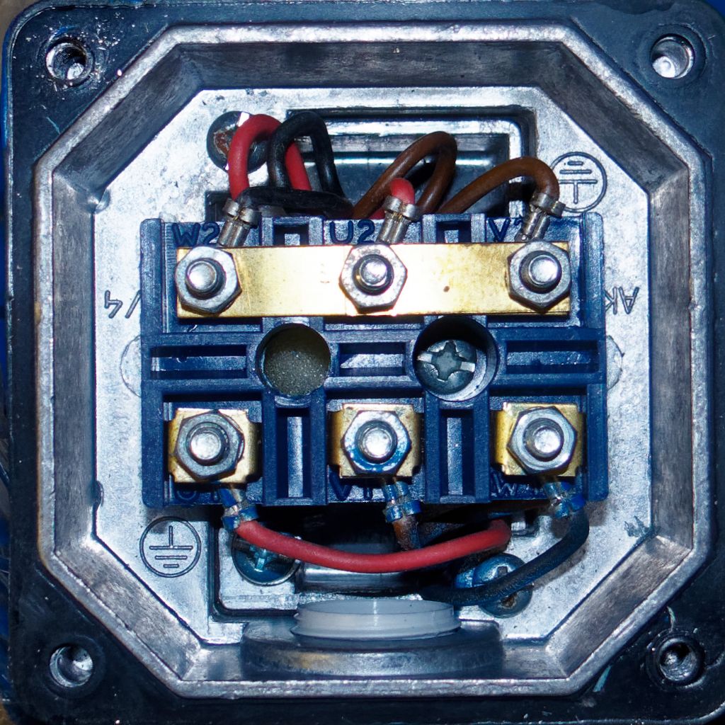

            I've just been out to the workshop and taken the cover off a brand new motor, bought to go on the Dore-Westbury mill; I've not had chance to fit it yet. The photos below show the interior terminal strip and the cover plate which shows where to fit the bus bars for 415v Star configuration, or 240v Delta config. As you can see, it's presently wired for Star, so I'll need to re-jig it for my 240v output inverter.
            In this case, rather than A~B~C the windings are labelled U~V~W. so the following, and my previous diagram may be leading you the wrong way up the garden path.
            The top row of bus bars are configured to give a star point, commoning all the coil-2 terminals together, with 415v 3 phase to each coil-1 terminal.
            They are numbered left to right out of alphabetic sequence W2~U2~V2 but that doesn't matter for Star as they are commoned together. (It's to make it easier to re-config for Delta)
            3 phase motor connection box
            The bottom row are labelled in sequence U1~V1~W1. As you can see, winding U ~ red, V ~ Brown & W ~ Black
            The "1" terminations have even been dabbed with blue paint/lacquer.
            Now for 240v Delta, the bus bars are oriented North/South, as per the diagram in the lid below. (We're only concerned with the left hand two diagrams, as the RH ones are for single phase.)
            3 phase motor connection lid
            Thus the common points are, from Left to Right;
            U1 ~ W2 assuming U=A, V=B & W=C I think this equates to A1 ~ C2
            V1 ~ U2 """"""""""""""""""""""""""""""""""""""""""""""""""""" B1 ~ A2
            W1 ~ V2 """""""""""""""""""""""""""""""""""""""""""""""""""""C1 ~ B2
            Which is what I think my previous diagram shows,
            N.B  I may be in error assuming an A~B~C motor is equivalent to U~V~W one, which I accept may well not be the case.
            Does your cover plate have a similar diagram, if so, make sure you follow that in case AEI use different terminology for their windings; I can't find anything on the net about their config.
            Good Luck
            Bill
            Edited By peak4 on 17/12/2017 21:02:16

                      Phil, Not wishing to fall out with anyone, but the makers of this particular motor (Elektrim SH71-4B) would appear to disagree with you; when the motor is connected for 240v 3 phase running, they show the following, both on the motor itself, and their instruction manual, which can be downloaded from the link above.
                      U1 ~ W2 V1 ~ U2 W1 ~ V2
                      The OP seems to have resolved his issue by fitting an alternative motor now.
                      Obviously I can't say, for certain, that Peter's motor should follow suit, but presumably it says on his motor cover plate.
                      Regards
                      Bill
                      p.s. looks like we were typing at the same time, but I took longer sorting out the relevant link.
                      Edited By peak4 on 18/12/2017 22:01:54
