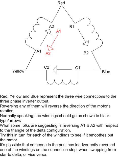

        Hi all
        For info the windings have letters and numbers on each. I have connected
        B2 to C1,
        A2 to B1 and
        A1 to C2.
        Each of the inverter utput wires connects to each of these pairs. Does this appear to be correct?
        Thanks Peter.
        #332092
        Mike Poole
          @mikepoole82104
          That is what I would have done. The acid test is does it run smoothly? If not then it won't take long to swap each coil round one at a time and see if it makes a difference or you could run through the process linked to in a previous post. Most inverters will not need too many parameters to be set from the out of the box setup just to run the motor.
          Mike

            #332105
            peak4
              @peak4
              Peter, before I read your last post, I've tried to answer that one in a PM. The suggestion isn't to swap the supply wires round, rather swapping the orientation of one of the sets of windings which form one side of the triangle of windings in delta configuration.
              Bill
              #332107
              peak4
                @peak4
                I hope this copies OK and explains the thoughts of some on here.
                3 phase diagram
                #332129
                Mike Poole
                  @mikepoole82104
                  Very well explained Bill, I think this has to be tried as it at least needs to be ruled out of the possibilities.
                  Mike

                  Peter Smith 25
                    @petersmith25
                    Hi All
                    Thanks to Mike and Peak4, very well explained.
                    I've just come out of the garage after working in the base of the lathe changing around the wiring as suggested.
                    On each of the winding wire changes the motor ran much slower, rougher and grumbled as if it had a knackered gearbox.
                    So I think the wiring was originally correct. As you can imaging after all i have done to this lathe, i think i would be better off sat in the pub with a glass of real ale!
                    I'll now have the day off it and i think change the motor which brings me back to, do you think 1 and a 1/2 hp motor is adequate for the lathe and if not what would you fit.
                    Thanks again for your help, and have a good weekend
                    Peter
                    Edited By Peter Smith 25 on 15/12/2017 10:57:40
