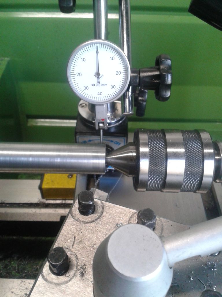

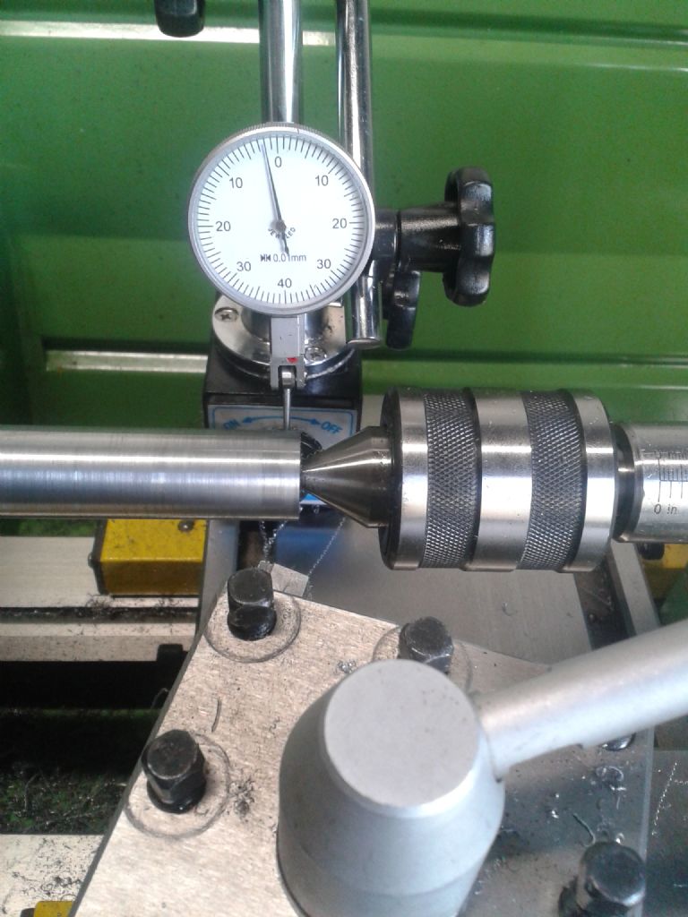

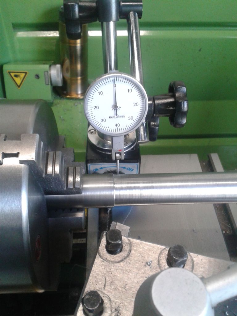

          This morning I had a go turning another test piece from the mild steel I bought yesterday. Turned a 1" O/D piece over 150mm. First off I turned 2" from one end to remove the black scale and turned it around in the chuck to have a proper seating, then I tried to machine the rest of the bar (about 150mm) but it chattered badly, even with a light cut, had no such issues with aluminium.
          Probably aluminium being soft complies with the tool and shears without deflecting much, steel being harder deflects, or so it seems to me….
          Anyway I supported the free end with a revolving centre and took multiple cuts, the results are the same as those I had with aluminium, or a bit better difference of about 0.01 – 0.005mm over 150mm, not bad I guess.
          The only issue I'm noticing is that when I tighten the tailstock barrel lock, the test piece deflects and then when I machined it I got a taper (0.05mm difference wider at the chuck end) If I just snug the lock it will be fine.

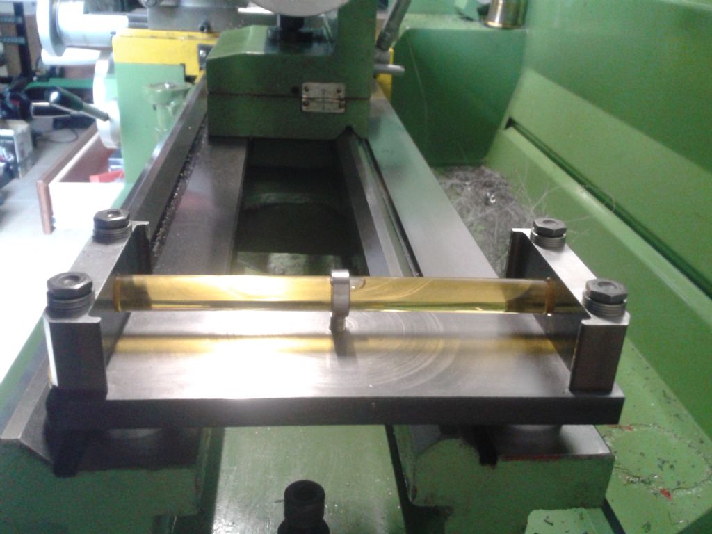

          Also, checked the bed for level, the twist it originally had is much reduced now, initially the level was reading out of scale in opposite directions, now it's still reading some twist but much reduced (a normal spirit level will read the same at both ends)
          Chuck side reading close to 0 after test cut
          Tailstock side reading 0 after test cut
          Deflection when tightening the tailstock barrel lock, get greater the more I tighten up to 0.05mm max
          Level at tailstock end
          Level at chuck end, a bit off but I think it's good enough, it starts to get tricky to get the bubble centered at both ends!

            If you're measuring the work "diameter" variation by running a DTI along the work then all bets are off. You need to measure the diameter with a micrometer to get a proper picture.

                Posted by Andrew Johnston on 11/11/2017 10:15:31:
                Andrew

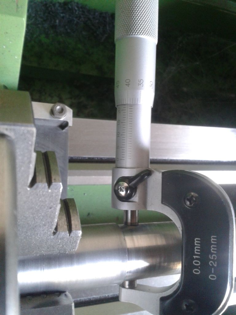

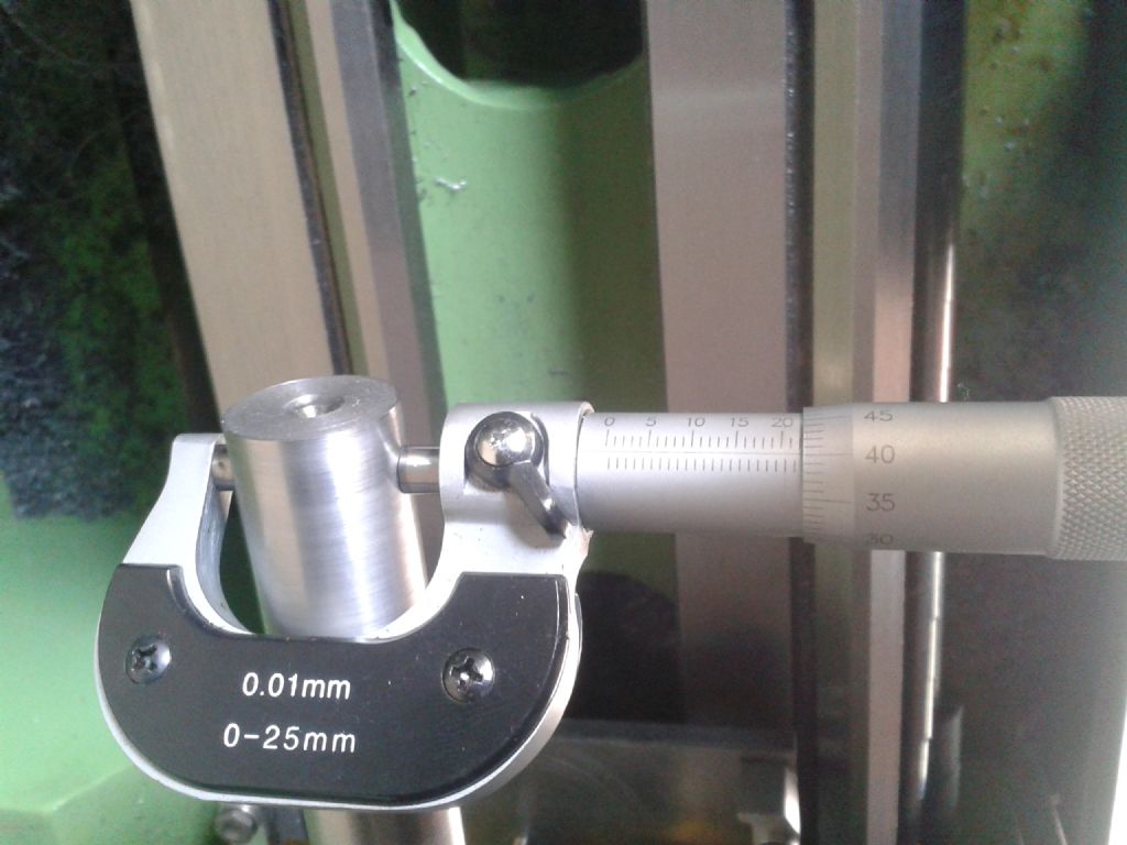

                          The diameter is the same at both ends according to the micrometer, I get what you mean, re dia measuring by dti, as it will follow the taper if there is one.
                          The tool I'm using is HSS one of the ready made ones from chronos, I just rounded off the edge. I checked the headstock with a dti on the spindle nose and face and every thing looks fine.
                          When I turned a couple of inches unsupported it did not chatter at all, only when I put 6" unsupported did it chatter. Probably should have turned a shorter test bar.

                            Chris
                            Not meant to be a criticism, but if that micrometer is sitting there unsupported (even if it is resting on the frame), then you probably have it cranked up way too tight. It is a micrometer, not a G clamp.
                            I can also say, having levelled my machines with a proper Rabone Chesterman machine level, it is astonishing how much a fraction turn of a bed adjusting screw can deflect the bubble.
                            If I wanted an indicative readout from a machine level, I would only use a proper machine level, not a home made one. A normal spirit level won't give the readings you want either, as you have discovered.
                            The fact that you have already detected twist in the bed suggests you should be absolutely sure you have removed all this first, BEFORE attempting any test cutting.

                              It's ok David, I'm holding it by the ratchet (tried to leave my fingers out of the picture as I didn't do nail polish!) I'm sure it wasn't tight.
                              A proper engineer's level is not an option, don't have one and I'd rather spend the money on other tools which I really need. I one I mocked up is by no means anywhere near a proper level, but it gives a far better picture than a normal level and allows for some adjustment to be made, where as with a normal level I was blind.
                              To be honest I'm pretty much almost satisfied the way it's running now, it's turning a set diameter over a length with no significant taper. The thing which is bothering me is the tailstock deflecting the work when tightening the spindle/barrel lock.

                                    "Levelling the lathe" (with a capital L) refers not just to getting it level from headstock to tailstock, indeed, that is the least important, though obviously it should be as "level" as possible. The main one is fore and aft, which should be the same at both ends of the bed, hence the "twisting" scenario to make it so.
                                    I think you should be able to see that, if the headstock casting is truly immovable, then if the tailstock bolts were pulling that end into the bench as the wood squashes, the the bed would deflect downwards at that end. Obviously a similar scenario if you put a couple of washers under the tail end of the bed before tightening down the headstock, then the tail end of the bed would deflect upwards, with respect to the headstock.
                                    I'm assuming that since you have neither a calibrated test bar or precision level, you will need to sort it out by turning and measuring.
                                    I'd suggest making sure that in your case the "level" between head and tailstock in neutral, and that any differential shimming only adds a twisting, rather than a bending moment as well, in order to keep the vertical alignment correct.

                                        I suspect the change of alignment when the tailstock barrel is locked is down to the locking mechanism. A simple clamp on the barrel will inevitably move it slightly when tightened. Larger industrial lathes sometimes use two curved pads opposing each other so, in theory, the barrel doesn't move when clamped.
