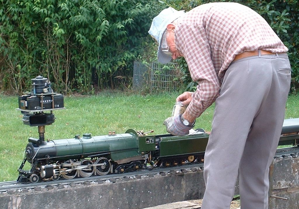

                          One of the chaps in the 2½" gauge Association made a 2½" gauge Josie by doubling up the dimensions. It makes a nice loco.
                          #179563

                            GLR still seem to be alive – now trading as GLR Kennions Ltd, – and they have several Josie castings advertised on their website, as well as some suitable wheels. I have them bookmarked for when I start my Josie
                            John, really like the pic of the 2-1/2" Josie.
