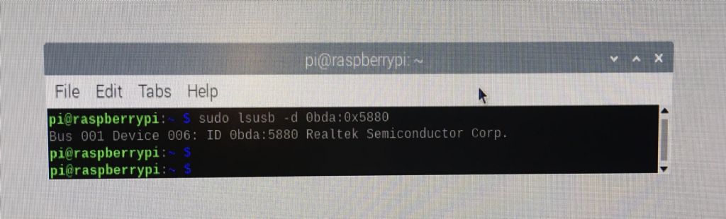

                              [ UPDATE ]
                              We have something approximating progress yes
                              I have fired-up sudo lsusb –verbose on the RasPi_4 and it gives me masses of information … most of which I don’t understand.
                              Any advice regarding what to look-for would be welcome.

                                        In hexadecimal Vendor_ID3034 seems to be 0BDA and the Product_ID22656 is 0x5880.
                                        The Vendor_ID points to Realtek, no luck with the product ID.
                                        Dick.
                                        #620805
                                          That seems to be the case, Dick
                                          … or have l got the syntax wrong ?
                                          #620808
                                          Dick H

                                              Google Realtek 5880 uvc. Seems to fit.
                                              #620810
                                              Dick H
                                                @dickh
                                                Or Google USBVID_0BDA&PID_5880.
                                                #620813
                                                  That all seems to make sense, Dick
                                                  I can happily accept that the controller [if that’s the right word] is a Realtek device
