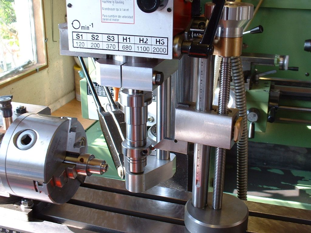

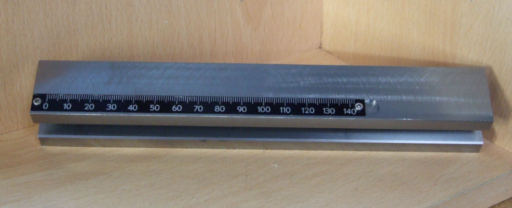

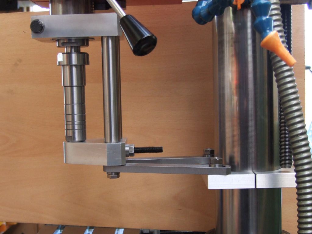

              #417169
              Graham Meek
                @grahammeek88282
                Posted by iNf on 02/07/2019 21:58:31:
                It looks like a game of 'snap' with regards to your milling machine. Your mill is the 1st one I've seen identical to mine, see this previous thread Link
                The symptoms you describe are exactly the same as my machine and I get around it by drilling a hole 1st as described by others. Also in another of your threads you made a new oil lift screw and mine also broke! My solution wasn't as elegant as yours, I just drilled and tapped the end for a cap screw and cross drilled the end and attached to the motor with a split pin.
                Hi Dave,
                The Over arm support is used mainly for gear cutting, the additional support improves the finish.
                I have also added an bracing system when using very large DP or Module cutters.
                fig8 showing over-arm slewed around such that the flat on the lower bearing support is parallel to the y axis.jpg
                Lastly the Y-Axis stops are another of my designs,and are not fitted to the machine as standard.

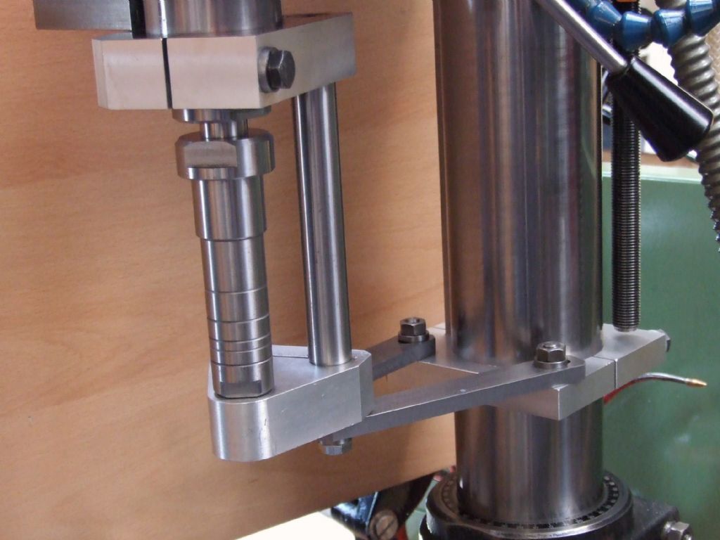

                #417179
                AdrianR
                  @adrianr18614
                  Gray,
                  In your first picture, is that a quill lock?
                  Trying to get to the bottom of why the ZX-16 is more flexible and looking at your pictures, I am getting the feeling the column may be a larger diameter than the ZX-16, I have measured mine at 3". What is it on the FB2
                  Thanks
                  Adrian
                  #417213
                  Graham Meek
                    @grahammeek88282
                    Hi Adrian,
                    Yes the first picture is a quill lock. What a lot of Emco owners do not realise is that there is a Tufnol gear in the input train from the motor to the gearbox. These have been broken in the past where owners use bottom gear to lock the quill.
                    This little unit ensures there is no strain through the gearbox.
                    My column is 78 mm diameter. One of the posts above mentioned checking the condition of the slides on the table. I once had a problem with the finish on the end of any bar when cleaning up the face with the side of an end mill or slot drill. Of course initial thoughts turn to play in the spindle, but as this was ruled out I looked at the slides. Sure enough both were a little on the loose side.
                    Tightening the slides made a world of difference, but, and it is a big BUT do not over do the tightening. To adjust any slide way you need to take off the feedscrew and push the slide by hand. If it is that tight, that you cannot then this will cause premature wear. The only correct way to adjust the head to column slide is with the head off and feedscrew removed. The Gib strip on the guide key wants to be loose so that you can set the adjustable clamping bolts to get the slideway sorted, once these are set then adjust the Gib.
                    Get this wrong and you can get to a stage where the slide will stick, then suddenly drop to take up the play in the feedscrew.
